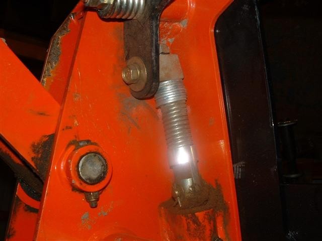

Mine haven't come off, but they sure looked like they could come off during an inoppurtune moment, so I welded on two small rectangular pieces of steel onto the bottom of the QA where the pins engage just to prevent such a thing from occuring

I will take a picture tonight when I get home and post it showing the poor man's fix for the quick attach popping off.

Here is a picture of the 9 flat washers that I had to stack on top of the spring on my quick attach to keep the bucket from popping off.
