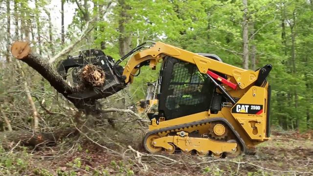

OP,
Some pictures would help. We don't know what the actual work entails. Are all the trees already down? How big are they? Lots of bushes and brush? How tall?
I've "cleared" brush with just a 3pt brush hog and the bucket on the FEL for pushing over SMALL trees. Worked fine. If the brush is small enough you can drive over it (I've driven over brush 6 feet high), the brush hog will cut them. Sometimes you can cut down thicker stuff by backing the brush hog over them. If it's chainsaws to cut down trees, then a grapple to move them once they are "bite sized" enough for your FEL. If you can't burn, then a chipper (could rent one once you have everything down and stacked ready to go).
You can clear a lot of land with just one guy, a hand shovel, a hand axe and a wheel barrow. It will just take much longer to do. So, how fast you need it done will drive what tools you need to make it fast. A large dozer, a big excavator and a motor-grader will be the fastest. Along with a large wheel loader with grapple dumping into 18 wheelers with end dump trailers hauling off site to the landfill. But this will cost the most. Like much in life speed takes $.
A CUT with a few attachments will do it all. But it will take much longer, and likely require more manual labor then the high dollar solution above.

Just hire a forestry mulcher, everything will be ground to paste in a day.
then use your compact to clean up after.

3 yrs experiance but for the seat riders only this would be my thoughts.
Small brush - use a regular mower you don't mind scratching a little
large brush - brush hog,
Rocks and small trees - FEL with bucket/grapple
large trees - FEL with Forks and chainsaw to log / notch
brush piles - FEL w/ forks/grapple
Roots - 3P tiller or subsoiler
level dirt - weighted back blade
Thoughts?

Probably going to have to drop any dead snags and chop up anything on ground to a size the will fit in FEL, tractor with FEL is good for moving things, just not what a bulldozer will do for you.... IF it requires bulldozer work hire it out... Probably a one time expense.... IN last few years have had snow and mono winds bring down several large trees, and if its to big to fit in FET bucket its not going to move.... Chain saw is going to be your new best friend if you can not hire a bulldozer...Most land clearance contractors in my area use a crew to reducer size of material and skid steers with front grapples to move stuff....
