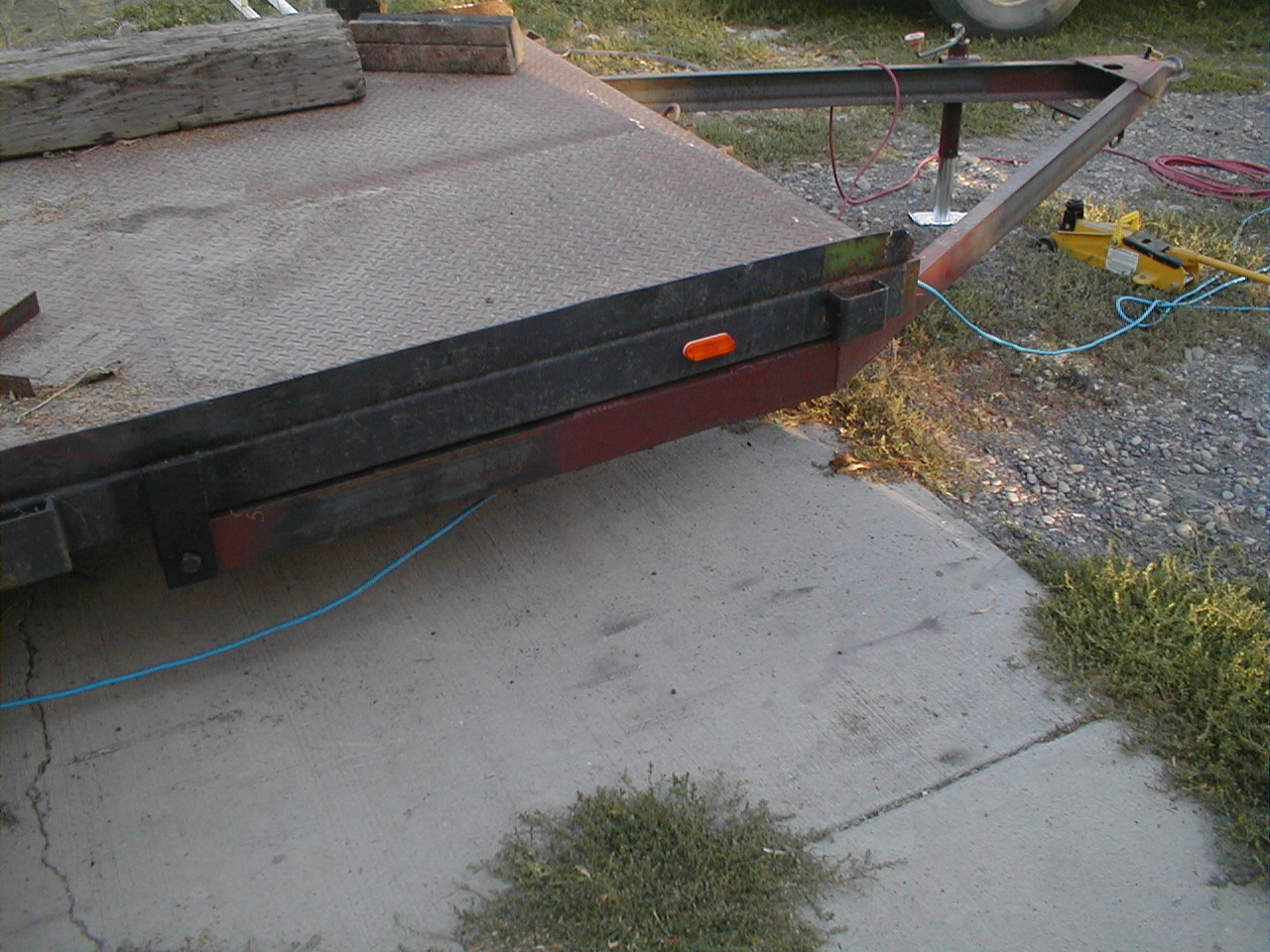

More small steps. I got the front marker lights mounted (Pic 1) and began the wiring process (Pic 2). My wife helped me last night to do the wiring. The extra set of hands really helped. Right now she's chasing parts (mounting loops) while I post pictures on TBN.
I didn't make any progress today because I spent the day on a trail ride up Conant Creek with my Dad and brother, my daughter, and an old high school buddy and his family. Well worth putting off completeing the trailer. The last two pics are some scenery from the trail ride.
Hopefully I can get more done tonight.

I have all the lights installed and tested. I tested the brakes, too, by spinning the wheel by hand and applying voltage with a battery charger. Everything works great!! I still need to wire the actual plug, but I'd rather do that in the daylight.
One question for the gurus out there...How many holes should a typical tap cut? I've been clipping the wires to the trailer frame with brackets. I hold the brackets on with a 10-24 bolt into a hole that I've drilled and tapped. All was well until I tried to tap holes in the metal on the tongue. I busted two taps. Same tap; same drill bit. The tongue is new metal from a steel yard, so it's not crazy stuff like bed rails or anything.
What has me baffled is that the tap worked great on the trailer frame.
After this I need to paint and install the fenders, install the wiring plug, and install the tilt latch. I need to get this trailer done soon because I have 7 ton of hay to bring home.
