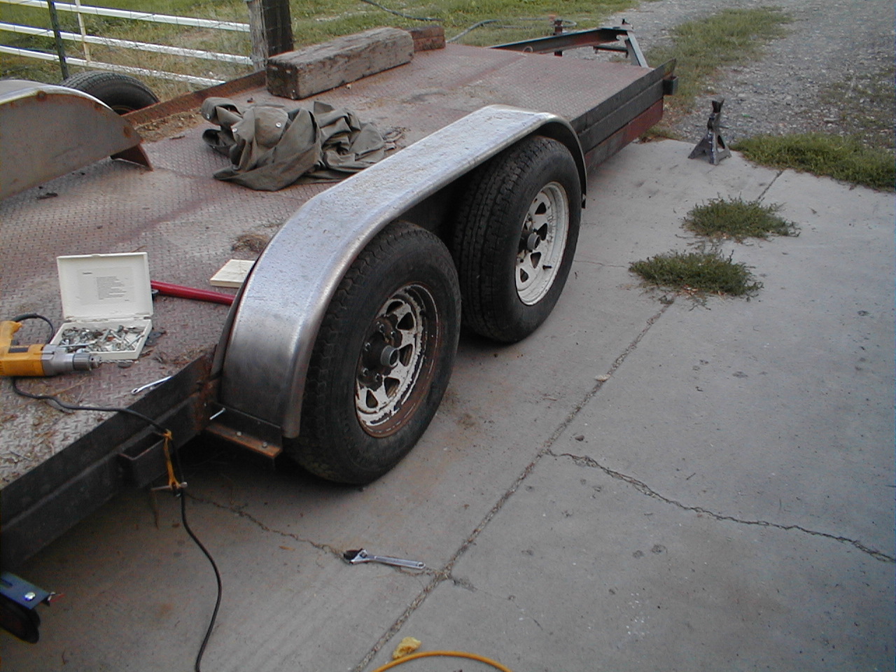

Any suggestions on how to mount a brace of some sort in between the two tires to strengthen the fenders? I have a few ideas, but they all become complicated when I try to make the fenders removable.
What about welding a gusset to the inside of the fender?

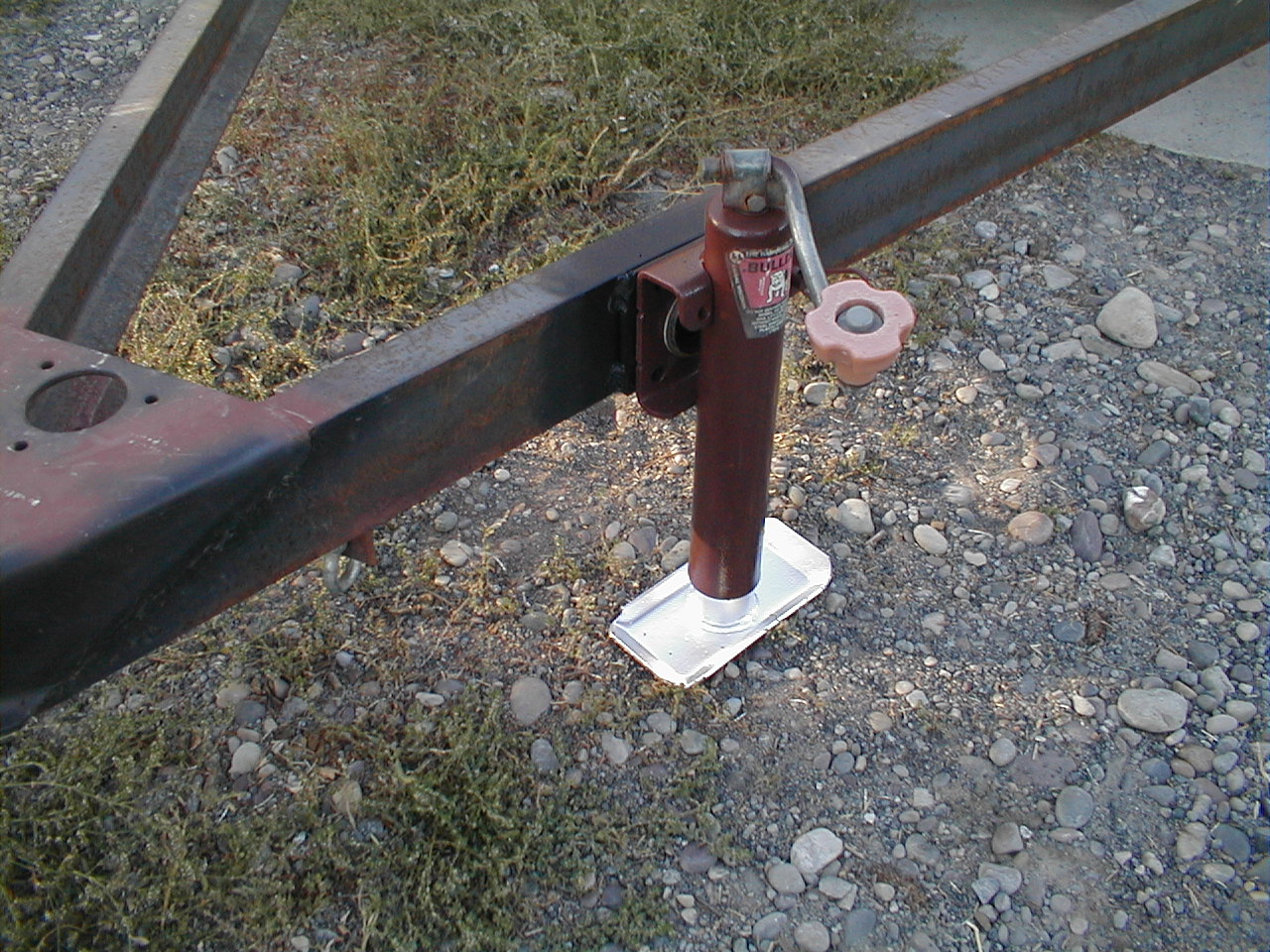

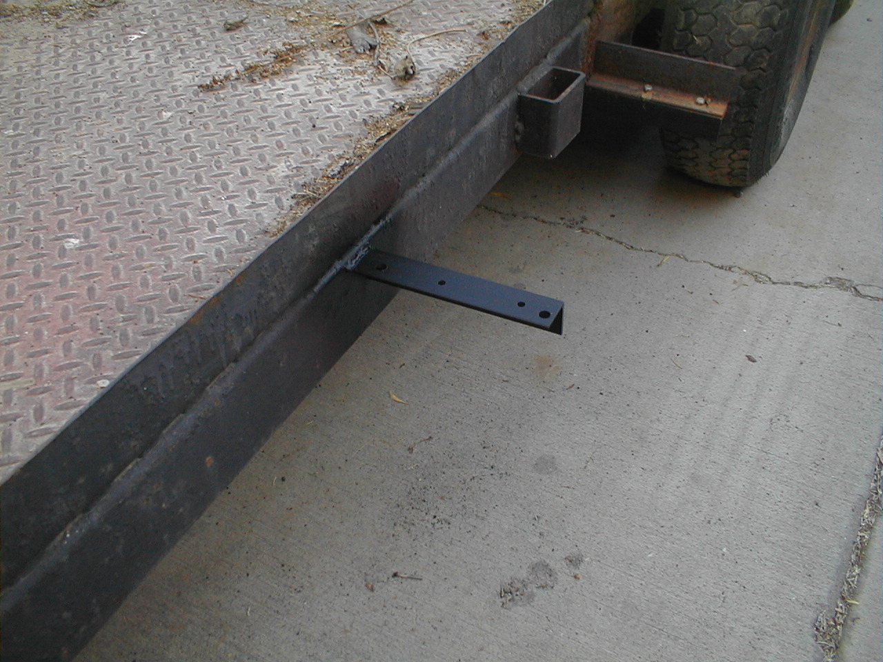

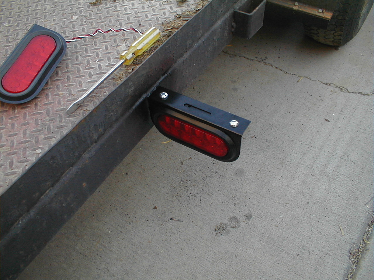

I got the jack installed on the tongue. I went ahead and painted the old one rather than getting new. With the money I saved I splurged on LED grommet lights. I welded the brackets on tonight.

1) The newly painted jack (I covered over the label with tape when I painted the jack).
2) The light mounting bracket I fabbed and attached last night.
3) The LED grommet light attached to the light bracket (My lights are probably worth more than the rest of the trailer.)
4) The fender that I mounted tonight. Once I get the holes all drilled, etc. on both fenders, I'm going to take them back off for prep and paint.
