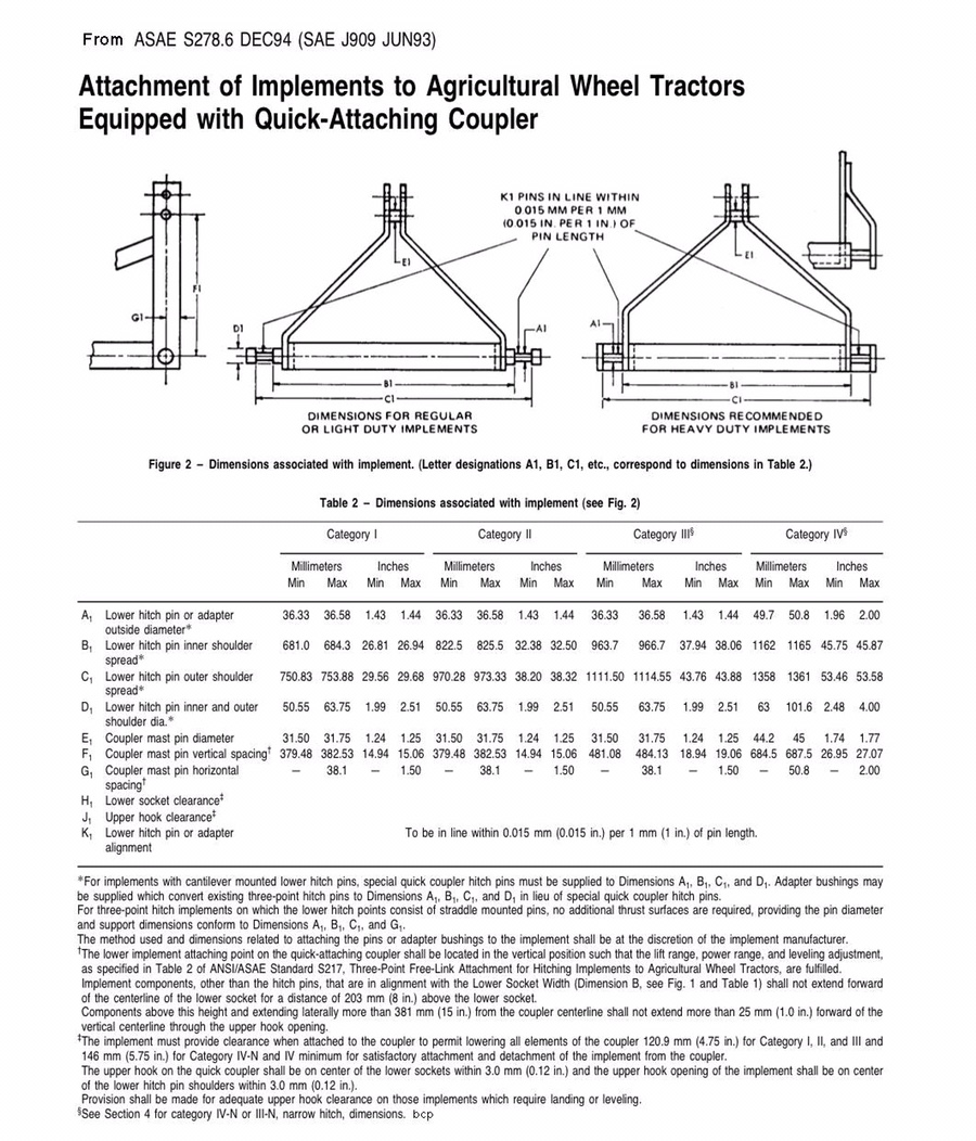

What I'm finding in a couple brands are the 7 footers are built quite a bit heavier. I found a place selling DHR 7 footers here somewhat local and it's definitely heavier than their 6 foot model. It has a CAT 2 hitch. What's the difference. I'm going to try to figure out what my Kioti DK5010 has and see if it will fit

thanks, I watched the video. Can I use a Cat 2 box blade just with different pins? I'm finding it all a bit frustrating. I read and read I need a heavy box blade. Then I try to move up to a seven foot because they definitely are built heavier and get close the 100 pounds per foot category, but then it is CAT 2. Lot's of box blades in CAT 1 available locally but all no where near the 100 pounds per foot guideline

Few standard Box Blades suitable for your Kioti DK5010 will achieve 100 pounds per foot of width.
Everything attachments and Dirt Dog brand make heavy standard Box Blades in Category 1.
For 110+ pounds per foot in Box Blades suitable for your Kioti DK50120 you need to go to a Rollover Box Blade rather than a standard Box Blade. ROBBs often achieve 120 pounds per foot of width.:
LINK: Dirt Dog Manufacturing >> Box Blades

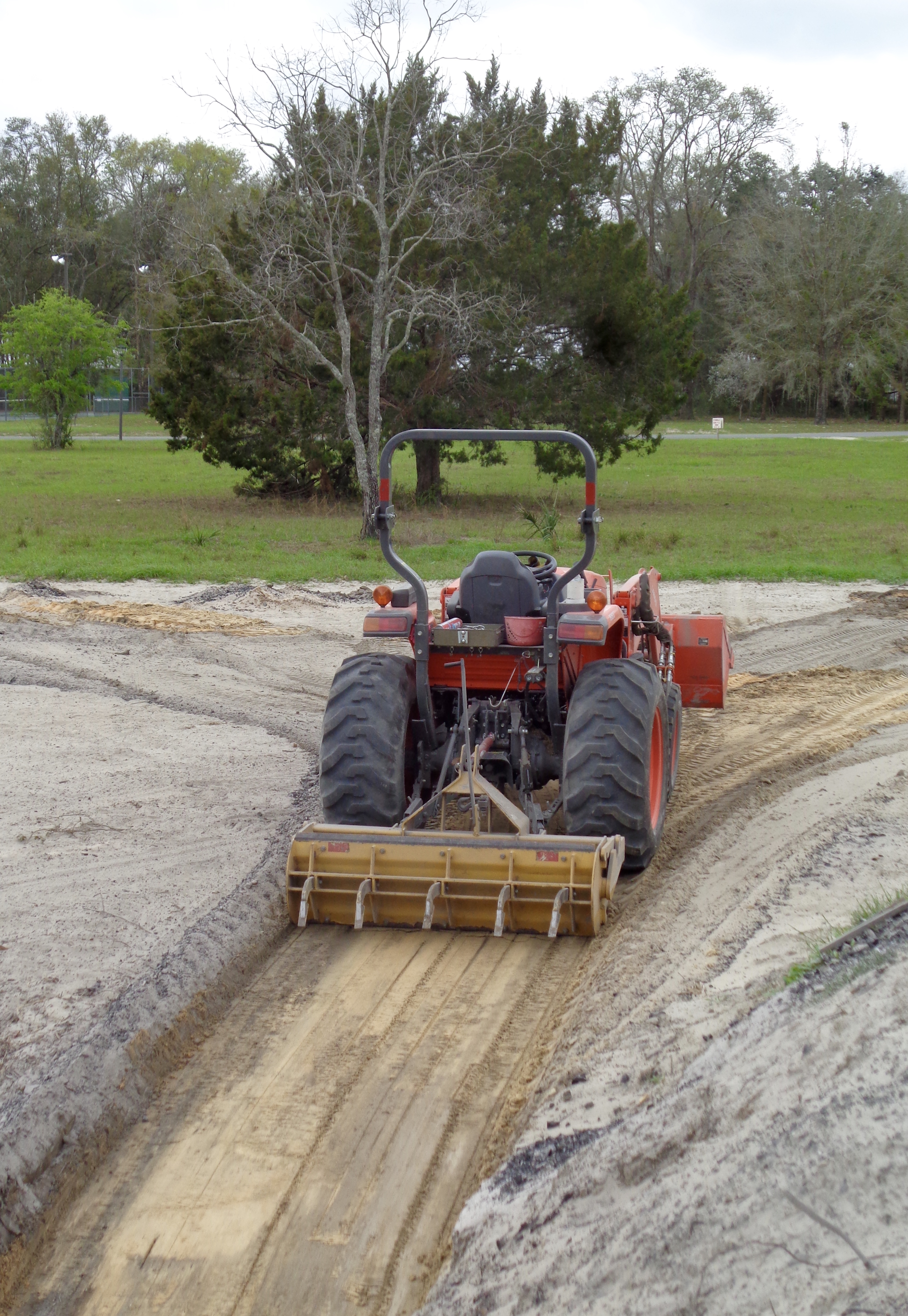

Do not buy any Box Blade more than 12" wider than your tire spread, six inches wider than tire on each side. Total weight is not important. What is important is weight per unit of width.
A Box Blade only as wide as your tire spread will do fine. Box Blades move around as you pass through dirt, no matter how tight stabilizers are adjusted. I leave a little slack in my stabilizers. My tire spread is 62". My Bush Hog brand Rollover Box Blade has a working width of 60"
((Note that King Kutter makes implements in both "standard" and "professional" grades, with professional models heavier.))
What is it you need to accomplish? Residential work? Pasture smoothing? Thirty hours of potential BB work or 300 hours of potential BB work?
Your opening post should have related more comprehensive information.

If you check out a few of the heavier blades, you'll find that SOME are cat 1 OR cat 2 - toplink height usually isn't a problem (assuming that mfg actually KNOWS what the QH specs are) - but the heavier blades are easy to spot whether they're both categories or not -
Instead of TWO ears on either side (for a decent one anyway) they will have THREE ears each side - you put your lift pins either inward (using the inner ear and the CENTER one) or you put them OUTWARD (using the center ear and the OUTER one) - this gives you the 5+ inches of WIDTH difference in the two hitch categories.
Again, if you don't think you'll EVER use the box blade for much of anything other than MAINTENANCE of a driveway, almost ANY model that covers your tire tracks should do. The OTHER side of THAT coin? One of the heavy built blades will likely have a better resale value if you decide it's too much for your needs... Steve
