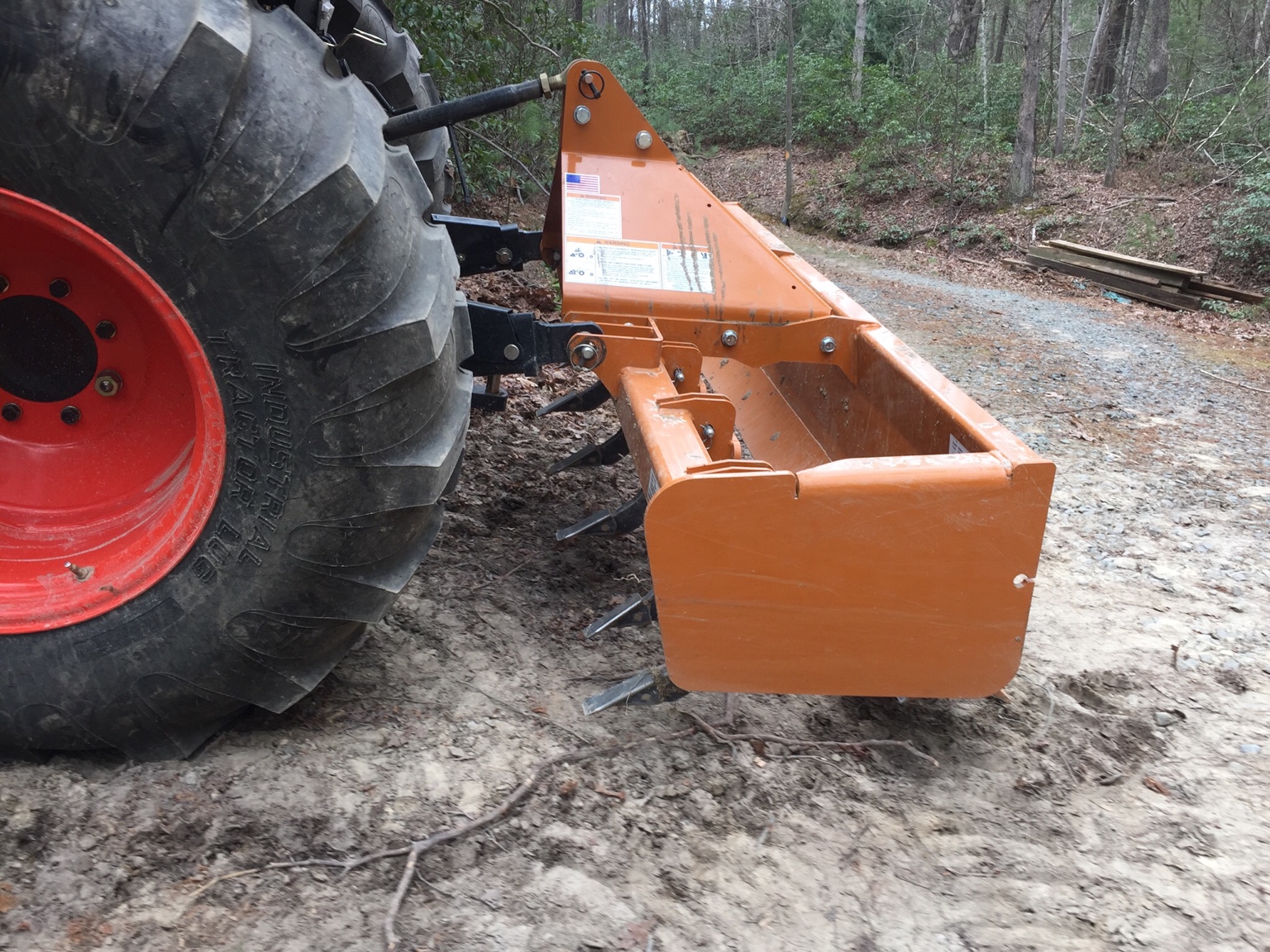

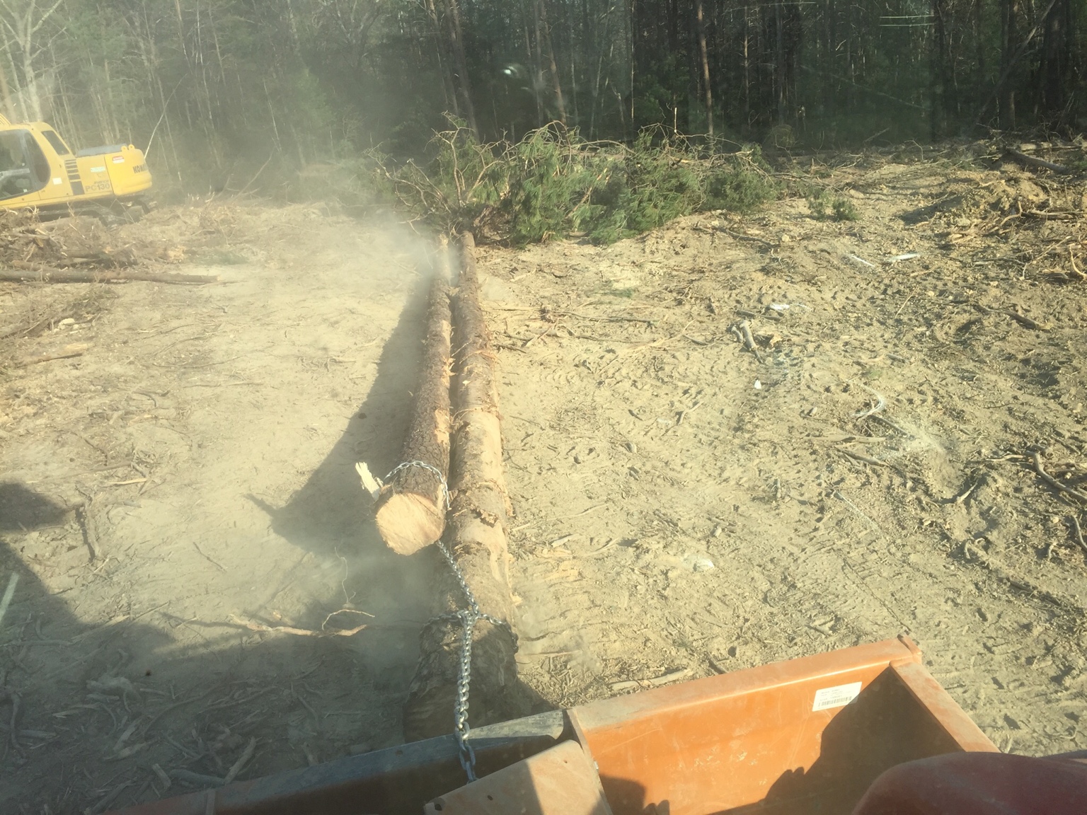

We bought a Woods when We bought the tractor. 84 inches. Approximately 880 lbs. i was worried that it wasn’t heavy enough. My tractor dealer assured me that it was. It is quite solid and has stood up to some rough use. I’ve built my own roads and smoothed out some rough fields. We wrapped logging chain on the box blade and used it to haul out hundreds of large trees when clearing land for our orchard.

I believe this was rated by Woods as medium duty. My wife operates the tractor/ boxblade combo like the getaway driver for a bank heist. She has twisted some scarifiers into artwork but has not hurt the boxblade.
