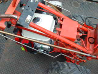

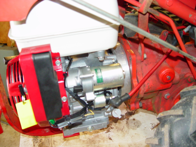

   / What can an old 2 wheeler do? #20
Hi guys
Just finished Repower a 5665 2 wheel 12 hp Kohler Replaced witha 13 Hp Honda GX390 the shalf 1 X 3.31/64 long by Northern Specs.
I had to make a spacer, But still used the Kohler adapter.
Also made a spacer to between the gear and motor .
If any one wants I can get More spacers maded. Thanks Bruce
