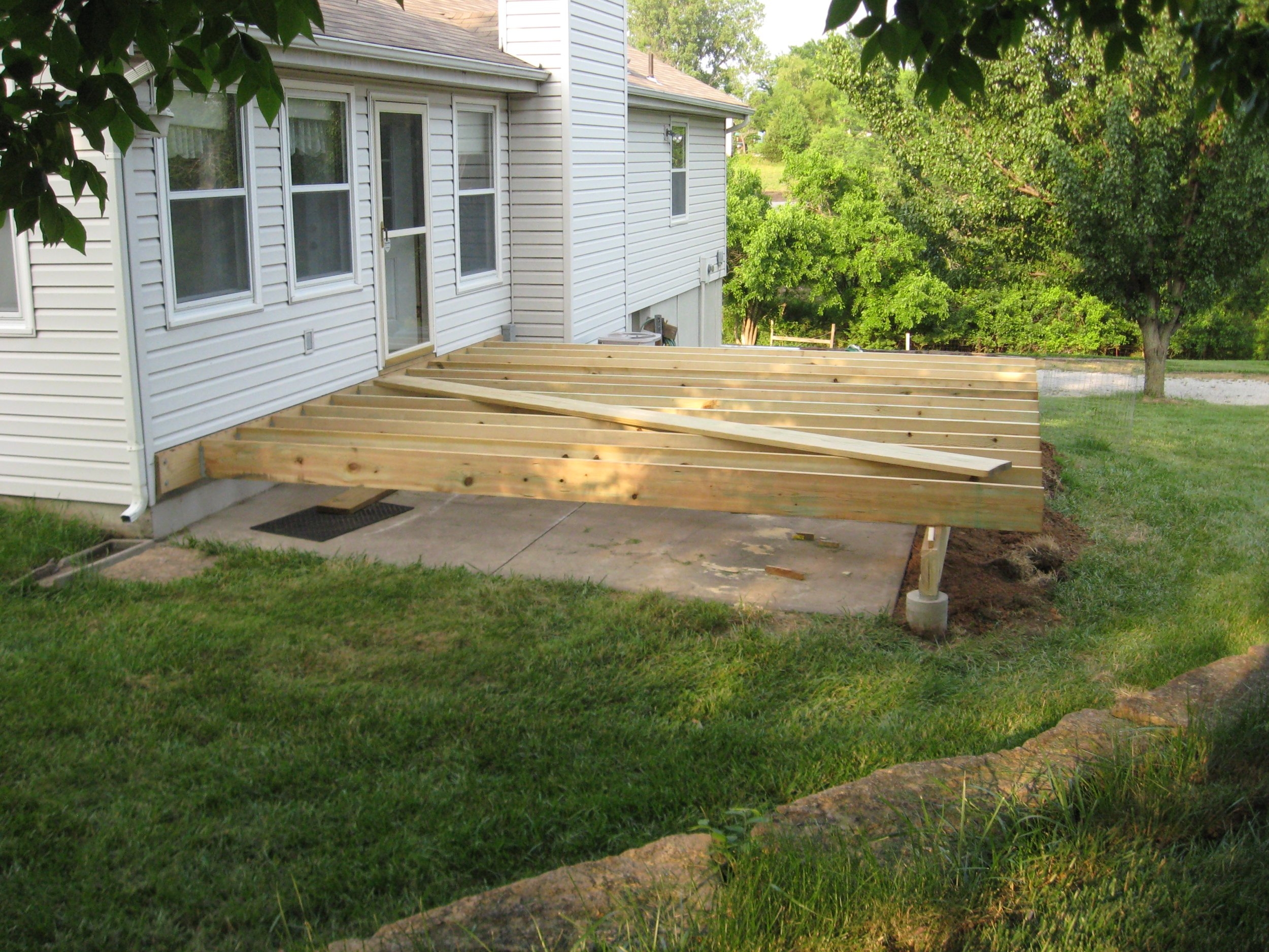

Have you ever considered extending your concrete deck towards the slope and building a retaining wall? You could have a nice raised garden or a flower bed on the edge of the retaining wall and you'd have enough area or a table and chairs. Just a thought vs spending money on something that might rot away again in a few years. The trade off would be that you once again have steps in a awkward place because the door placement isn't ideal for that deck. Just my thoughts.
   / What Caused This Wood Deck Failure? #95
I would have thought the concrete slab underneath would be somewhat of a moisture barrier?
With a layer of visqueen underneath it might be. It is amazing how much moisture can surface on concrete especially when it warms up - even with a layer of visqueen

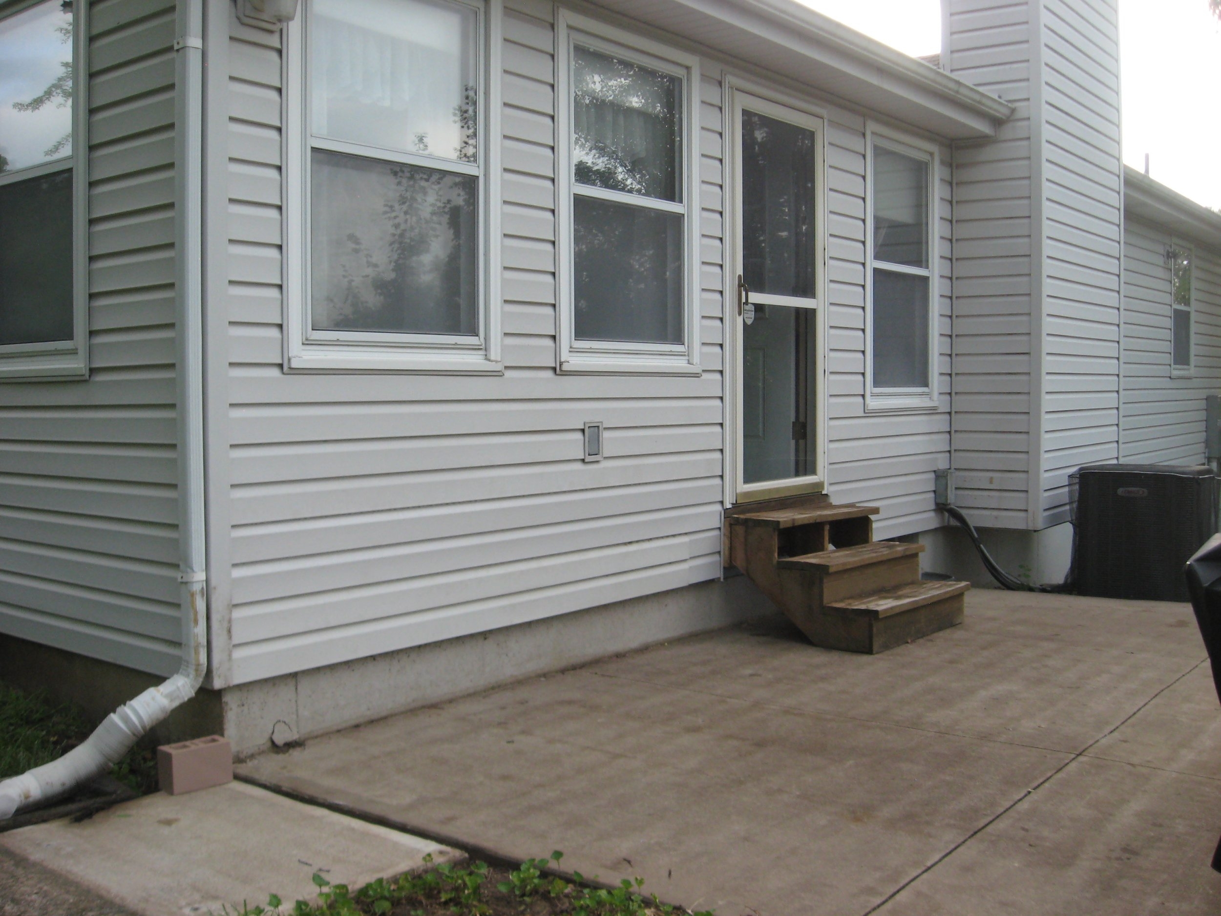

Replaced the missing siding yesterday and this morning the deck went bye-bye in the dumpster. Next will build a little more permanent stair/landing. Going to try to re-use some of the good pieces of lumber reclaimed from the old deck (yes, there actually were a few, mostly deck boards and guardrail pieces).
Discovered another occupation I don't want to be - siding installer...

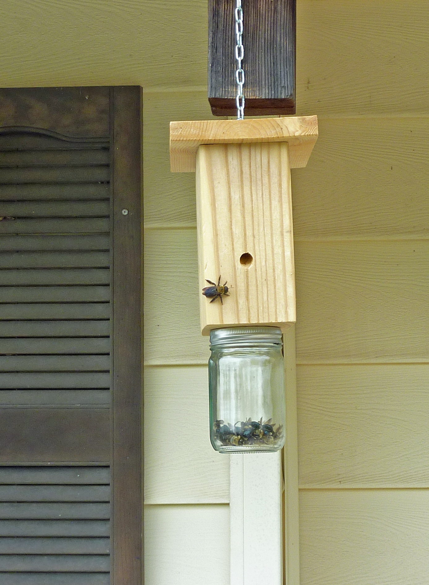

At the risk of derailing the OP's thread, try one of these traps:
Swat one and put it in the jar as bait. Hang it in a sunny area near where the bees are active.
