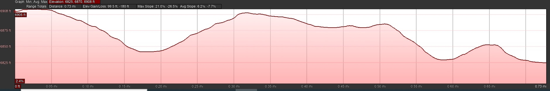

2/3rd of the road is far from flat. Here's an elevation profile that shows a 3/4 mile long section. +100ft and -180ft max slope is +22%, -26%.
I really don't want to chain up if avoidable (might put some grip studs into the tractor's tires for ice). Will the extra weight of something like the 9540 (13,000lbs with a loader) help with grip on those hills?

Extra weight helps a lot when plowing snow. Snow weighs a lot, more weight on snow plow, more snow that can be pushed.
A backhoe can clear two paths worth of snow, it normally requires three passes, one down each side then a center pass. Or lots of plowing off the side if just using the loader bucket. If I were you I would rig up a old large snow plow blade that you can pin in the bucket. You do not need angle, just plow to one side, halfway through winter pin the plow to angle the other way so you wear the blade evenly. One thing nice about backhoes is that if you get stuck they generally can unstick themselves with the bucket or the hoe. I have pushed drifts 5' high with a 2wd Ford 655 on level ground at low elevation (1,000').
