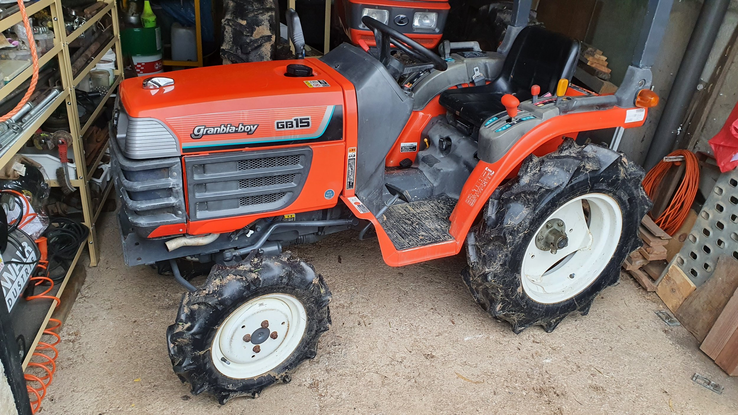

That's what I've got week ago. I don't know, do I really need it, but it's too late to discuss. The price paid €5400 with 1.21 m width tiller included. Lets say it'll be dedicated for some small jobs (yard mowing, firewood preparation...). It has CAT0 hitch type, which I'll transform into CAT1. If anyone has any good or bad experience with such tractor, please share.

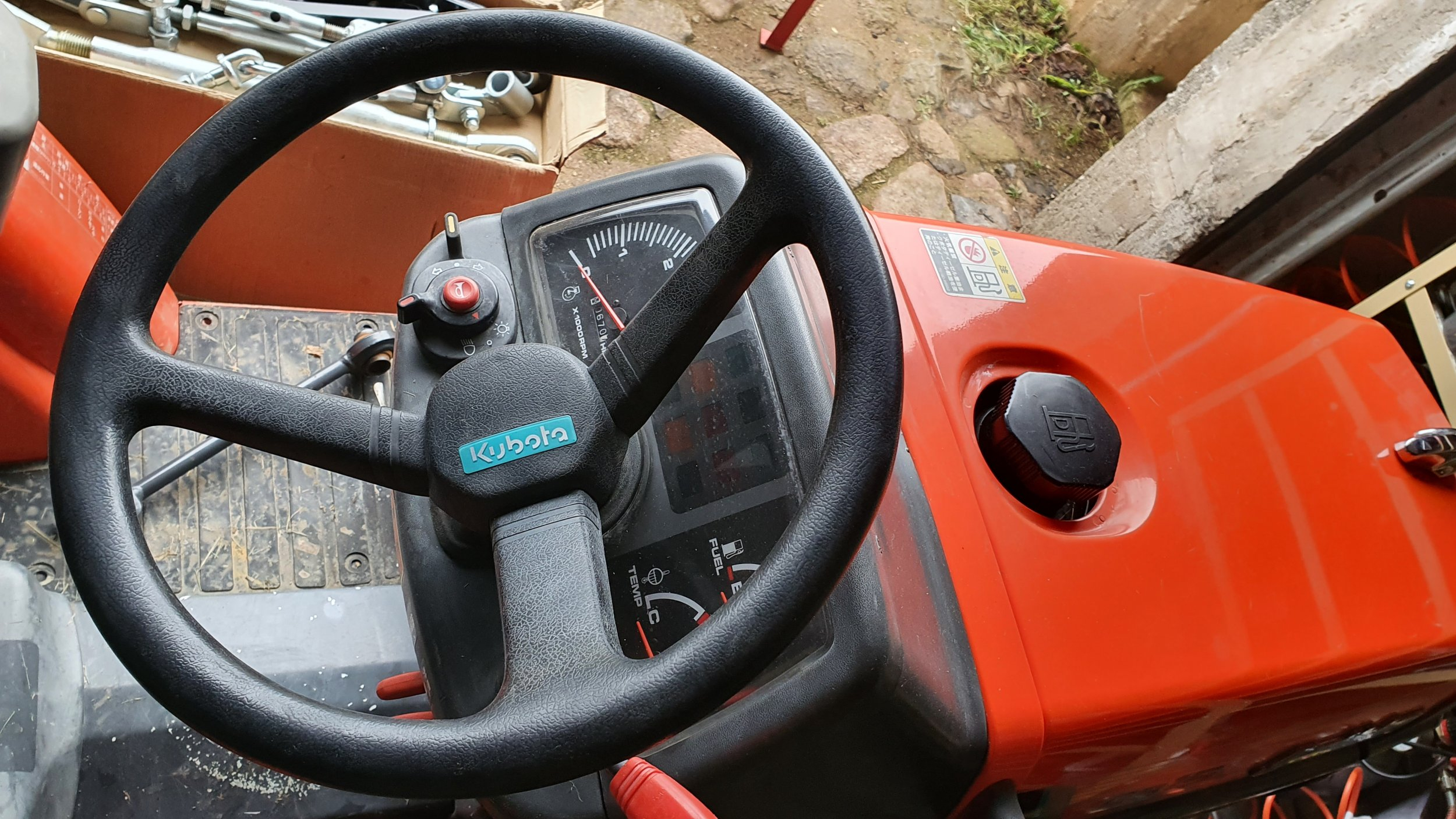

If someone might ask me what is its brand name, I would answer I don't know. The only place with a sticker of well known brand name is on a steering wheel. But no marking anywhere else.

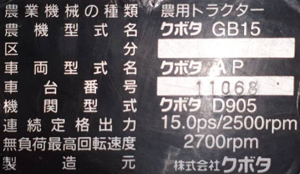

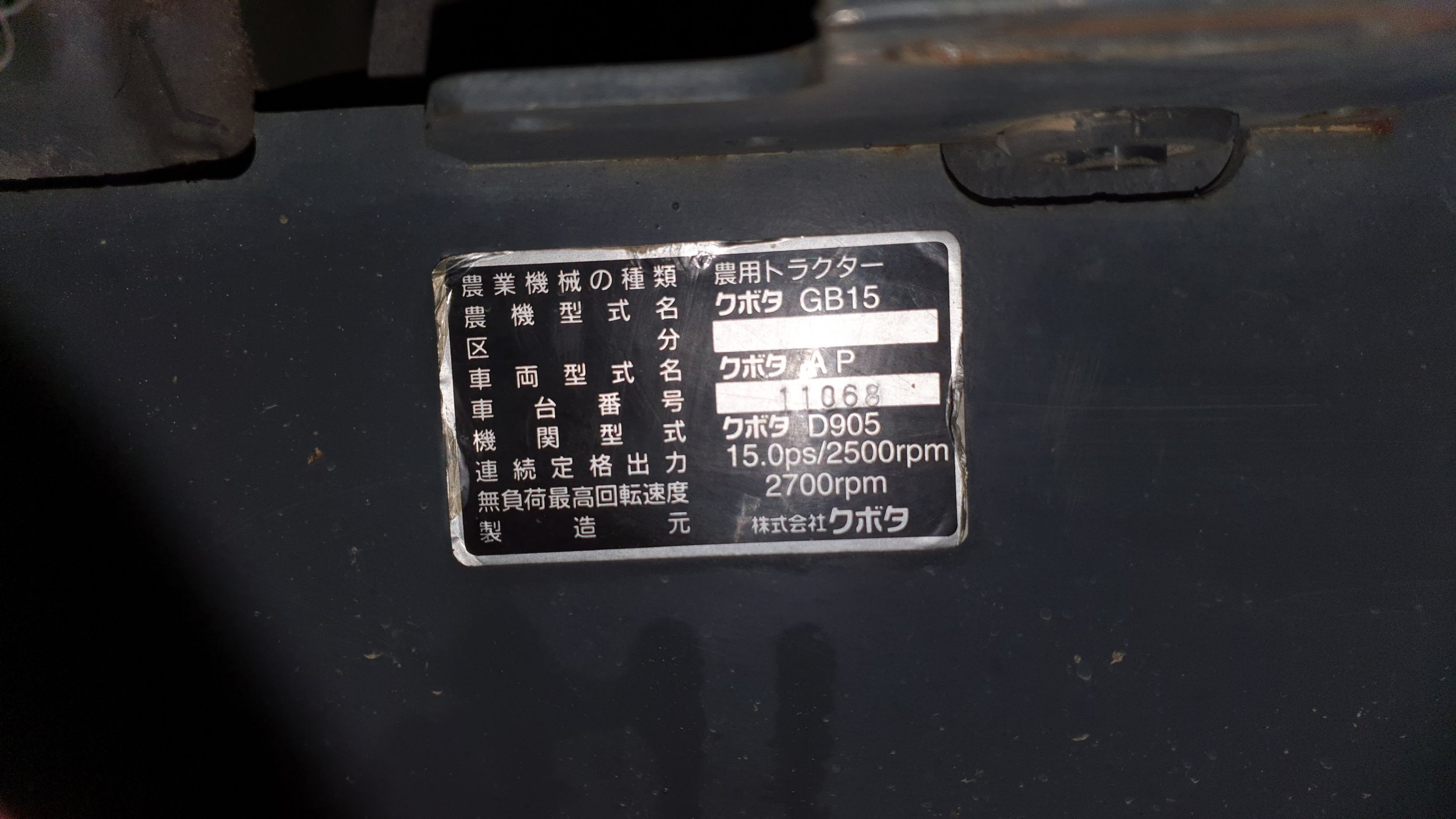

And here is a VIN plate, which says me nothing except engine type D905, engine power 15 hp at 2500 rpm, and max 2700 rpm.

/ What Did I Purchase? #4

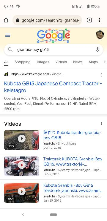

I got Google translate to work on the right side of the sticker:
The left side is "
Agricultural machinery type
Agricultural machinery Model name
Classification Vehicle model name
Chassis number
Engine model
Continuous rated output
No load Maximum rotation speed
Manufacturer"

For sure I've searched info of it everywhere. Just I am confused that there is no mark on a bonnet or on the front grill as Kubota usually do. That led me to the question, why?

/ What Did I Purchase? #8
This is a Kubota tractor, however, these are usually sold on the Asian market under other names. Zen Noh for instance comes right to my mind on the older Kubota's.
Many of these tractors had some nice features like 3 pt auto leveling, bi speed, auto lift for the 3 pt once you hit reverse and many more. Sadly, these often get ripped off during use or during the import process, since they literally shove these things into a 40 ft container and ship it to whoever pays more for it.

/ What Did I Purchase? #17
Definitely Japanese language on the nameplate/sticker.
Kubota is written many times in Japanese Katakana, which is one of two phonetic ways of writing the Japanese language.
Japanese use a version of Chinese kanji characters in their written language. Lots of kanji on the nameplate as well, which I assume are the version of characters used by Japanese.
Just mentioning this to add to the conclusion that it is a Japanese product and not Chinese.
Edit: By the way, looks like a nice tractor!
