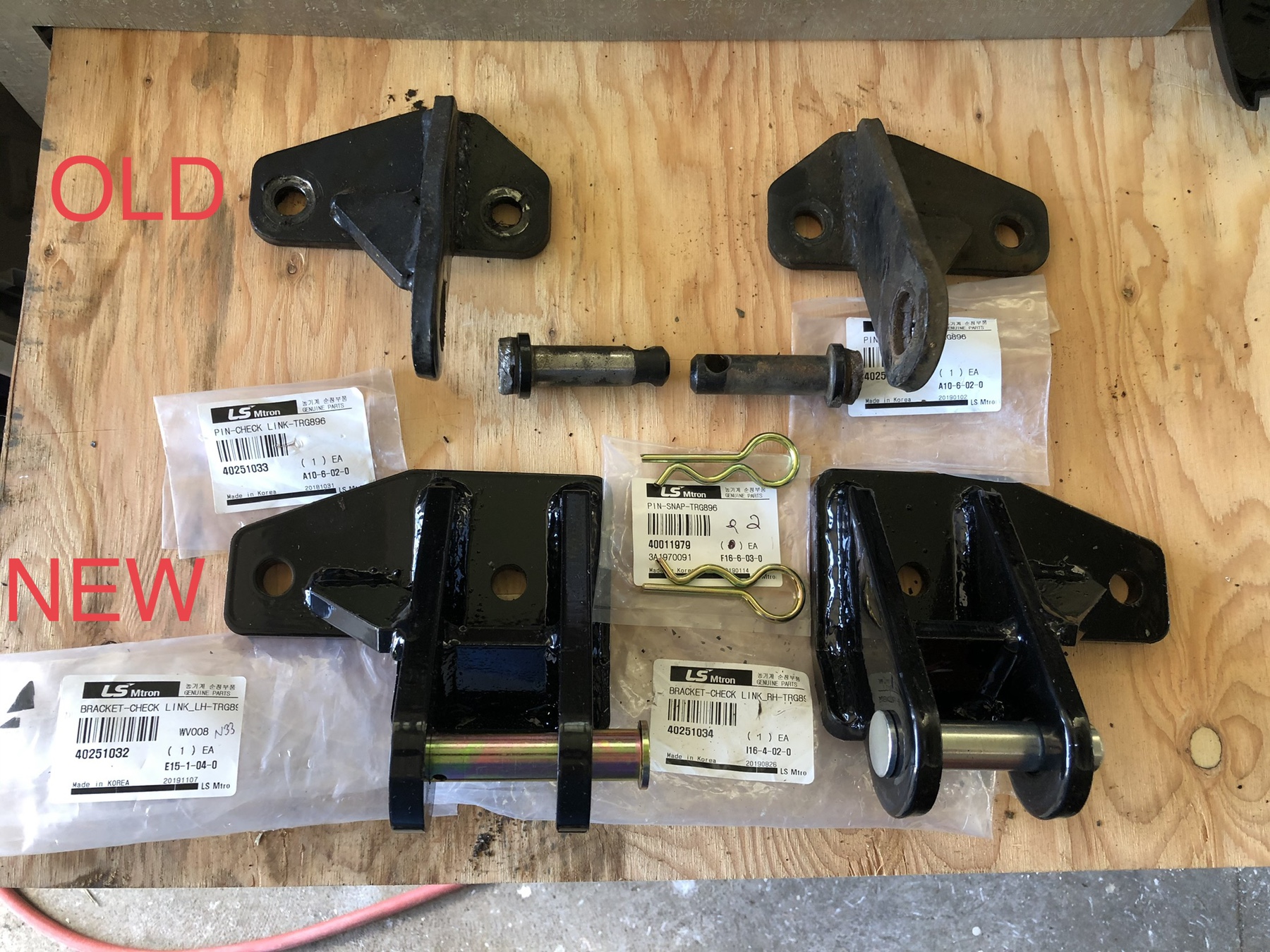

On way back to shed and I hear a strange noise. Look back and the other stabilizer bracket has broken. Good thing I’m picking up the new ones tomorrow.

Off to dealer this morning. Said he would contact LS re warranty on my 2 broken Stabilizer brackets.
   / What did you do on or to your LS Tractor today? #1,378
I’m gonna say this is a substantial upgrade 🤙
Will be discussing warranty issue with dealer Thu.
   / What did you do on or to your LS Tractor today? #1,379
I’m gonna say this is a substantial upgrade ��
Exactly what should be used in the first place. You won't have anymore problems on that part. :thumbsup:
   / What did you do on or to your LS Tractor today? #1,380
Totally agree. As I was telling my dealer, two previous tractors, Kioti and Case, same implements, same property and never an issue with the stabilizers. All tractors with the telescoping type.
