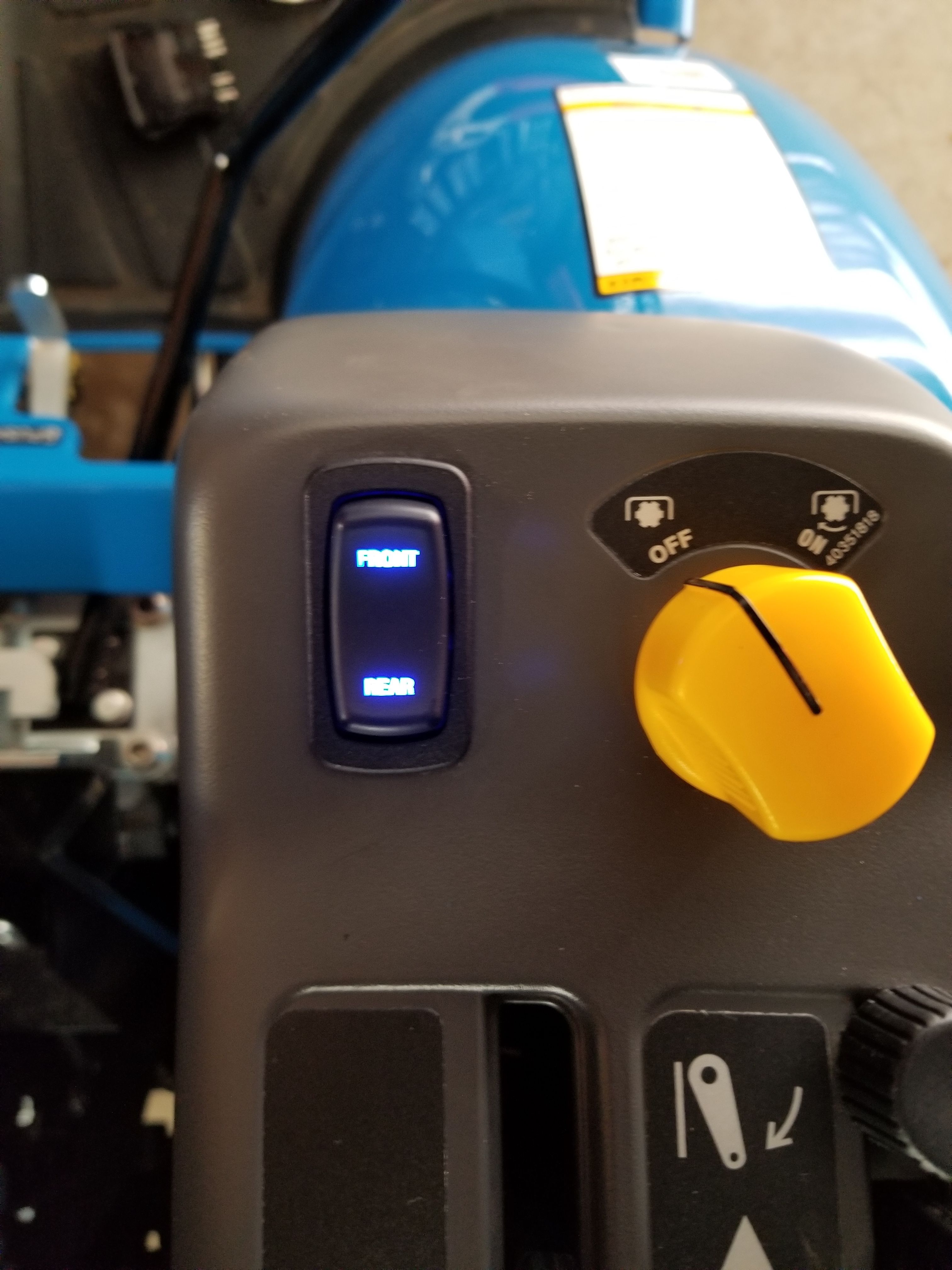

Looks good, on that Front/Rear switch, can you only select one or the other, or can they both be ON at the same time?
Front or back....not both.

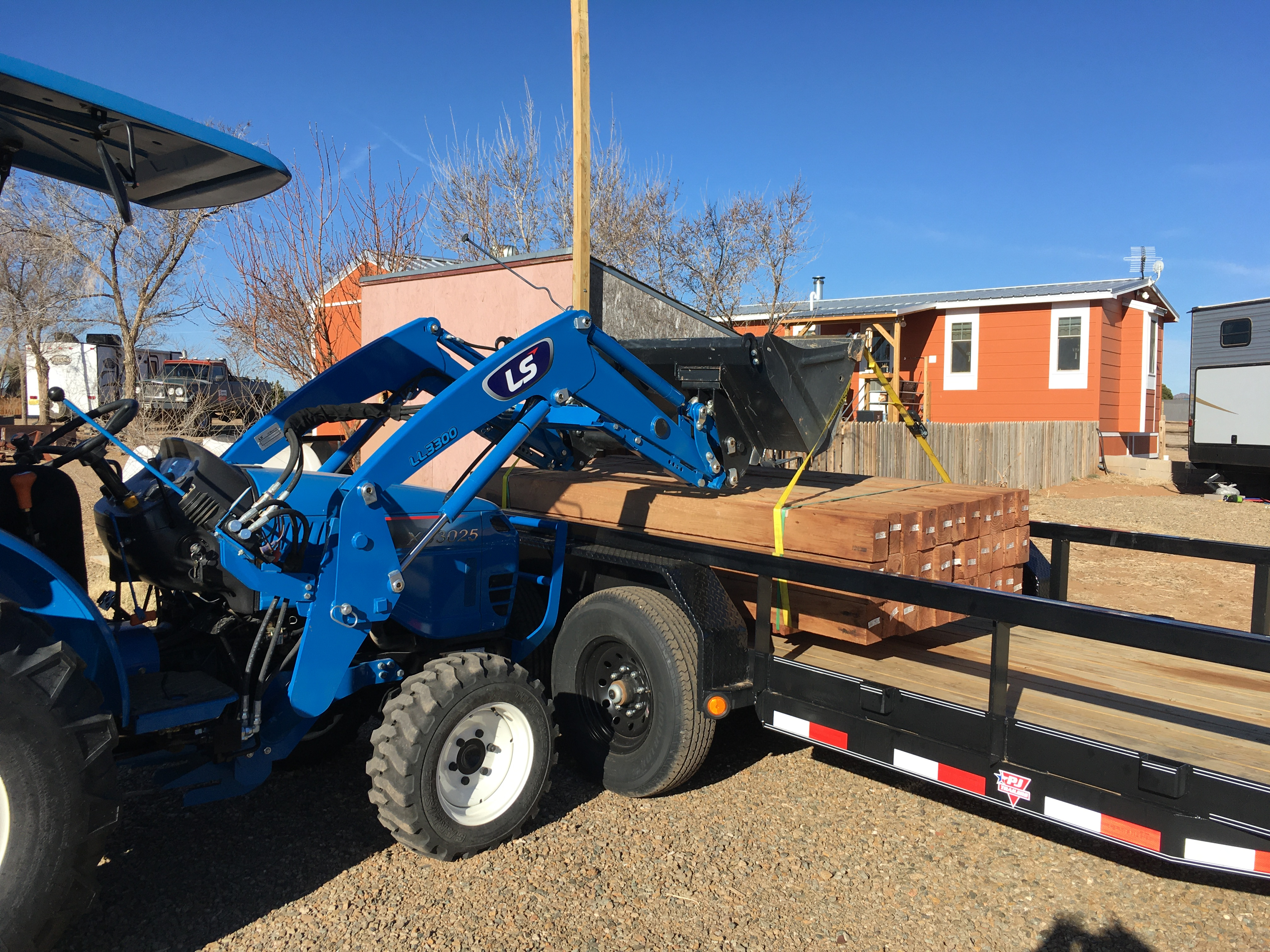

Used the tractor to unload a full bunk of 4x6x8' treated posts. My guesstimate was about 1350 lbs. Just barely lifted it out, but considering I had the bucket on and the straps attached to the front lip of the bucket, the tractor lifted it.
I am definitely going to fill the rears with ballast.... the box blade weighs 500 lbs and I added 2 cutting blades on top of that.... the backend was real light for sure!

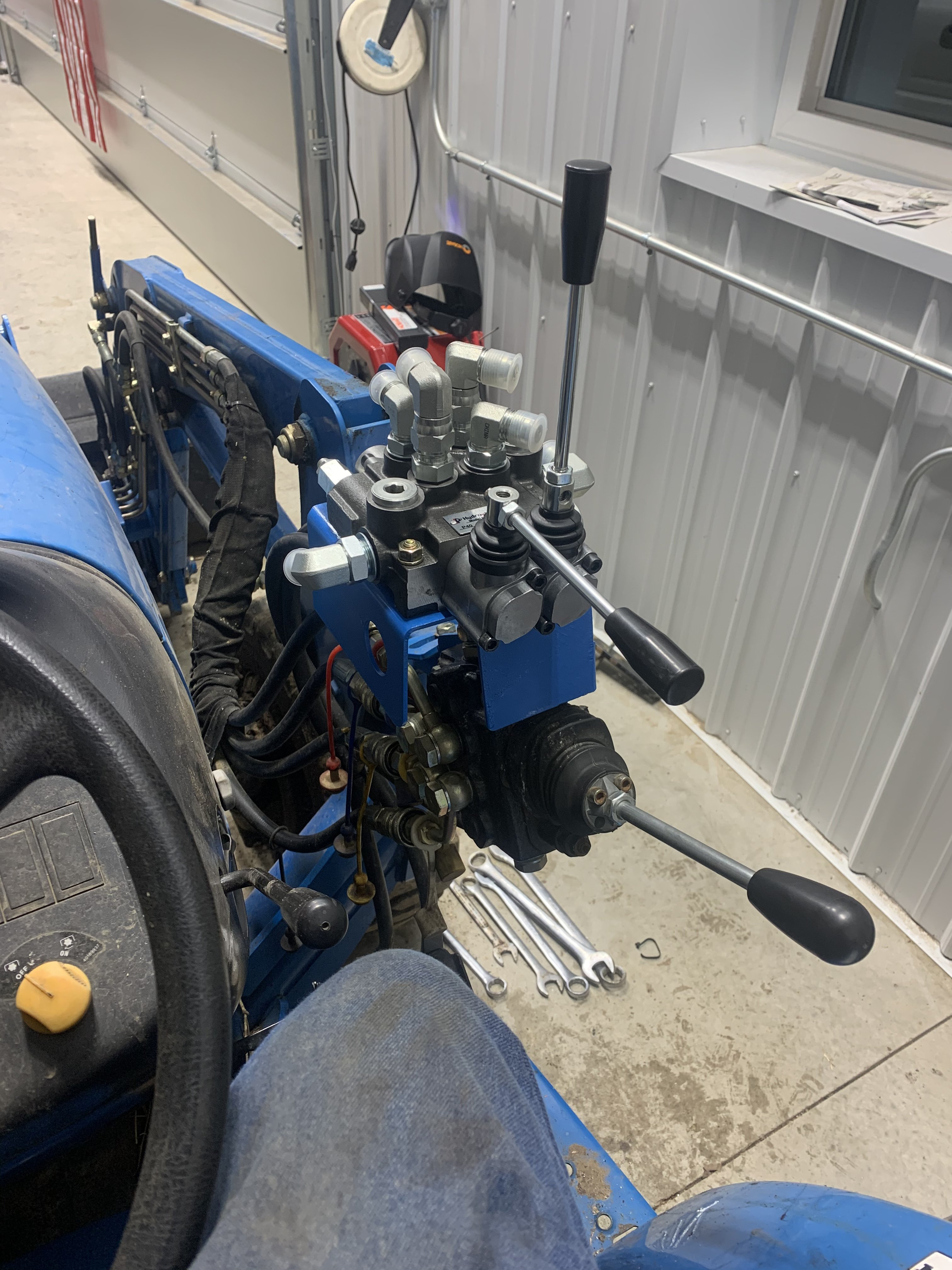

Installed the WR Long 3rd function kit, mostly.
Holes were too small, had to drill them out.
Had to install longer bolts to hold the valve assy to the loader frame.

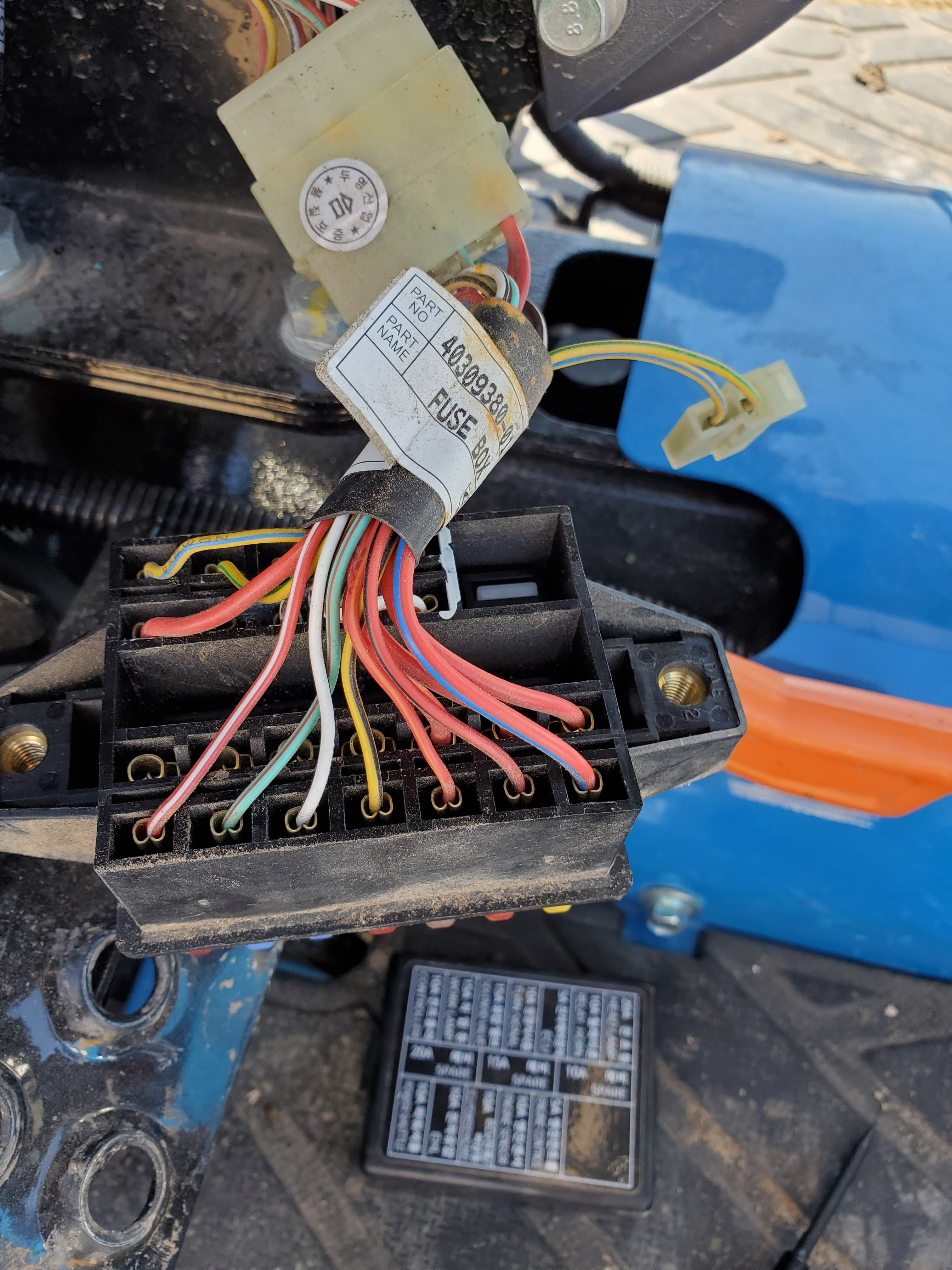

Found a nice plug coming out of the Fuse block that wasn't used (Power Shuttle and EHL. both 10Amp) so I just ran the power wire to one of the connectors. I'll move my LED lights to the other one eventually.
Could not get a wrench on the hose that went to the remote block so went and bought a set of Crows foot wrenches and had that done in 30 seconds.
Got everything done but mounting the hose ends on the loader. The bracket supplied just isn't right so I cut and welded it up the way it should be. Just need to drill the mounting holes, prime and paint it, then final install.

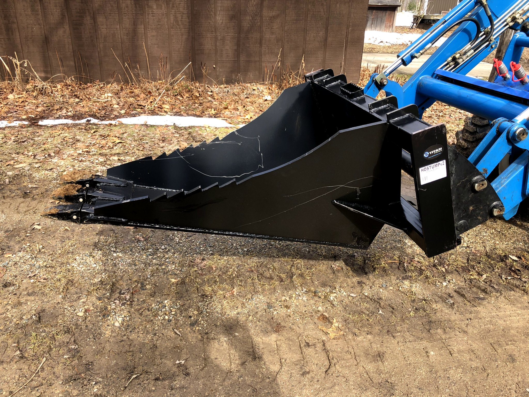

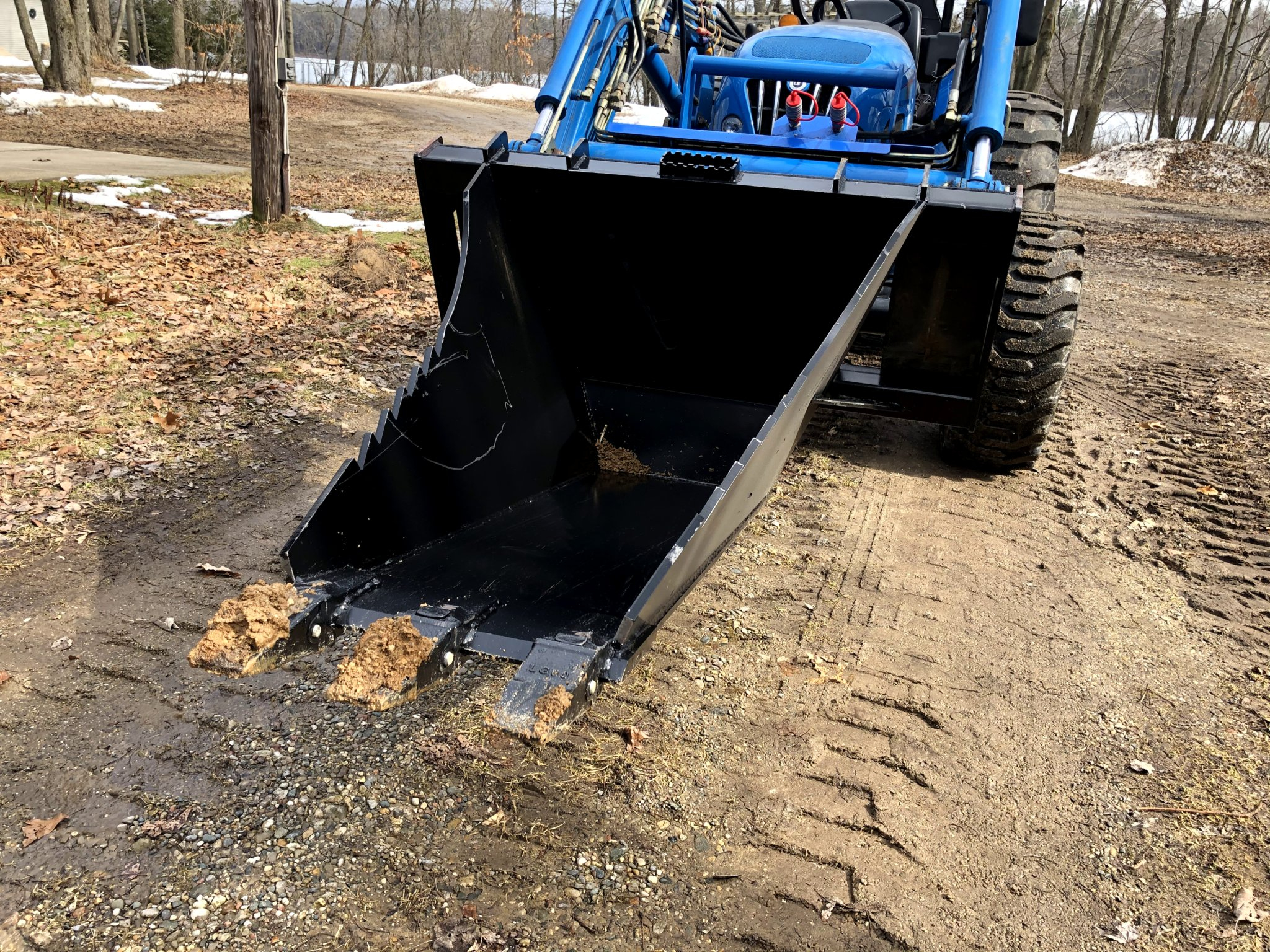

Mounted my new Titan heavy duty V2 stump bucket and played with it a little, 1/2" steel, it's a beast!
