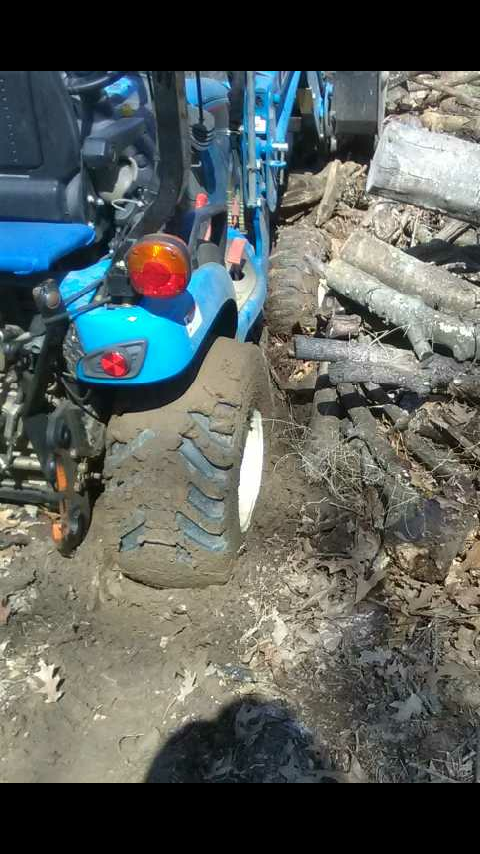

Tires full of mud ☹️

I have to laugh because I got stuck twice already but was too embarrassed to post pictures. Since I have a front end loader and a backhoe I was able to use them to lift my front and rear wheels out of the mud and then I used 4x6s and placed them under the wheels. I lowered the wheels on to the 4x6s and drove right on out. It’s a task afterwards to clean.

Yep, That's R4 tires for you. I would never have them unless all I did was loader work on concrete or level gravel area.
   / What did you do on or to your LS Tractor today? #1,738
looking at that front axle I don't believe it would have made a bit of difference what type of tire he had on.
R1's might have dug a bit deeper a bit faster.

I'm more interested in the story. How did you manage to get stuck, and more importantly, how did you manage to get out?

I don't think the tires would have made a difference. As I've said many times before, I have almost NO flat ground. Virtually everywhere other than the house and garage is on a slope. There is an area just below the shed I've worked on that stays wet, even in a generally dry summer. It's just where everything else drains. That's where I stacked some junk wood and brush that was leftover after getting firewood cut out.
I decided to push some of it further downhill to burn when I get a decent day. Made one push into the pile and sunk. Couldn't go backwards up the hill. Tried diff lock. Tried crabbing with the loader. Just kept digging deeper into the muck. Couldn't go forwards because of the wood pile. Not enough movement either way to try and rock or turn.
Called a neighbor but they weren't available.
Thought about it for a while and 'assessed the gravity' of the situation. It wanted to go down hill. So, I started moving what was left of the woodpile by hand. Luckily there wasn't a whole lot right in front of where the tractor was and I was able to get a 5-6' width cleared without too much trouble. Jumped in the seat, started it up and drove downhill, right through the path in the wood pile.
Not sure when or if it will dry out enough there to try again. I may just burn the pile where it is.
