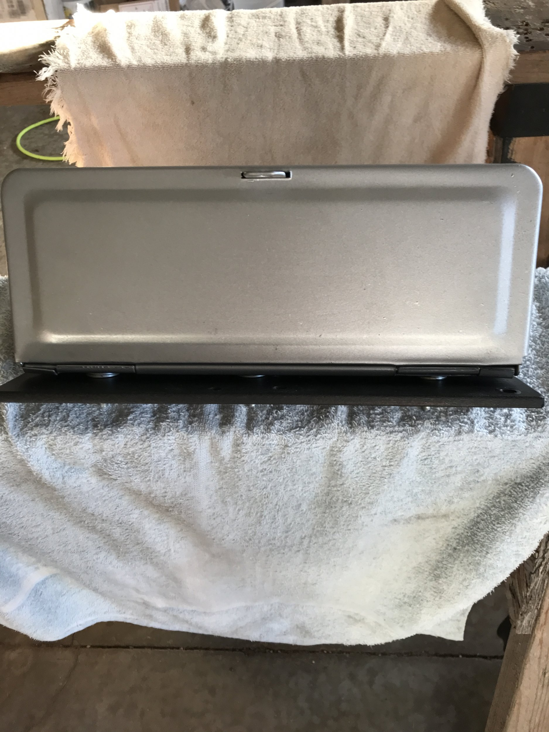

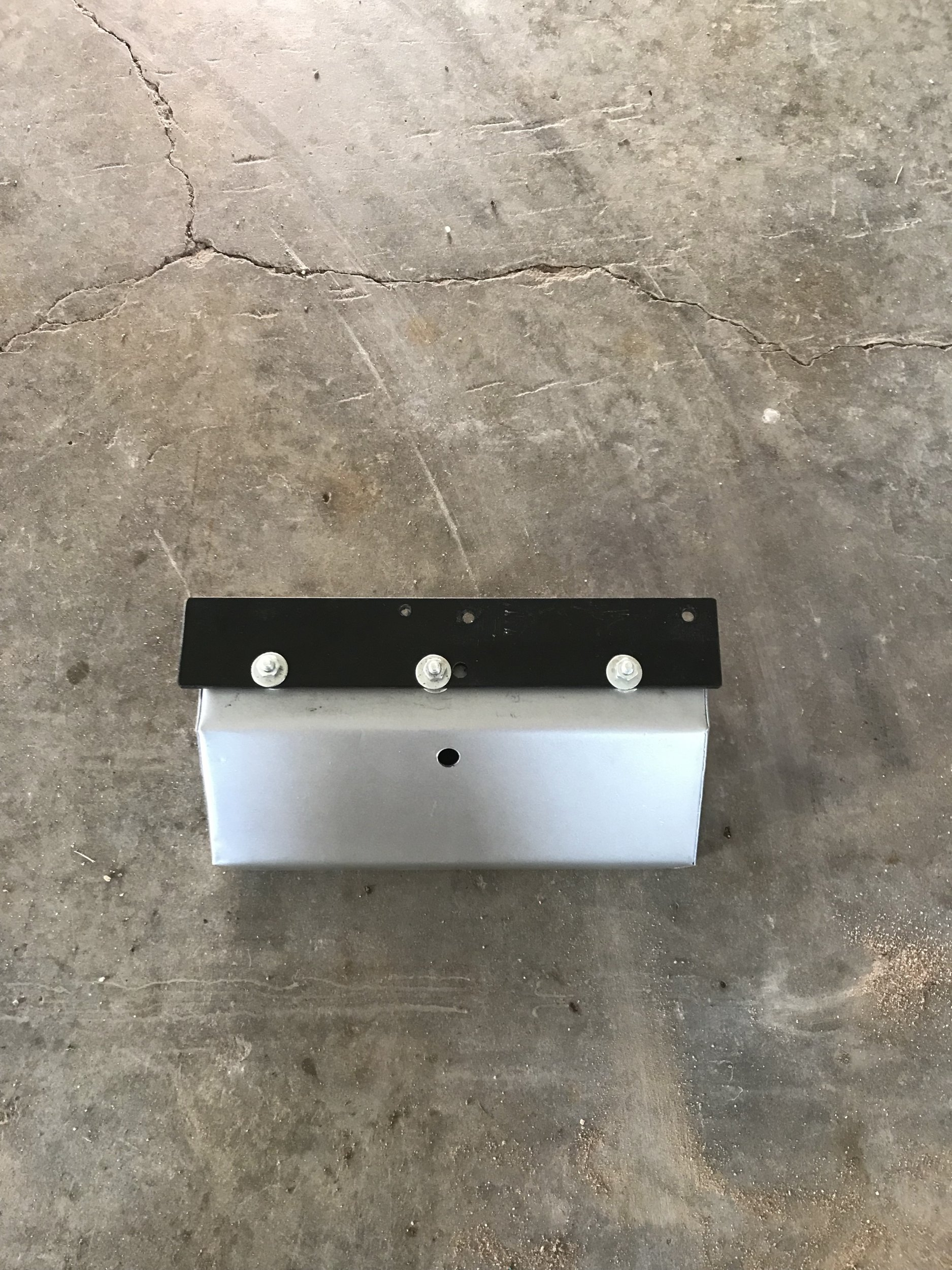

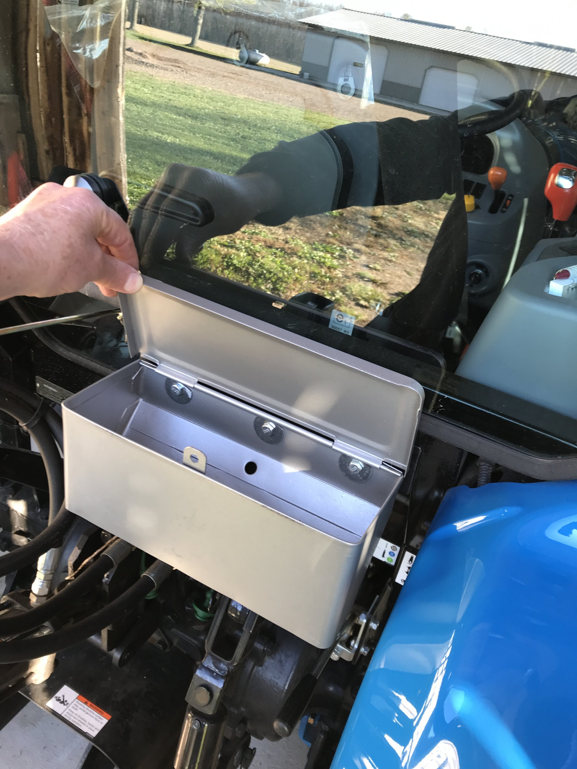

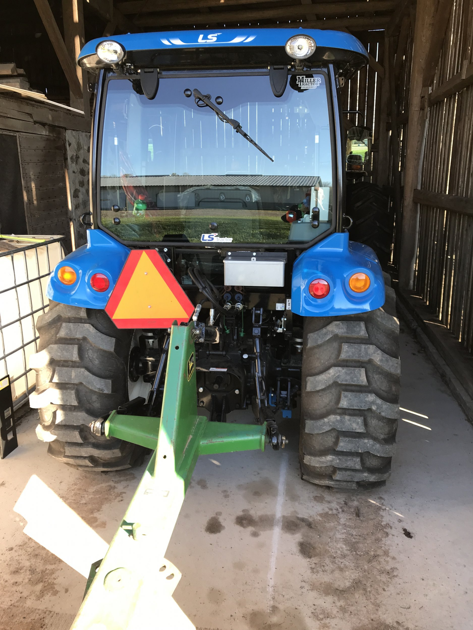

Like it a lot thanks for the tip - yeah I saw those 8N tool boxes even have them painted Ford Blue which should be close enough. I see you used that bracket but how did you attach the box - looks like you have 3 bolts there??
Here is a picture of my homemade bracket attached to the toolbox with 3 bolts, the bracket lowers the box enough to clear opening the window and allow the toolbox to open properly. There are two washers on each of those bolts between the homemade bracket and the toolbox to allow the toolbox cover to open properly. The two top holes are drilled to match the bracket that came as standard equipment on the tractor, I’m not sure exactly what the intended use of the bracket was but I’m sure it wasn’t for a SMV sign because there is a separate bracket for that on my tractor.
I believe the bolts that screw into the tractor bracket are 7mm metric bolts. The three bolts that attach the homemade bracket to the toolbox are just 1/4 inch stove bolts. Mounting the toolbox was a pretty easy but time consuming project.

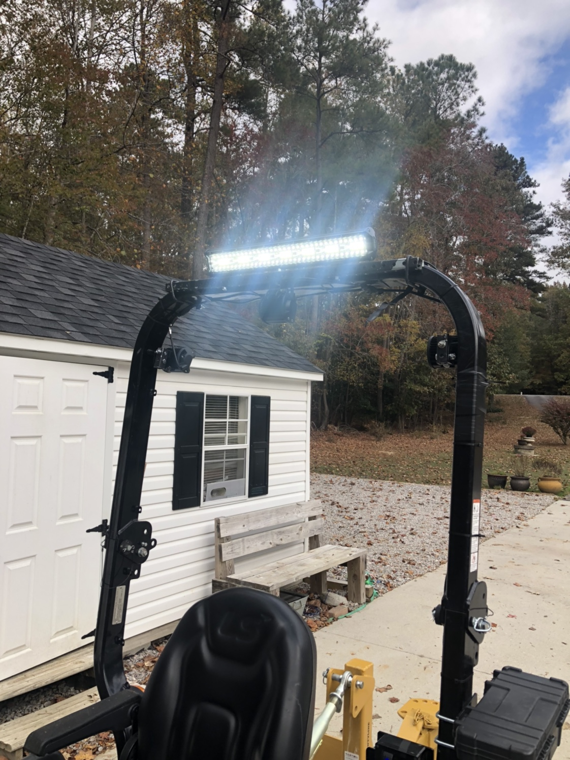

I added LED lighting to my ROP bar. Since my MT125 is only a year old, I didn’t want to do any drilling or wire splicing. I am currently using the 12v power plug(cigarette lighter) as my power source. I added a switch in a project box mounted to my Caution sign bracket. I used u-bolts and a one inch square tube to mount the lights. Later on when the tractor is past warranty, I will tap into A switched power source and add another switch (there are two blanks on the dash) so I can run my front and rear lights separately.

I added LED lighting to my ROP bar....
Looks good! LED light cubes or bars really are on a different level of lighting.
