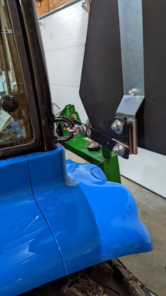

Thanks for the picture ! Looks pretty slick, I might have to try the same thing because where my SMV sign is now it interferes with the hoses for the hydraulic top link.
I’ve been trying to figure out where to relocate mine too ( it’s off right now) for the same reason ( interference w/hydraulic lines for T&T). Never looked at the strut attachments-great idea.
I also played around and came up with another option if it interests you. I used a 1/2 inch wire rope clamp and a piece of scrap steel for this version. This version also does not interfere with the rear window opening.

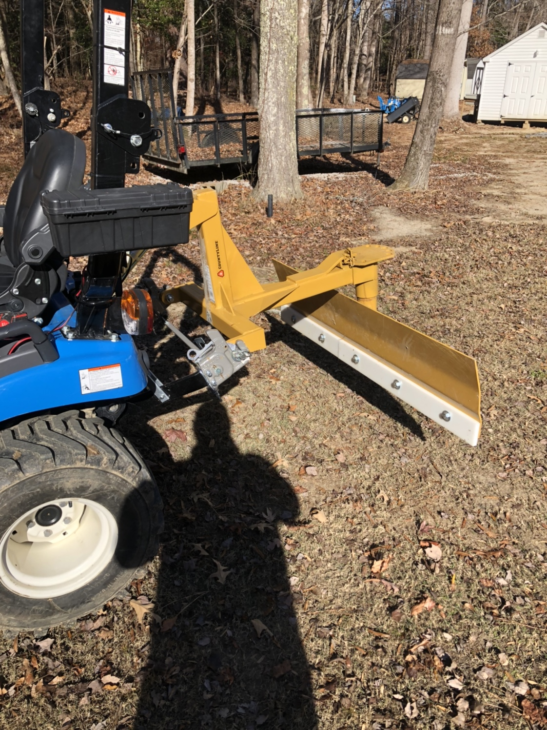

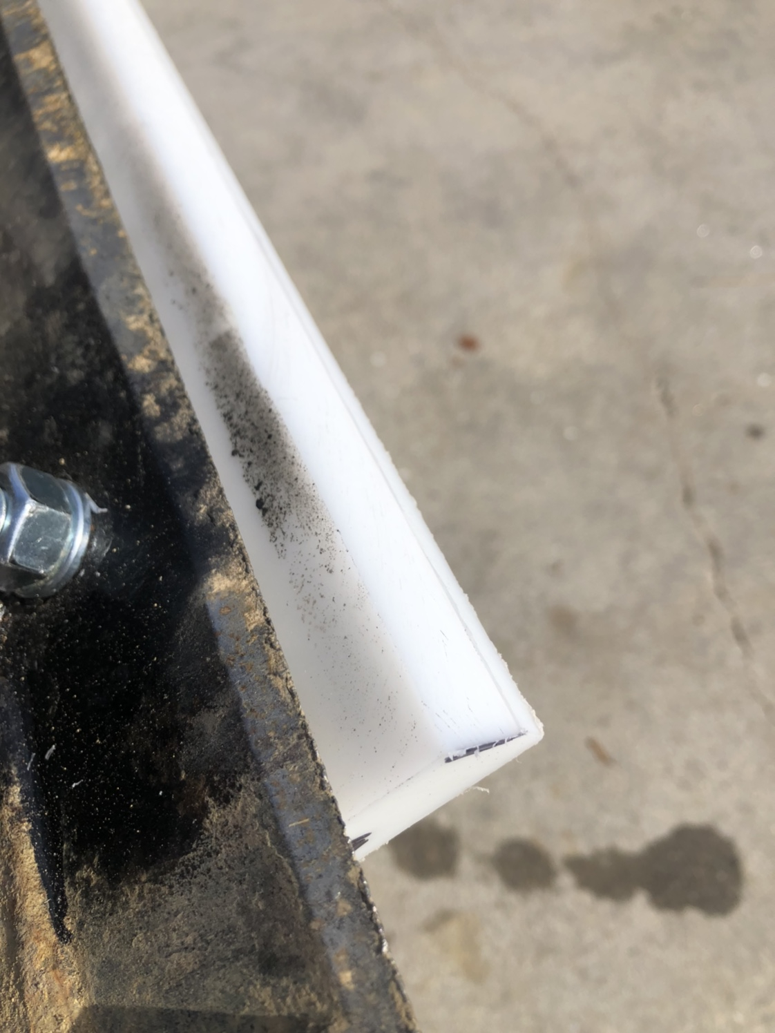

I dare it to snow in central Virginia this year. I finished adding UHMV strips to my FEL and Rear Blade. I removed the cutting edge on the rear blade so I wouldn’t have to drill any holes in it. I didn’t realize how heavy it was. So I’m already for the snow to fall.

Dimensions please.
I bought a total of three UHMW Sheet 3/4" x 4" x48" By Peachtree Woodworking - PW1125 from Amazon. The FEL width is about 2 in longer than the UHMV so there is an inch gap on each side. I bought 1/2 carriage bolts and bored out each hole enough to make the bolt flush with the UHMV. For the rear blade, I had to use two pieces of UHMV since they sold only up to 48 in and my blade is 60in. I cut them down to size and drilled 5/8 holes in them to match the size on the existing holes in the attachment. I did take off the cutting blade. If I didn’t, I would have to drill hole in it which I didn’t want to do. The total cost of both FEL and rear blade mod was $130. That includes the bolt that I bought at my favorite store Tractor Supply. There nuts and bolts are sold by weight not by individual pieces as Lowes or Home Depot does. I believe it was 2.99 a pound.

Excellent....Thank you. here at the lake we get some really heavy snow and big berms. I have a really long concert driveway...just worried about wear n tear.

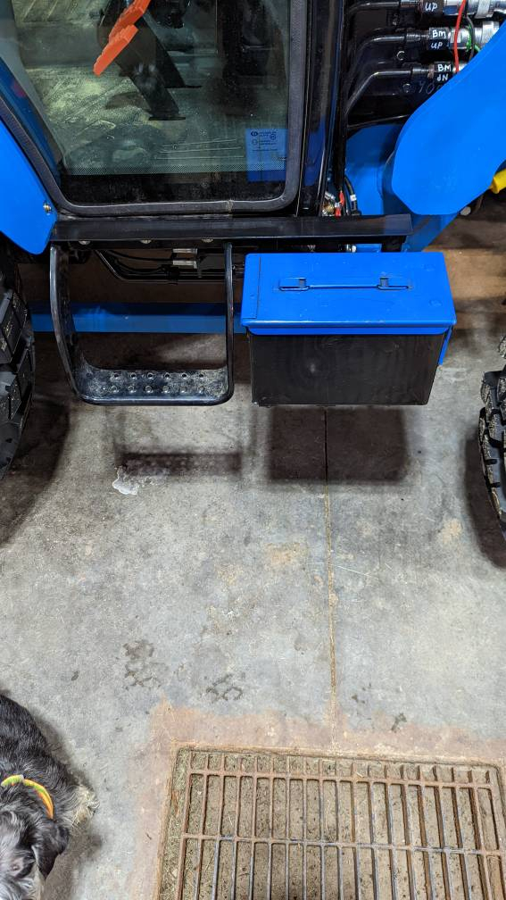

I moved my toolbox to give me the step back on the right side. It doesn't interfere with the door or the front tire.
I have a small plastic toolbox I may see if I can mount it to the license plate bracket on the back of the cab.
