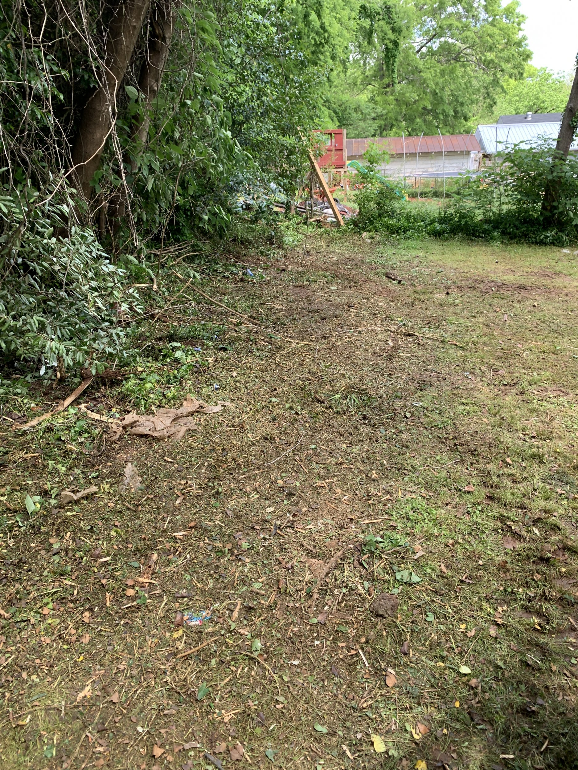

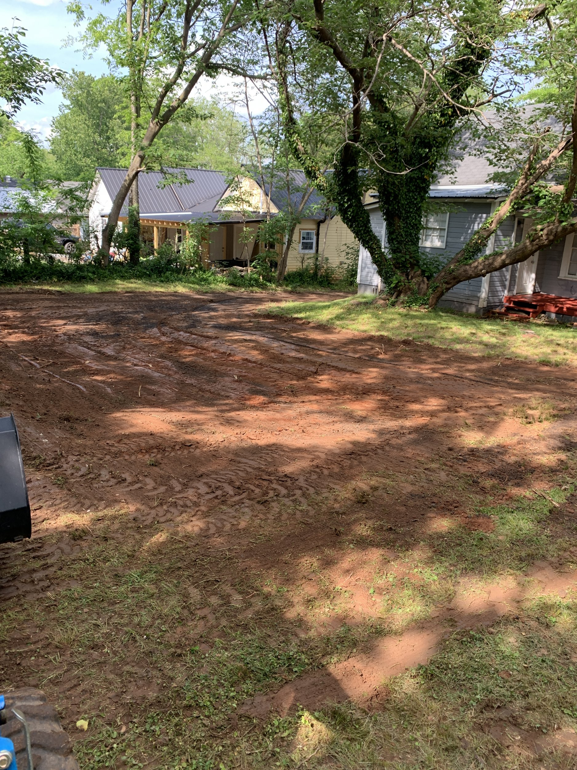

reclaimed 10-12 ft of yard space on one of our rental properties, then prepped a driveway/park area, loaded and delivered 2 dump trailer loads of asphalt millings to be accompanied by one more in the morning, then will spread them. gotta love that flail mower attachment for clearing these over grown areas

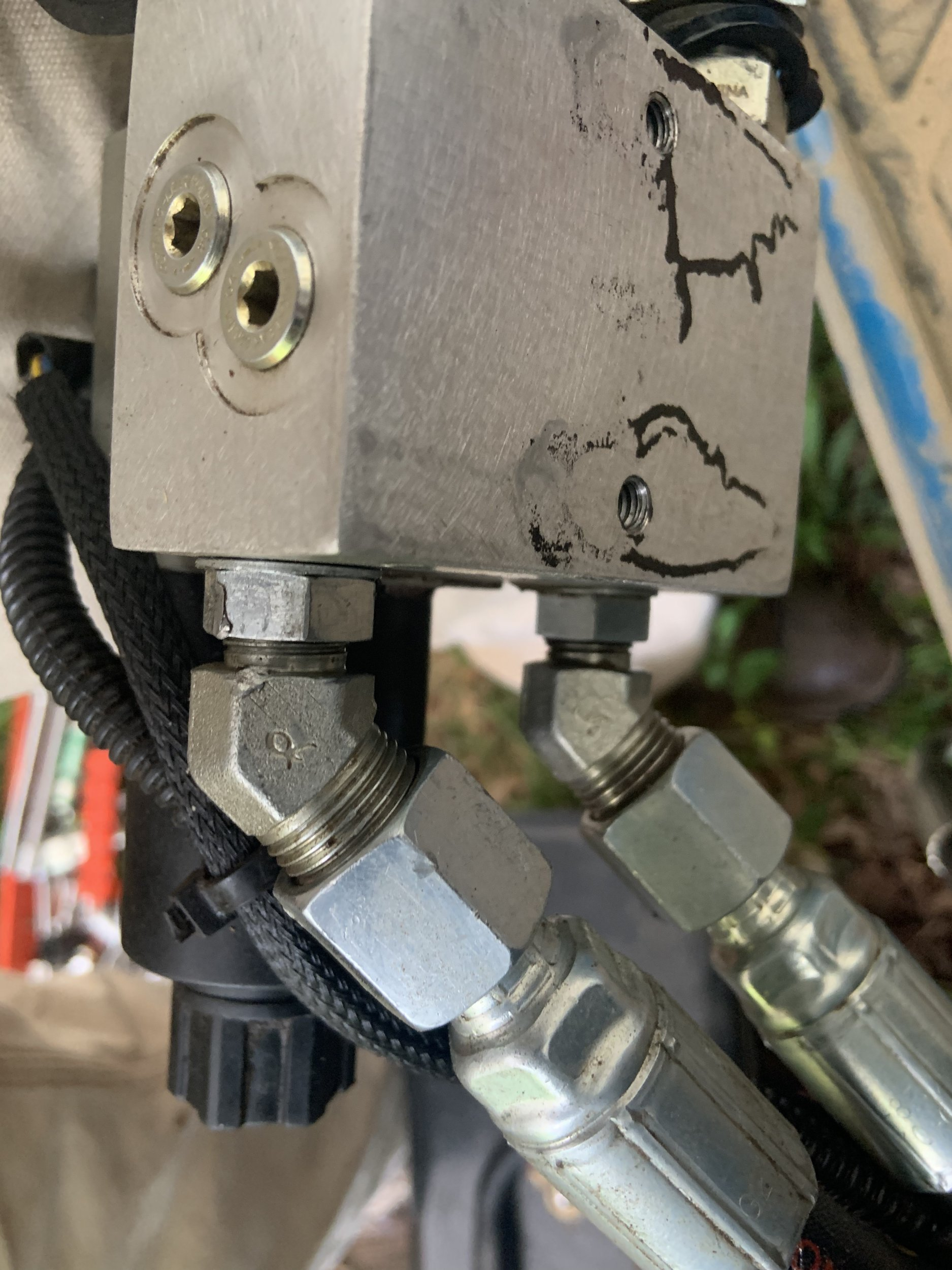

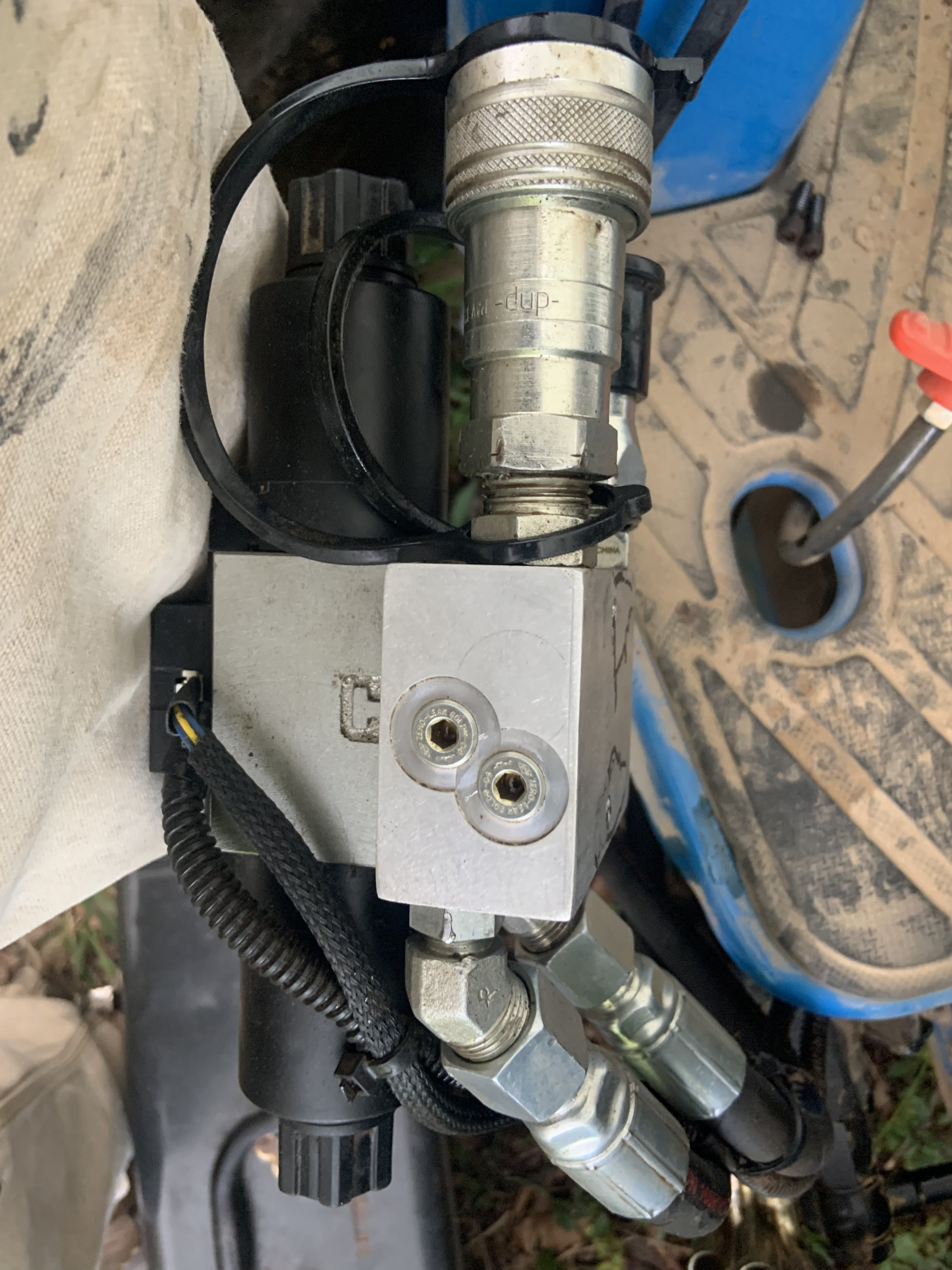

Fixed a hydraulic leak at my WR Long third function valve. Thought it was an oring boss fitting. Just by chance after taking it off from the bracket I worked my three point hitch to see if I could confirm the source of the leak. I did. It was coming from the allen screws on the side of the valve body. Tightened them and cleared it right up. I’ve never used the third function valve in the 250 hours of tractor use but all 4 screws had worked themselves loose. I recommend checking them every 100 hours or so.

this was yesterday, I did get that driveway/parking area finished

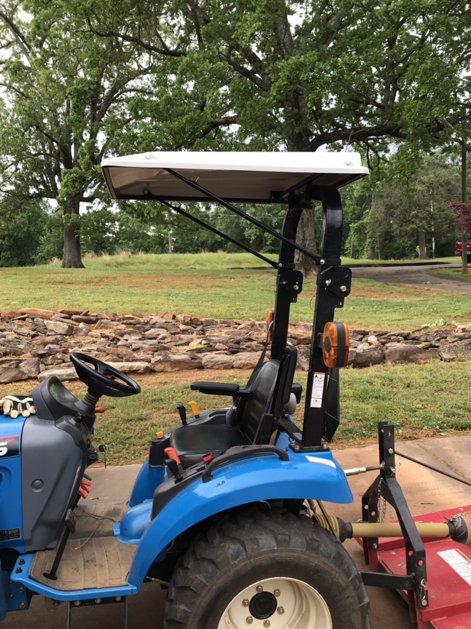

^^^^^Nice! You will definitely appreciate a canopy!
