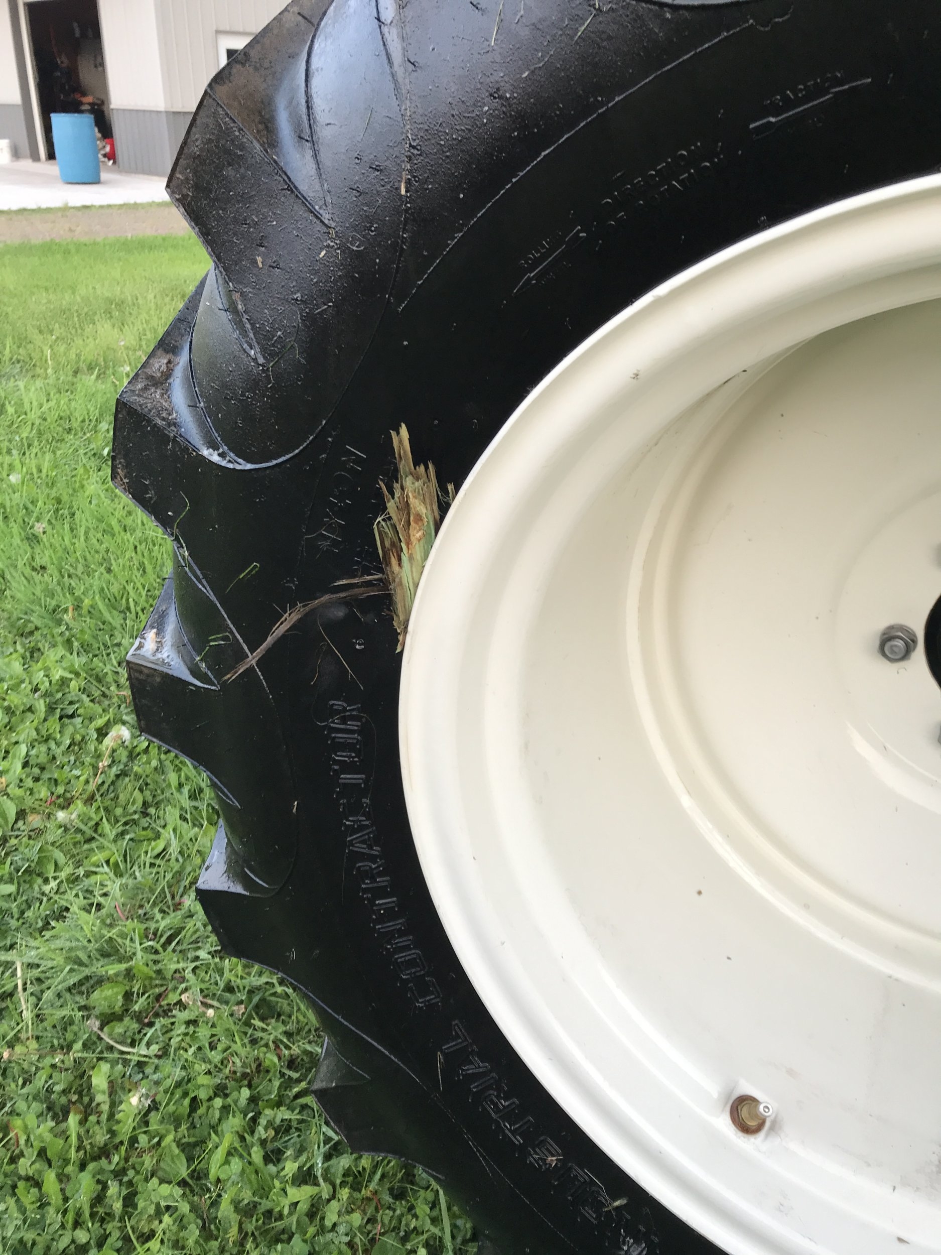

Used my nice heavy duty 3 point Woods Dixie Cutter to cut a bunch of tall grass and brush a few days ago, everything went fine so when I was done I washed the tractor off with a garden hose and noticed this.
A piece of wood managed to get wedged between the bead and the rim, a very small amount of beet juice must have leaked out when it happened so I had to have a tire dealer come out to remove the wood. Cost me $190 but I’m very thankful the tire wasn’t ruined. When the wood was in there the bead was pushed in about 1/4 inch, the tire guy was surprised it didn’t keep leaking.
