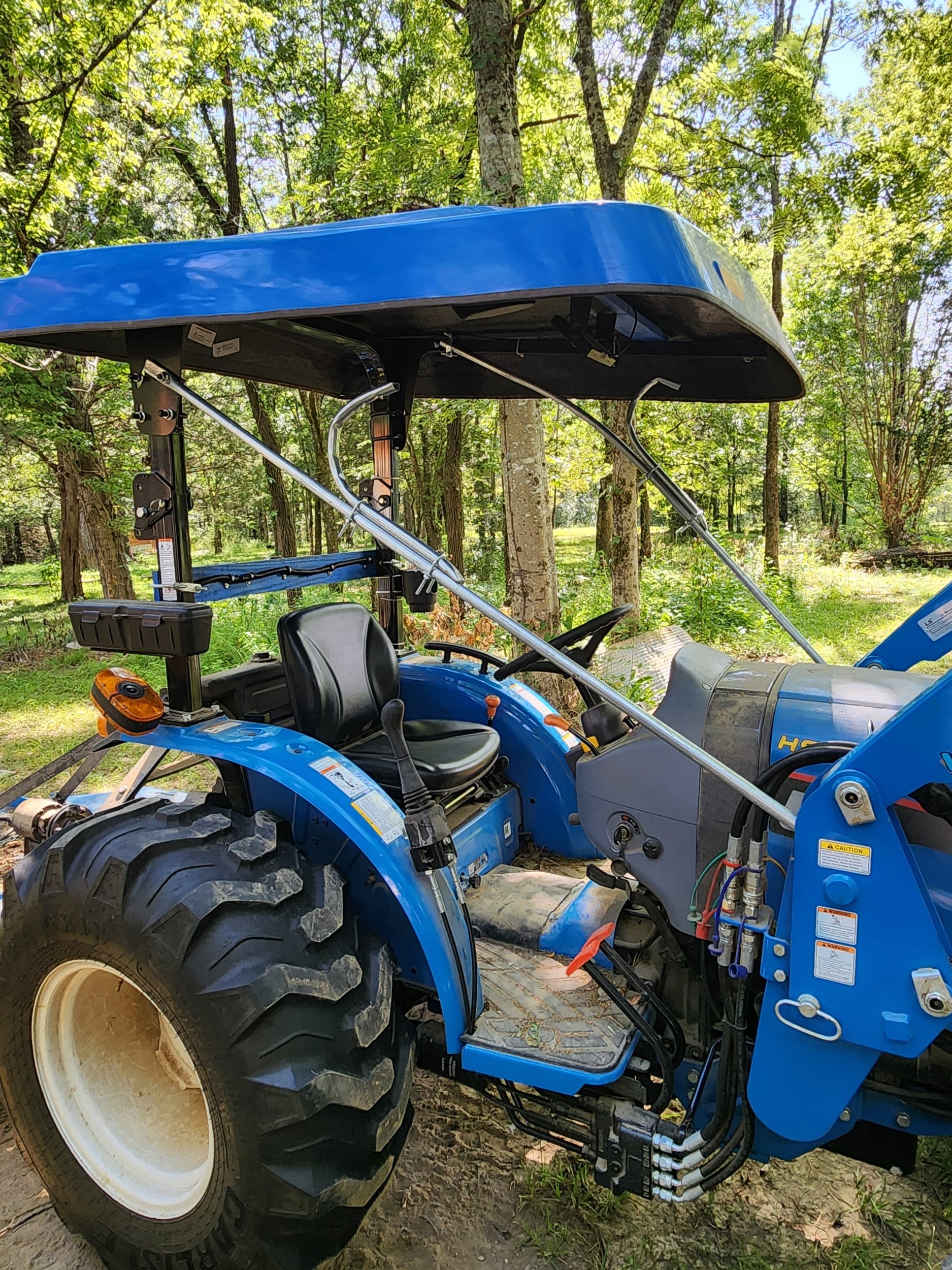

I had a several incidents where a limb would slap me in the face finally a bad one put two teeth through my lip.
to prevent this from happening again the "Limb Deflector".
Limbs will slide up to the curve and and out past my head.

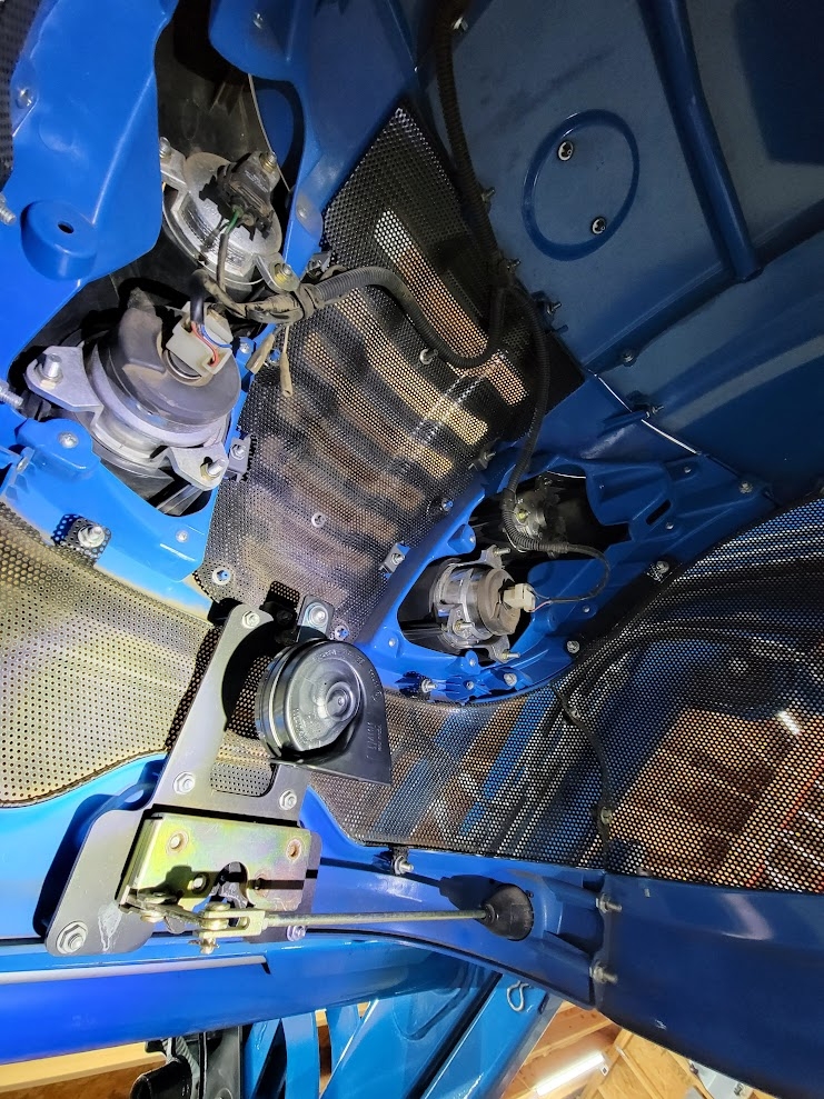

I've been wanting to install a horn for quite some time, today was the day.

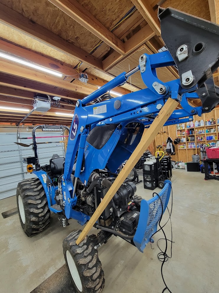

Dropped the grapple, and into the garage to figure things out.
First thing was to prop the loader out of the way, this worked really well.

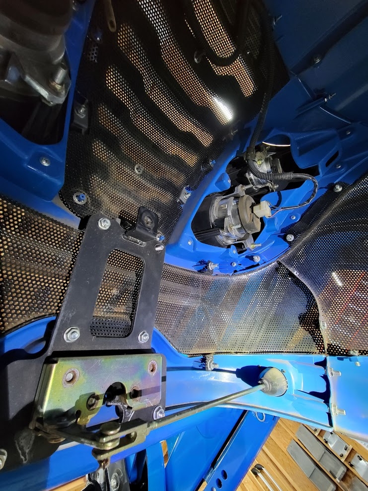

Looking inside the hood, there is a nice strong bracket that the latch mechanism mounts too, and surprisingly there is a standoff with open M8-1.25 threads right there!

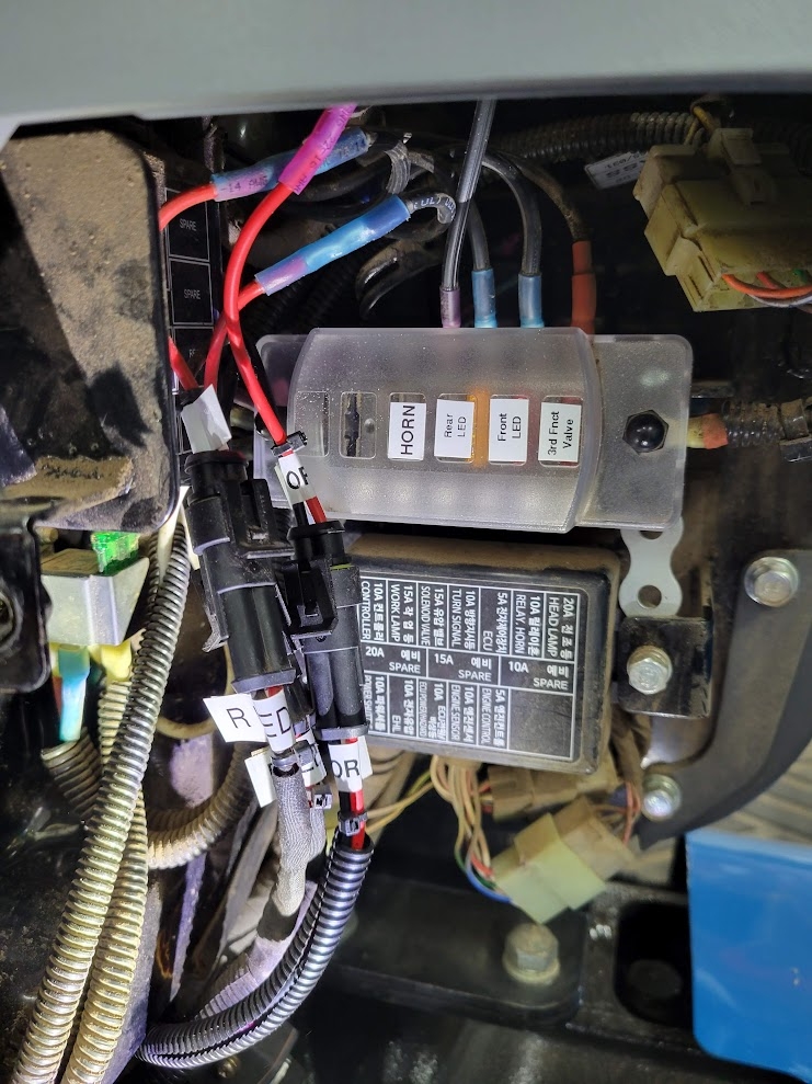

Perfect spot to mount the horn. The wiring just followed the factory light wiring up the hood and down to the dash access panel.
I have a switched fuse block installed, so I wired into that, and all my accessories have quick disconnects on them.
Mounted the Carling L-Series momentary switch so everything matches the factory switches. LED light switches on the right.
Really like this horn, put the same one on my SxS
   / What did you do on or to your LS Tractor today? #2,465
I didn't realize these tractors didn't come with a factory horn. Mine has one. :unsure:
The only time I really use it is to get the dogs attention. Nice write up!

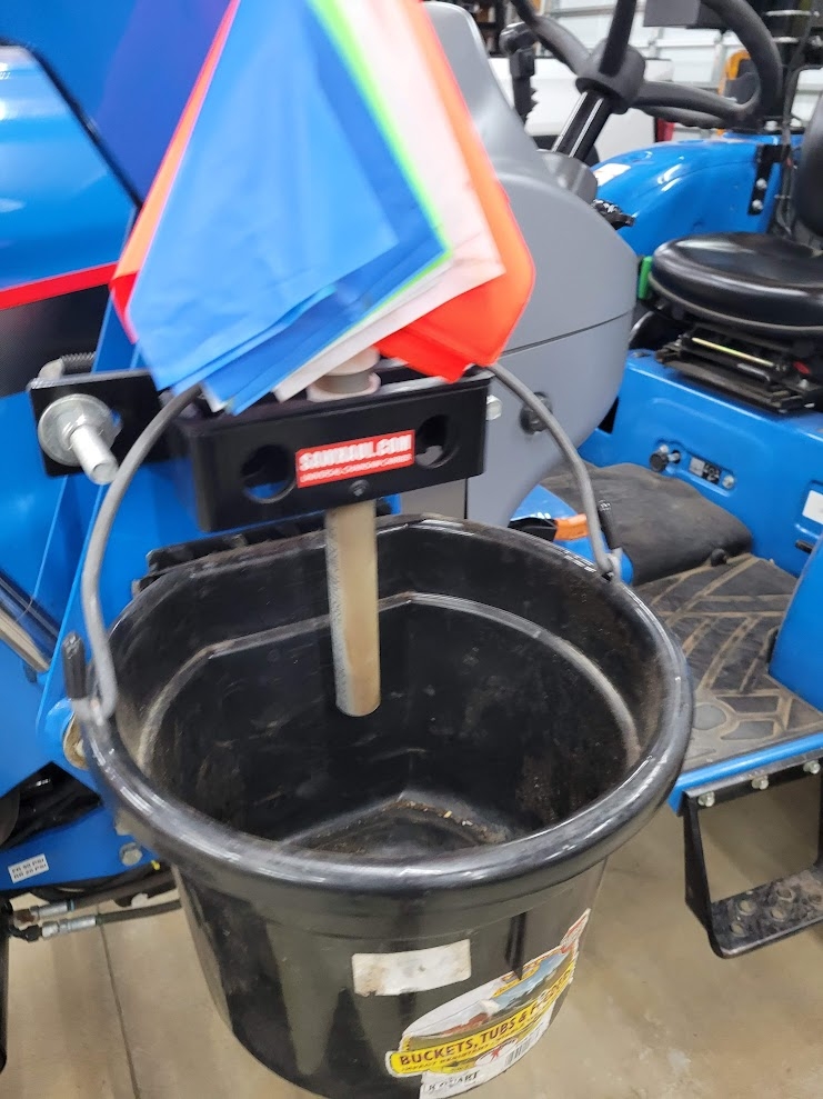

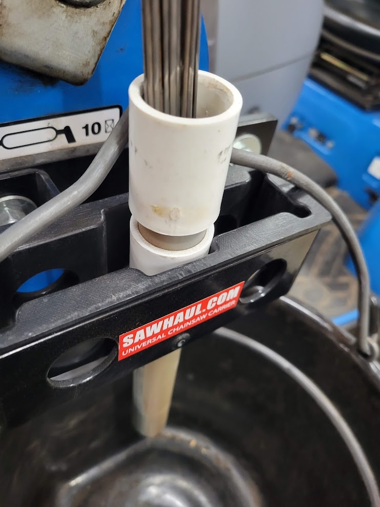

We mark a fair amount of things that need attention with flags, and I needed a decent space to store them. Blue=holes to fill, green=stuff to grind, red=ants to kill, white=anything else to grab our attention.
I also often need a little trash/parts bucket, and I had been struggling with where to locate both until this just worked itself out.
I have a sawhaul that works great, but I don't often carry a saw, so while not in use, it holds flags and a bucket just right.
Used 3/4 PCV and a few couplings, 1 so the PVC doesn't fall through the bracket, and the second just to raise it to the correct height and finish it off.
The flat back bucket is from Tractor Supply, https://www.tractorsupply.com/tsc/product/fortiflex-flat-back-bucket-2-gal-capacity-sapphire-blue
I put a piece of rubber on the tractor behind the flat bucket, as it bounces around a bit and could scratch the paint.
I've been running like this for a little while now and it has worked out very good.
