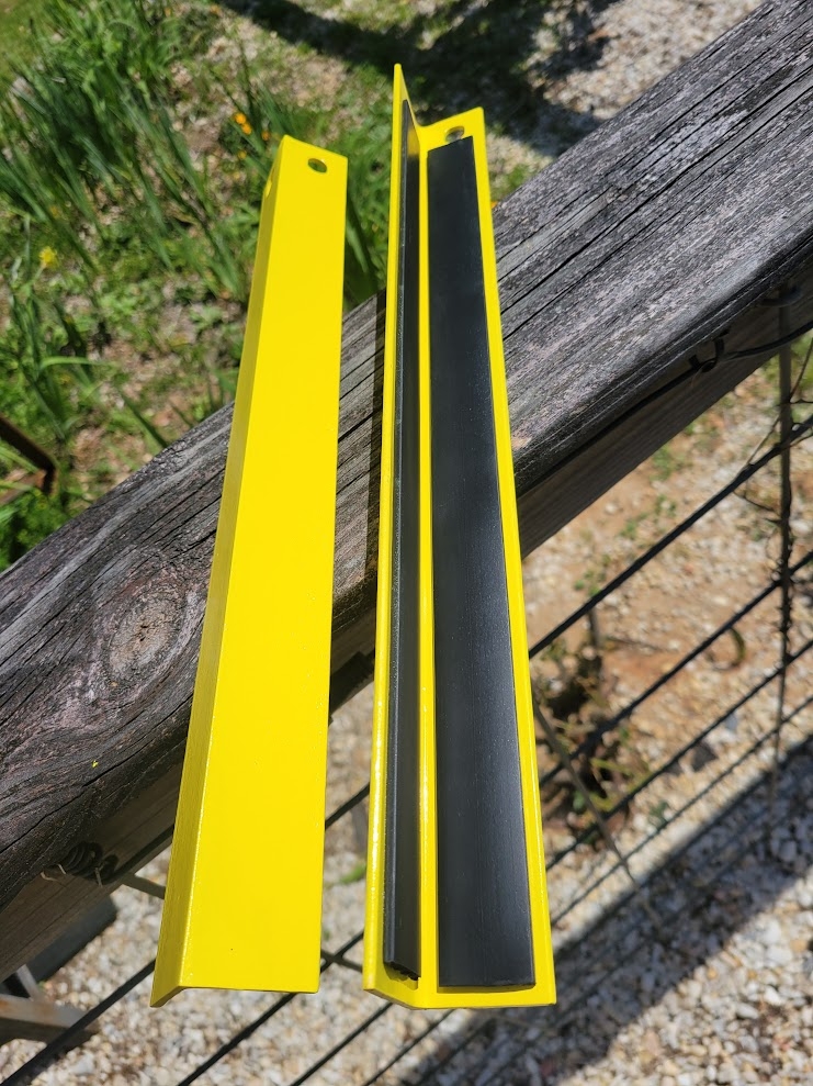

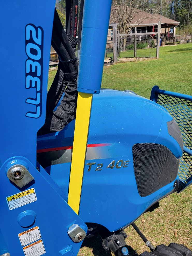

The stump bucket I bought was shipped in a crate made of angle iron. I cut off a couple of the legs and made some FFL Cylinder Safety Stops. Cleaned up, primed, painted and added some rubber where it meets the piston rod. I'd use zip ties to hold them in place when in use.

Thats a really good idea! You could also add some pull type lashing straps to the angle iron in place of the zip ties. Permanently affix the buckle end to the outside of the angle iron, run the strap around the cylinder and through the buckle, pull tight. Could use something like epoxy, JB Weld, or maybe a rivet, on the buckle.
I got some scrap iron hanging around, I might make these too! Maybe rubber coat the ends to help prevent scratching? :unsure:

both the rubber on the end and the strap are good ideas!

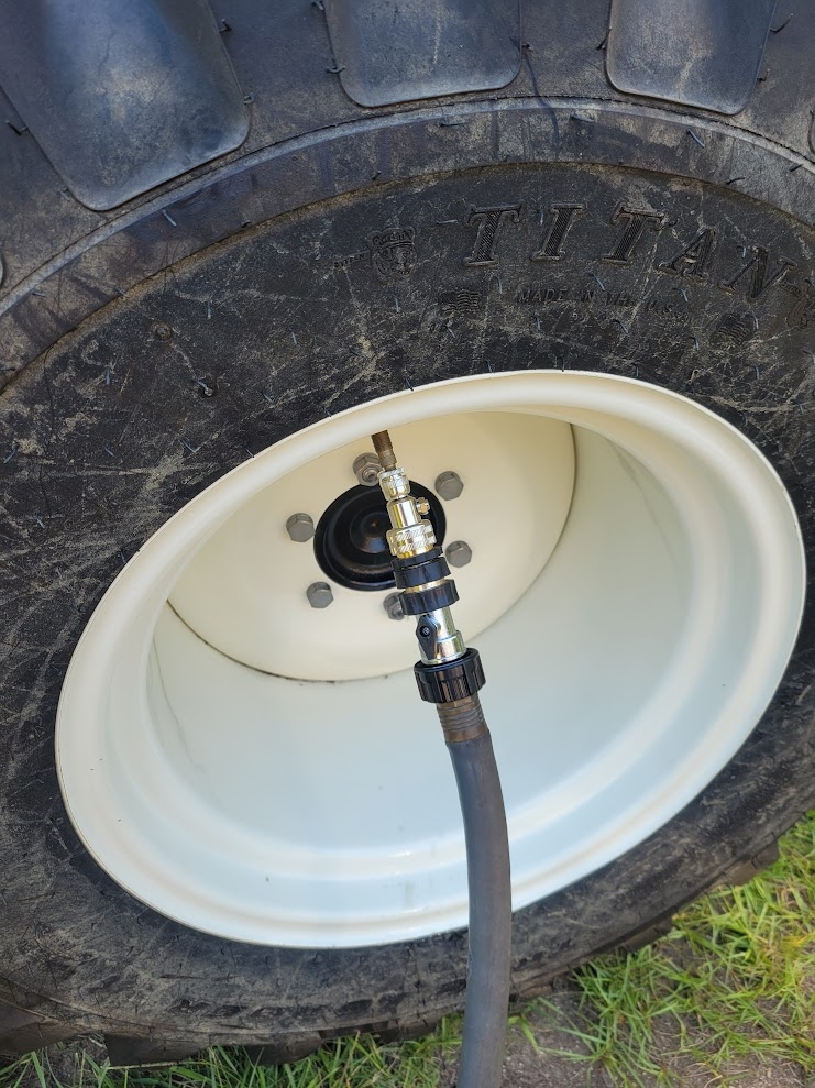

Noticed the dealer only filled my tires half way, so I added more water today. I'm in southern AL, we just use straight water here. Left enough head space to check the pressure without getting water in the chuck/gauge
Bought this adapter for $12, worked great Amazon.com I'm sure you could pump any fluid with it.

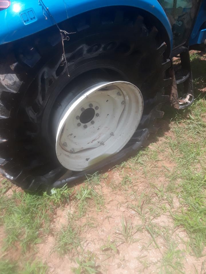

Speaking of tires...backed over an old split cherry or mimosa stump this afternoon when clearing for the power company to set their poles.
This is the result. Antifreeze spraying everywhere. I thought i blew a hose until the tractor leaned way over on that side. Good thing I wasn't on a side slope. Back tire on MT573.

Oh no! That's a mess, ugh.
