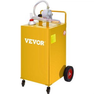

Bought it a drinking fountain.
iu
I've been using a 55 gallon plastic barrel strapped to a pallet, but it's very old and I'm getting concerned about it cracking. It's a translucent milk white material and the red fuel easily shows the level, which is the one thing I liked about it.
At least this one has a float gauge unlike some of the others I've seen. The wheels make it easy to move around on a hard surface, but probably won't work well over turf. Thirty five gallons will get me through most of a year.

So is some outfit going to deliver the fuel to your place ? Or are you going to haul the 35 gallon tank to a station and fill it yourself ?
Sounds like a nice setup but when it’s full not easy to load into or out of a pickup truck.
   / What did you do on or to your LS Tractor today?
#2,569
No, won't be doing a pick up truck.
I have a trailer I can load it on. Should wheel on easily. Off ... I'll just have to try. Tank is 80 pounds empty and full, I figure it'll be close to 400 pounds.
Wheels on it are solid. Ramps should make it easy to get off the trailer. Wheeling it across the turf to the shed might be an issue. I've figured out that it's compact enough to fit in the corner of the garage if necessary. Diesel isn't volatile like gasoline, so less of an issue in heat.
But if nothing else, I'll pull the wheels and bolt the whole thing to a pallet and load/unload the same way I do the plastic barrel I've been using.
They won't deliver less than 3-400 gallons. I've been getting it from my neighbor who gets it delivered, but he's getting up in age and losing his health, so I need to break away from that.
