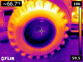

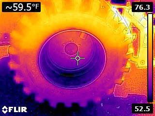

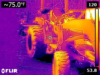

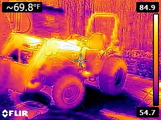

Filled my tires. I though it would be easier to buy a drum of Rim guard and fill them myself than haul my tractor to the dealer. It was super easy, definitely less grief than transporting the tractor. I just pressurized the drum with compressed air to push the fluid. The only problem is I needed ~ 60 gallons to fill the tires and my drum was only 55. I pumped roughly half the drum into the right tire and then pumped the rest into the left. I wasn't sure how to tell how full I got them, but then I thought to bust out my FLIR. The FLIR gave me the x-ray vision I was looking for. The Liquid is slightly colder than the air and it shows on the camera.
