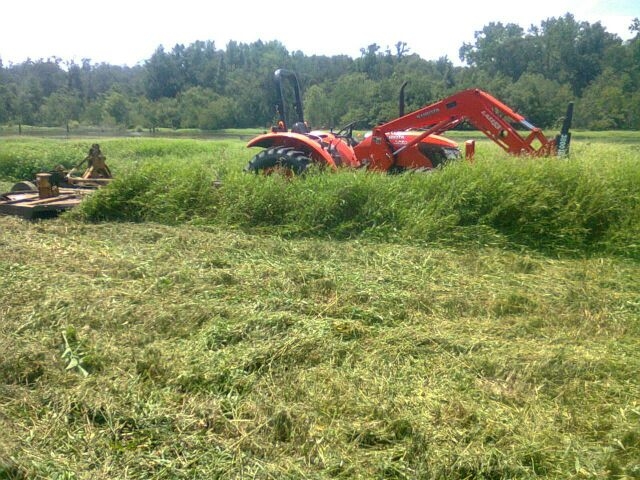

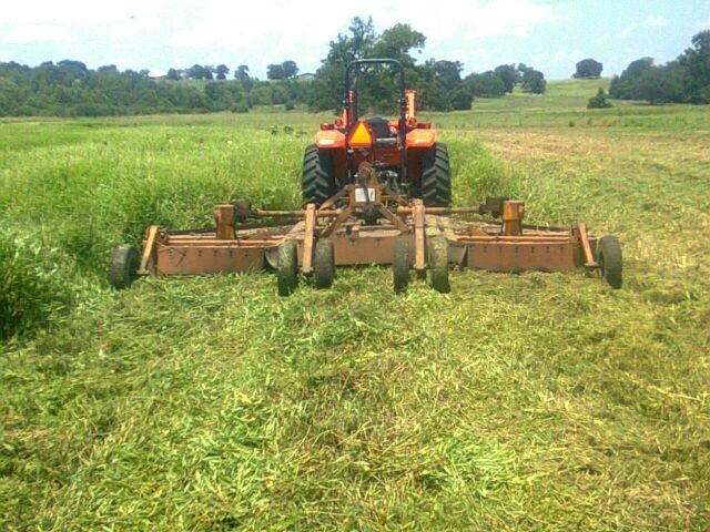

But did do alittle mowing cple weeks back. mowing bottum 4.JPGmwing bottum 3.JPG

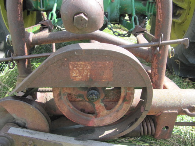

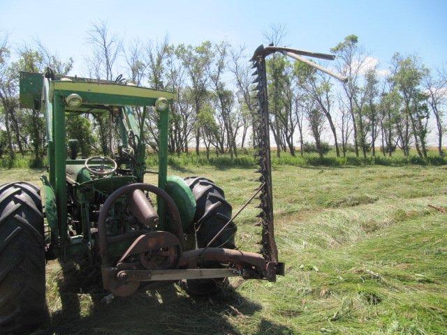

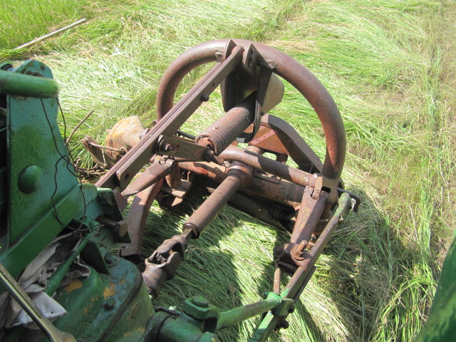

As promised yesterday, I took some photos of the mower I reclaimed off the scrap heap. Sadly, shortly after, it broke down and now I need help identifying what make it is. On the first photo you can see where there used to be a decal (maybe?). The next one shows how the mower hitches up to the 3pth. Third, ready to head to another field with the sickle in the travel position. The last photo is of the broken bits from the pitman arm. I suspect that trying to weld them won't work. They look like some kind of cast metal. As for any identifying stamps on this machine, the only one I have found is a stamped "DH" on most of the fingers of the sickle bar. Any ideas on who built this mower and how I should try to repair it? I realize I probably should ask the repair question on the "Parts and Repair" forum. Meanwhile, I have just 2.5 more acres of hay to cut and my mower is busted:banghead: The brush hog is starting to look like the Plan B.

You might check out this site for a replacement this is an IH Pittman strap - looks similar - dont know about the ball size etc. tho. At least its a starting point. Pitman Strap Back IH - Mower Parts - Parts Webb's Sickle Service
I think if you welded that then added another hole maybe and used a U shaped piece of steel wrapped around this pittman it might stregthen it enough? Dont know the clearances you are dealing with.

I would just weld that one back together, maybe put on a little reinforcement strap on each side and it will be better than new.
