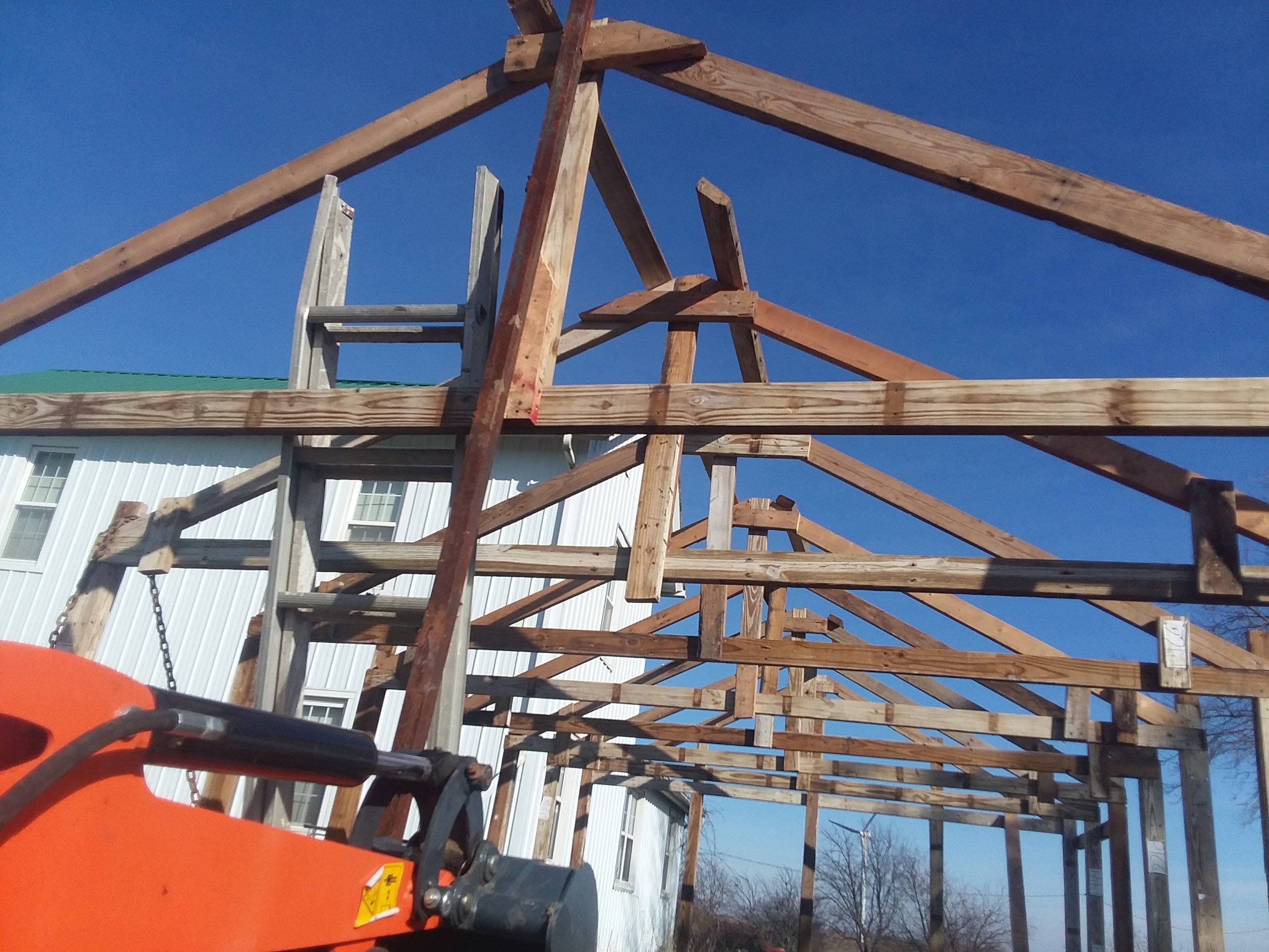

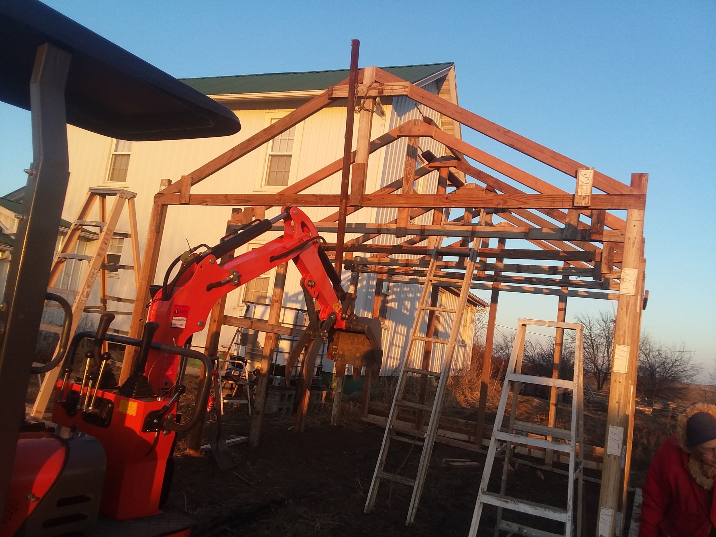

used mine to set rafters on the greenhouse,--course had to cheat and bolt an angle iron to the side of the bucket! lol! I just used the tooth holes and drilled the angle iron the same hole size. Bolted it on with the tooth bolts. I HAD to take the teeth off to get the bucket to dump dirt anyway. I made better extensions for the bucket that dont bother when dumping. The worst problem I have is bending the teeth. They are soft as butter! Anyway I have a plan to add square bars on each side and shape them to a point on the leading edge then harden them by heating them in the forge like I do plow shares.
Anyway a couple pix of the rafter setting.

Nice work.. These minis are really handy, especially if you get creative..

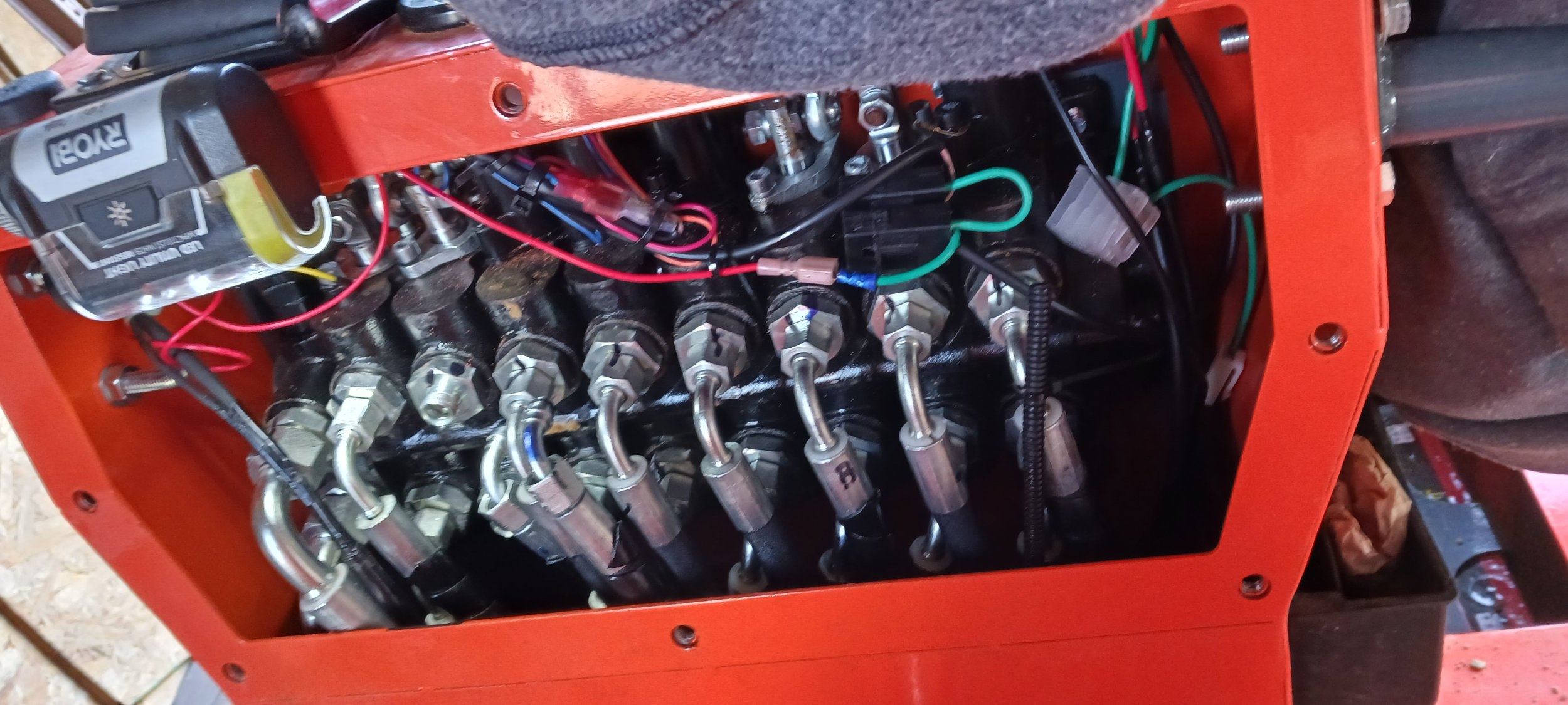

Finally, I did the ISO to ASE controls swap. Not as easy as I thought it would be.

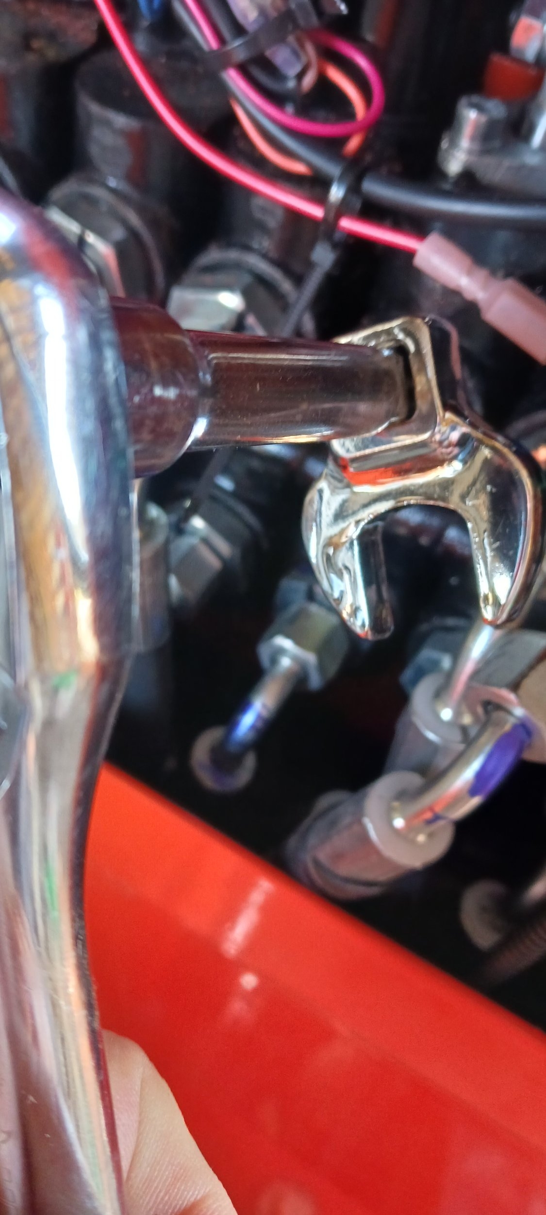

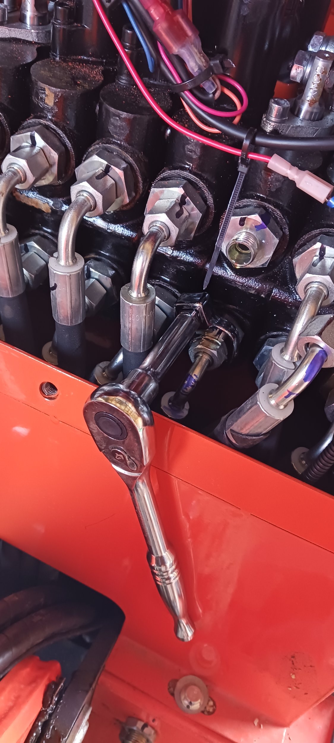

If you need to remove hydraulic lines from the stack valve, you may need a 17mm crows foot. I had to buy the entire set just to get the 17. really helped to get the lines off.

I pulled the sheet metal off when I switched controls, which made it fairly simple. Pulling the sheet metal off was a bit more work.
