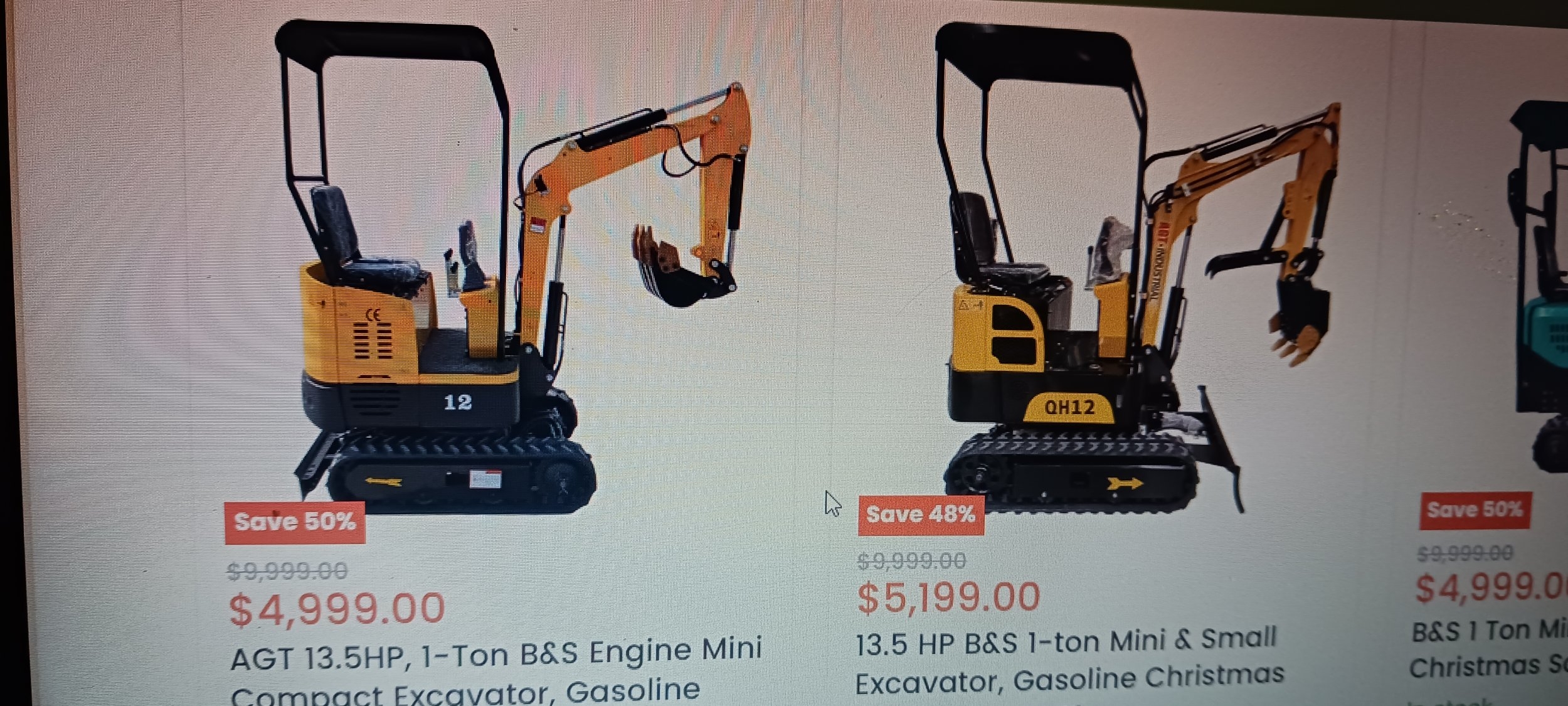

There's a dealer nearby who has the Agrotk L12 or the QH12 for slightly under $6,000 and the Agrotk H12 for $6,650. The specs at first glance look very similar. Any idea if the H12 is worth the extra money?
It would be awesome if there was a way to add a brush cutting head.
AGT in Chicago has the H12 for 5000 delivered. In my opinion, the L12 is superior. You should know that the L12 had a defect in the hydraulic system. It should be corrected now.

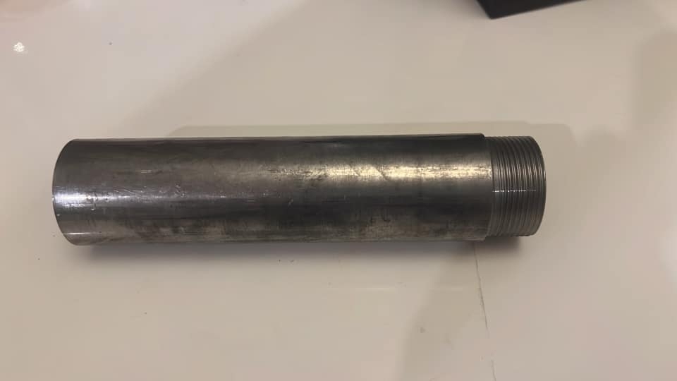

What should I look for to avoid the hydraulic defect?
The L12 hydraulic tank needed an extension tube for the pump inlet line. It was discovered that the pump may cavitate when on an incline. The factory has sent one to a member here who has an L12. I have not received one yet.

I did not get any manuals with my machine. I saw something on the website about 30 percent slope. I am looking for the pic of the fix for the hydraulic issue.
This is the fix for the L12. I would hope that any machines bought from AGT in Chicago have the fix already installed, but no guarantees there. If I was going to order the L12, I would have them send the extension tube with the machine. Hopefully you dont need it, but if you do you have it ready to install. This is a good time to tell you this, if you dont enjoy repairing and improving things, these imports may not be a good fit for you. Also, there is a good chance that the longer you wait, the better the deals will get. I hope this helps..
