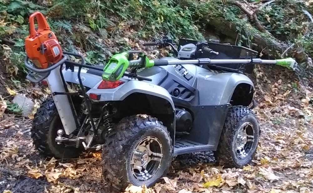

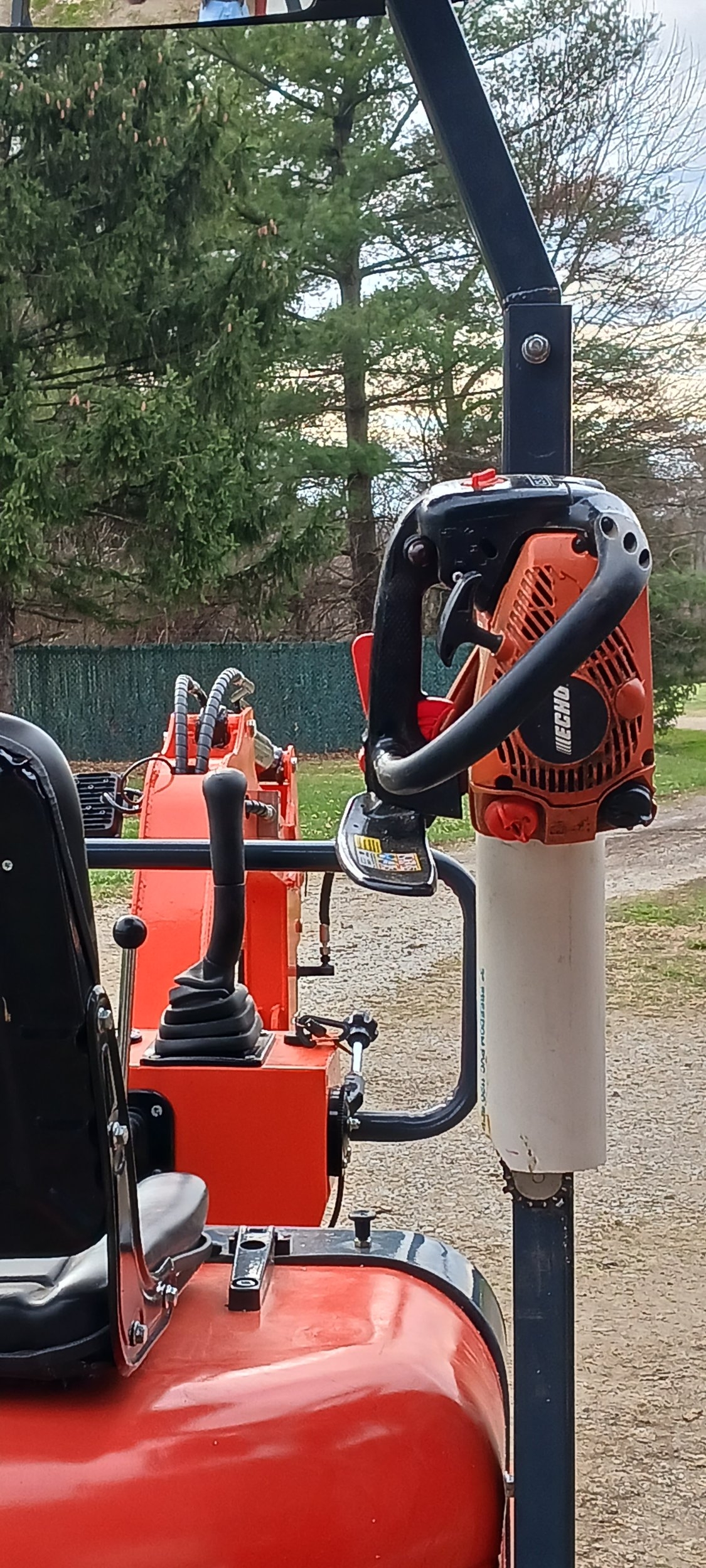

Here is the Latest mod. very handy for me since I am always clearing trails.
   / What did you do with your Chinese baby digger today? #43
Looks like a CS-330T. Your install shows the advantage of rear ROPS columns. Nice. With my front columns, anything big that I might attach would be in the way of getting on/off or getting snagged by branches.
My trail-building approach is I leave the mini where I am working it, and ride back and forth in my ATV with 2 chainsaws.

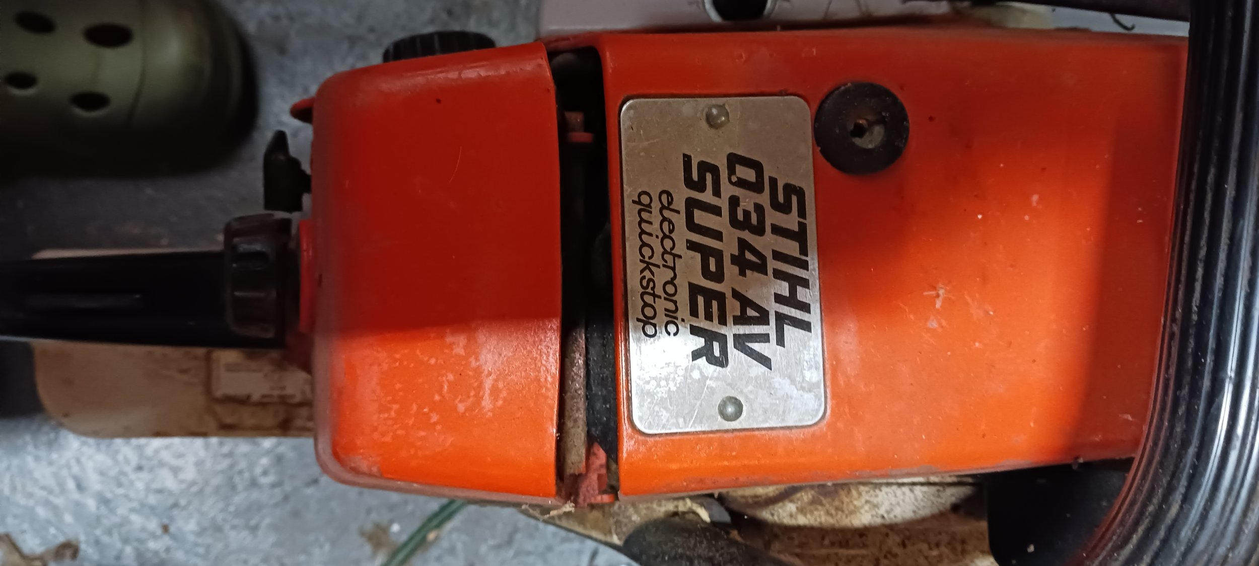

I think on your thread about these baby-X, I mentioned the white bushings with no grease holes, but there was a zirk. So yesterday I drilled them out . Very easy drilling and grease goes in and comes out both sides. I was surprised to see those bushings, all others are metal. Years ago I worked maintenance and sometimes made parts from a white plastic material that was incredibly durable. I cannot remember the name. Do you know if your leak was caused by a hit from a rock or limb? I really need to g20231228_073923.jpget busy on making guards for my machine... As for chainsaws, I love them, apx 6 stihls, 6 echo and 1 makita. several poulans. My favs are the lil echo climbing saw you mentioned and my stihl 034 super.
