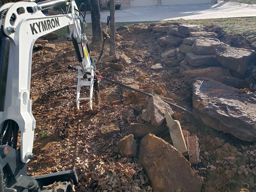

I have been tearing out a jumbled up stone wall and trying to re-stack best I can. Needed to level up a BFR and the Kymron was just like having a buddy there.
Very impressed with this XH14. Plenty of power. Surprises me what it will grab and lift. Only 5.5 hours on it so far, but pleased. Did pop one of the tracks off in the first 90 minutes so now know to keep a close eye on them until they are broken in. Have tensioned them 4 times now in the last 4 hours of use.
I did a little research on the Kymron. They seem to be a well designed and very capable machine.. How is yours doing? How many hours?

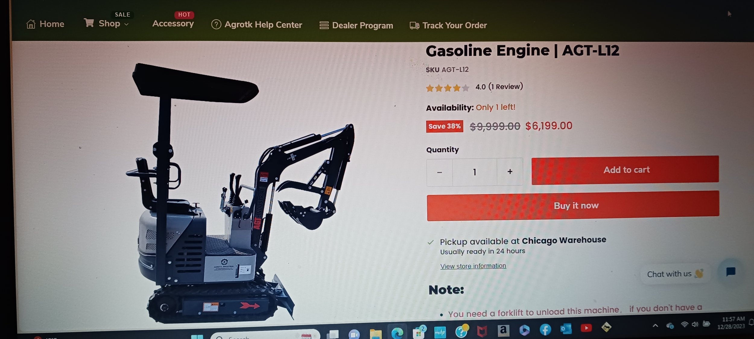

I see a dealer option to add a hydraulic thumb to the L12 that is for sale locally for $650. Is that a good upgrade or really not necessary for moving brush and larger rocks?
I just found a few good vids from this guy on you Utube, The Garage Connection He has a H12 and goes over a few things that may help you with your decision. I cant download the vid to the site here. I tried. operator error
