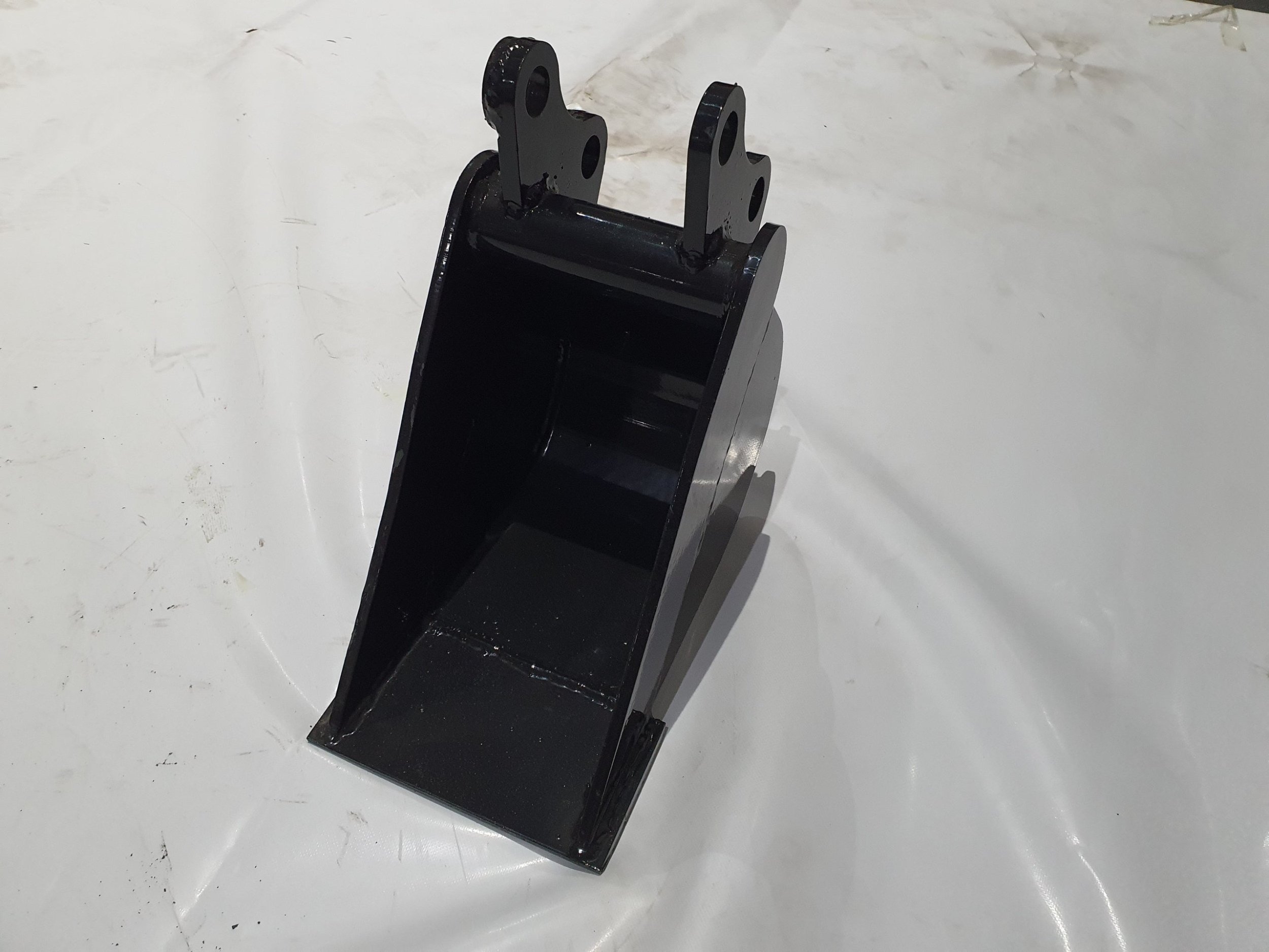

I have been looking for an 8" bucket and I just ordered one from AGT. I was on their website looking for the hydraulic pickup tube extension. Out of stock on the ext, but I found this bucket for $165 tax and delivery included. seemed like a great deal. Will let you know when I get it.

I have been looking for an 8" bucket and I just ordered one from AGT. I was on their website looking for the hydraulic pickup tube extension. Out of stock on the ext, but I found this bucket for $165 tax and delivery included. seemed like a great deal. Will let you know when I get it.View attachment 855082
Update: I got a text from AGT in Chicago about 2 hrs after I placed the order. It said order has been shipped and had UPS tracking number. I accidently sent a text to AGT that my package has shipped and that is great customer service,( text was meant for my wife). A minute later I get another text from AGT thanking me, and asking if there is anything more I need?
I mention my trouble getting the hyd extension tube for my AGT L12, I tried to order but they are out of stock. He confirmed they are out of stock, but he reserved 3 for customers that purchased their excavator directly from them. He offered to send me one if I still wanted it. Yes, I replied. he added one to the inventory and I ordered it and a few minutes later I got the text with the UPS tracking #. That is great customer service. If I was looking for a 1-ton, I would get the L12 from AGT in Chicago or California.
