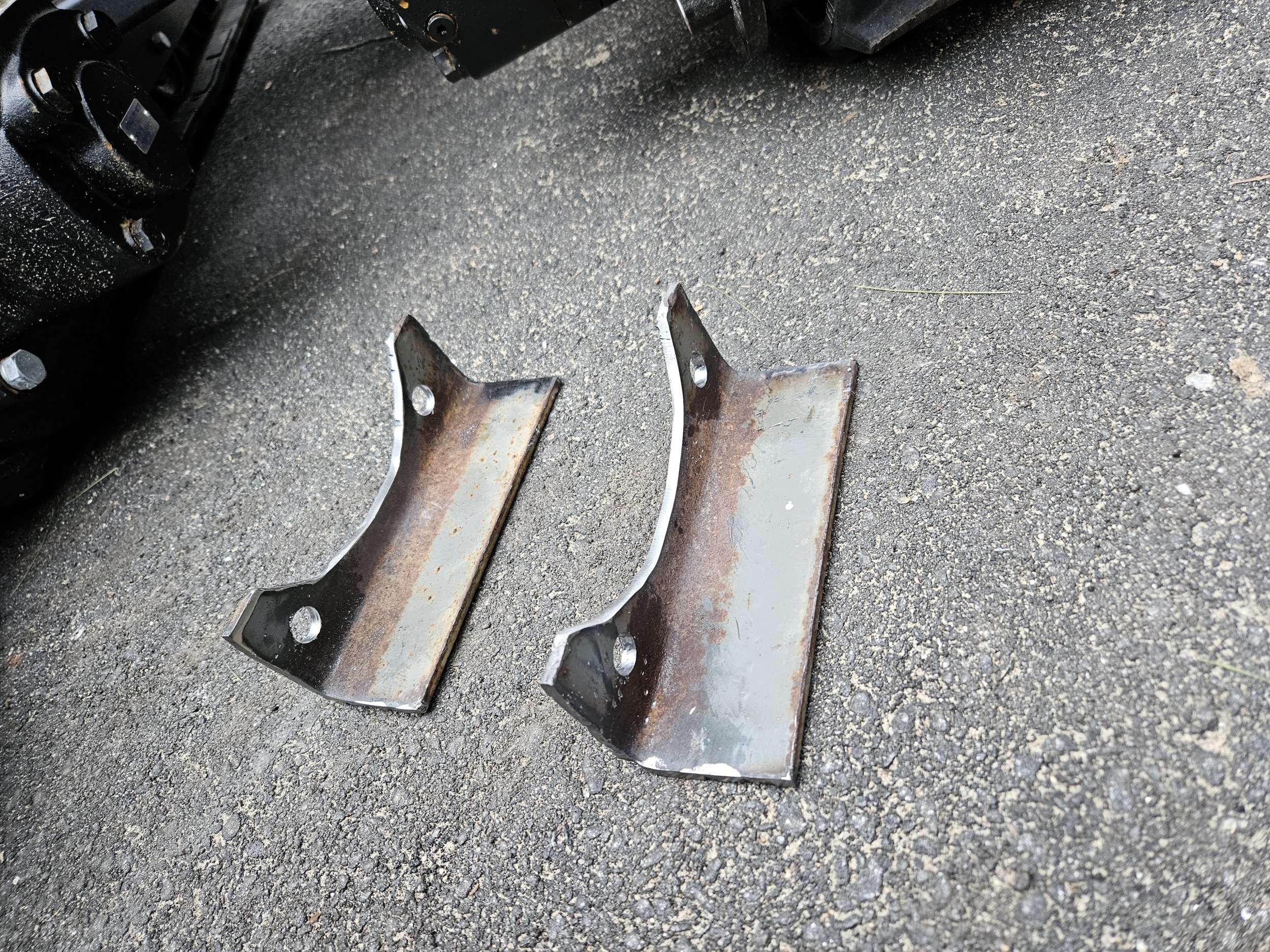

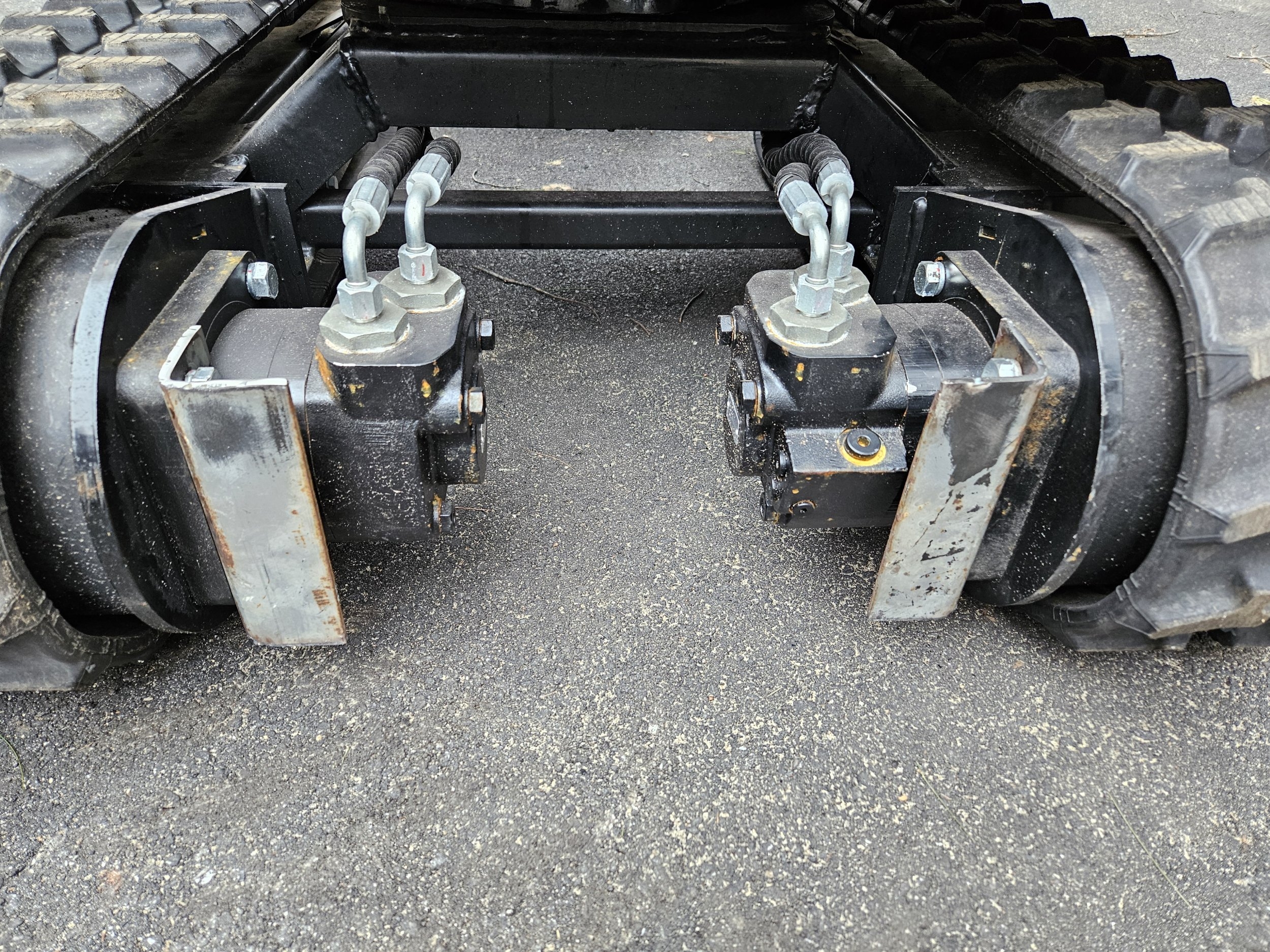

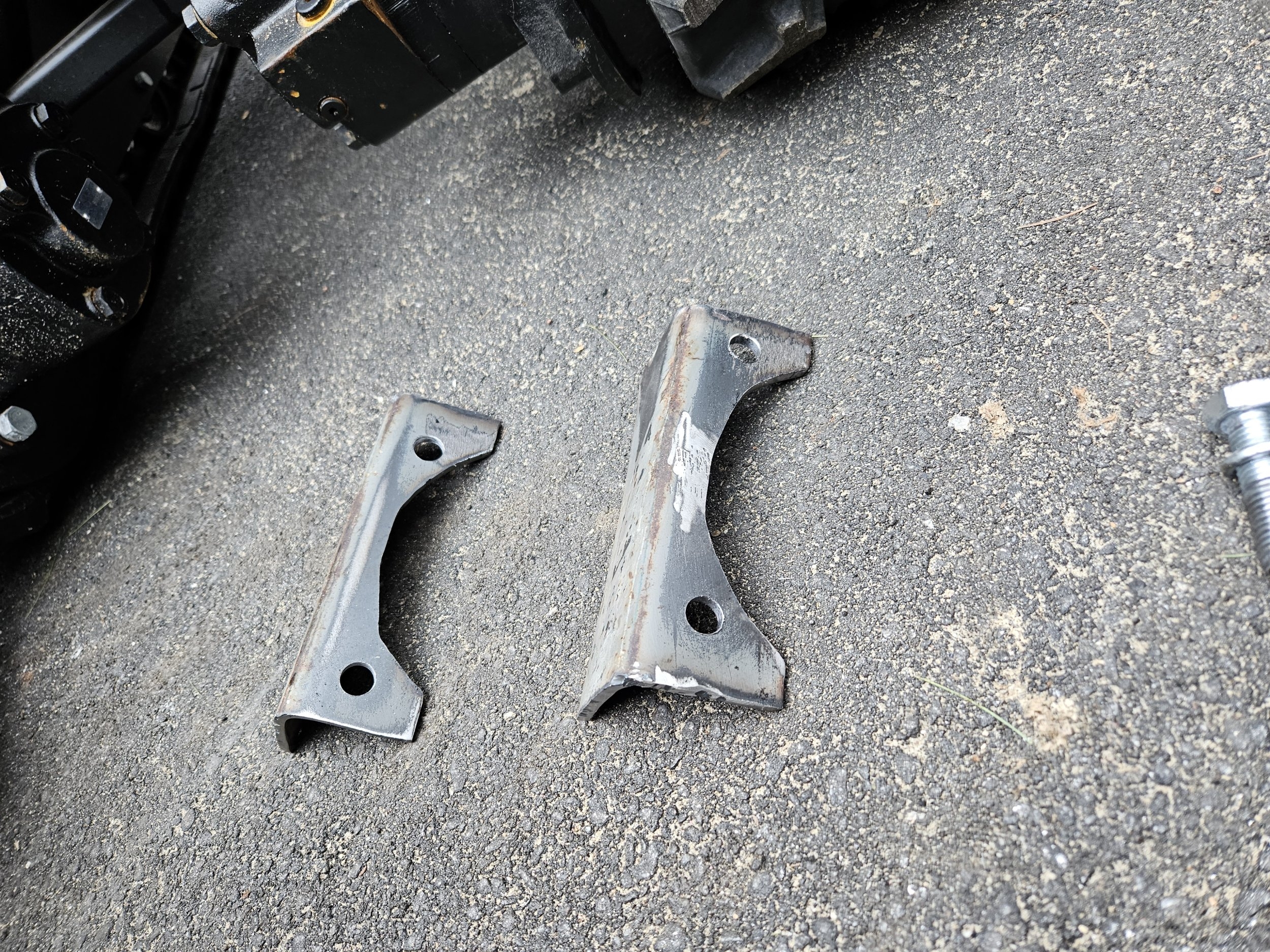

I've been working on making a crossbar to run between the drive motors to protect them and prevent the housings from bending out like I've seen in a few posts. This is the first metal fab project I've ever done but so far it seems to be going ok. I've got the brackets built and bolted on - now I just have to weld the crossbar between them. I've attached some pictures of the project so far.
Don't forget to integrate some hose protection into your design. Looks good.
Looks good.. How did you get the holes marked in the right spot before you drilled them?
Did you measure and mark them, or did you have a template?
   / What did you do with your Chinese baby digger today? #434
I made a template with a heavy piece of cardboard. I was actually pretty surprised when the holes lined up - I was figuring I'd end up having to hog them out. I took it off to do the bulk of the welding and paint. I'll post another picture when I get it mounted back up.

Between the bosses behind the bolts is 20 1/2 to 20 3/4 as near as I can measure on mine.
I tried to make a yellow line to show the points to measure from. This is same on the front side as the back.
Finally got around to measuring the track motor mount rails, I am 20 3/4, so both yours and mine are still straight. Thanks again!
   / What did you do with your Chinese baby digger today? #438
Ya 20 3/4 is closer on this one too, --- hard to measure with tape measure in 45 mph wind but I checked again yesterday and they are 20 3/4 for sure.
#439
Thanks for verifying. I didn't want to make up a reinforcing bracket until I made sure it's not already bent a little.

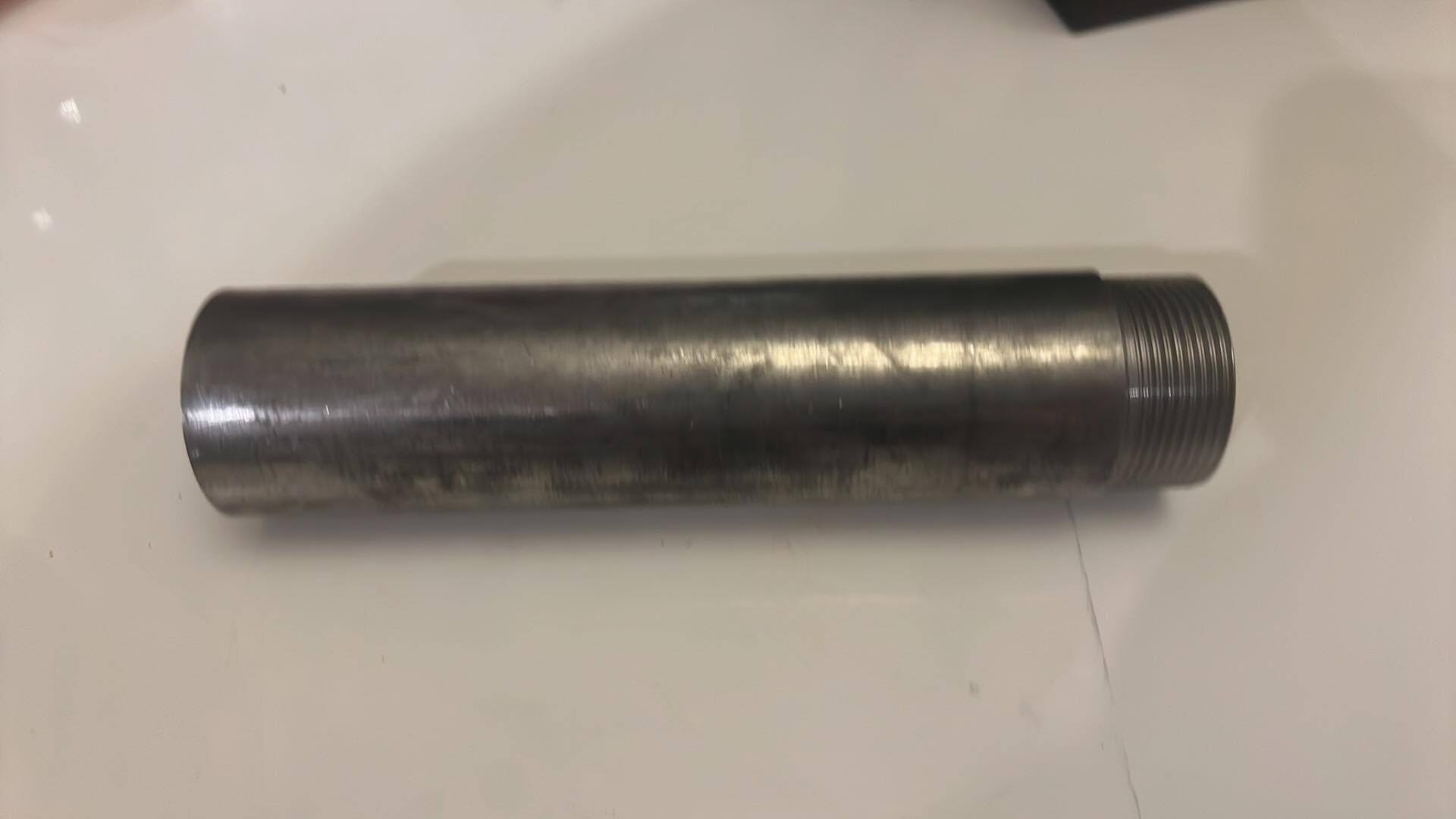

Have you ordered a hydraulic tube extension that the L12 needs?
   / What did you do with your Chinese baby digger today? #440
Wasnt aware of a tube. Where do you have to get them from?
