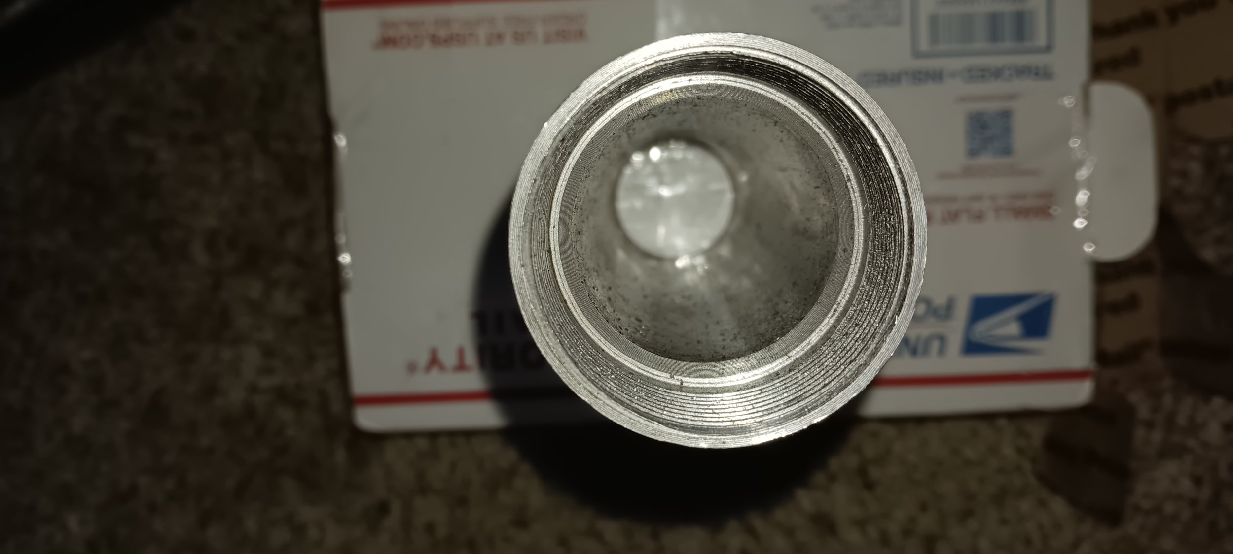

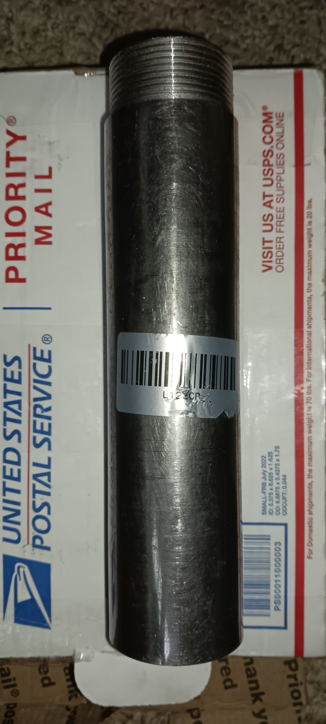

I ordered this hydraulic ext tube on March 2 from AGT. It was in the mailbox today March 6. I can finally get the hydraulic oil changed, and install my filter. 20240306_140139.jpg

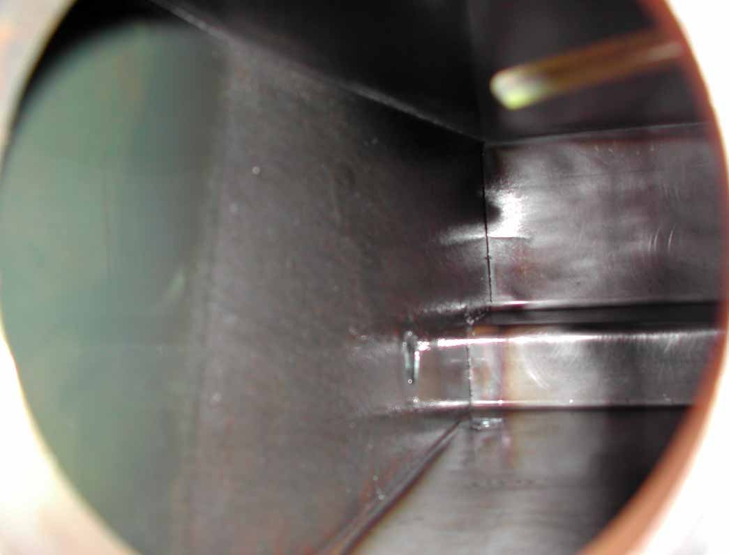

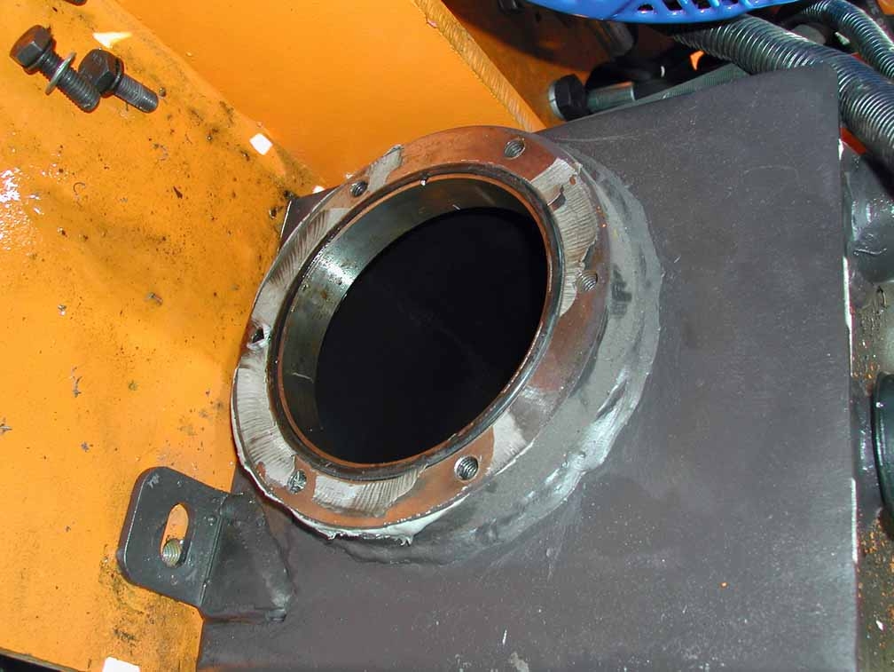

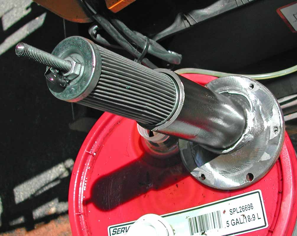

Yeah, it is not clear to me how it is supposed to work, and why the tube is threaded. I posted these pix a long time ago, and my setup uses a long threaded rod, welded at one end, to hold the tube and strainer together. The tube in my photo is welded to the cover plate.
Isn't the tube there just to keep the strainer centered at the bottom middle of the tank?
The end of the suction strainer is threaded and screwed onto the fitting in the tank. Remove the strainer, screw on the extension to the fitting in the tank. screw the strainer onto the ext. The extension has male threads on one end and female threads on other.20240306_140148.jpg
