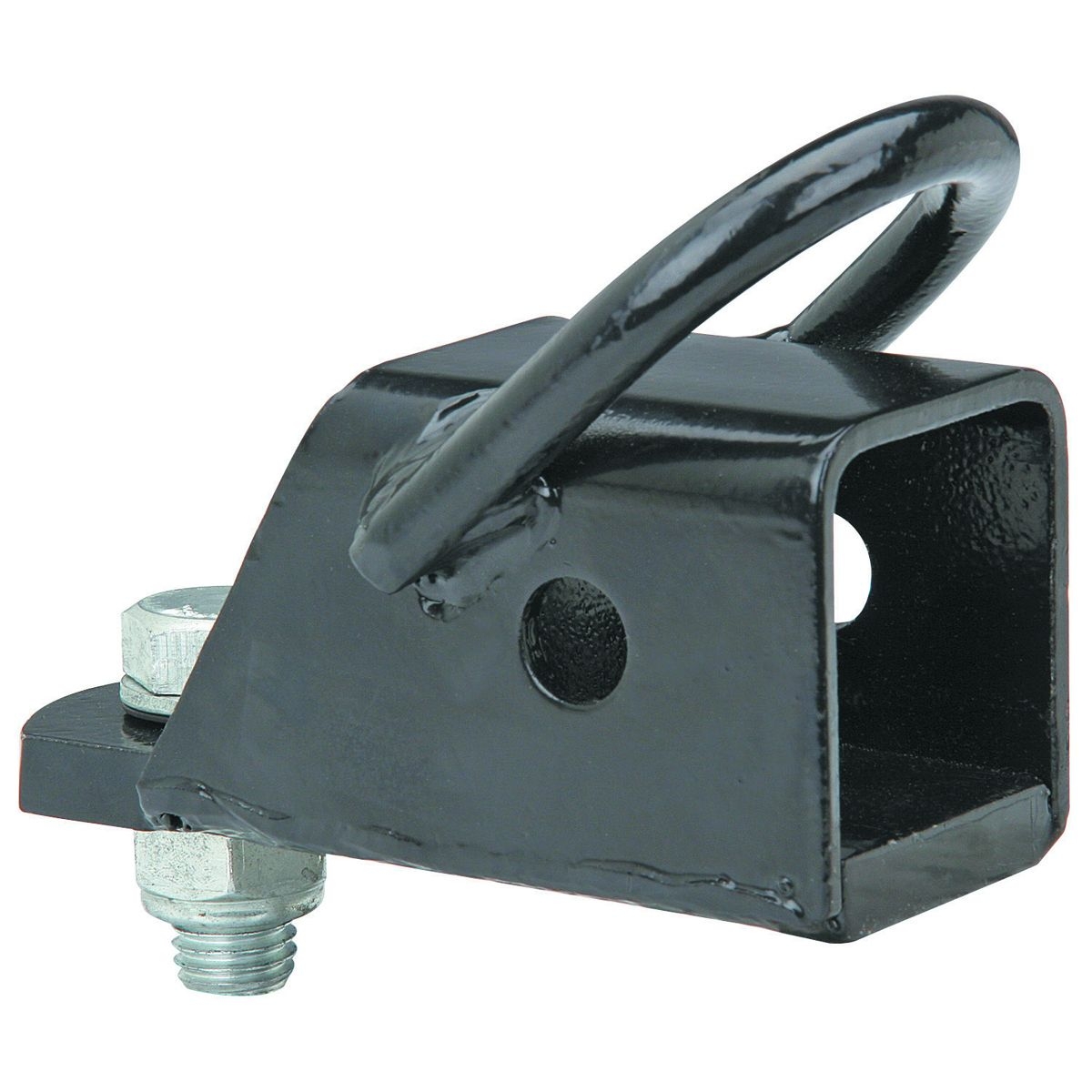

I would think you could weld one of these $13 receiver hitch tubes to the frame reinforcement. I welded one to my FEL bucket. It makes a nice chain attachment point. ATV Hitch Adapter
Those are really nice to have around. you cant beat the price. image_16621.jpg

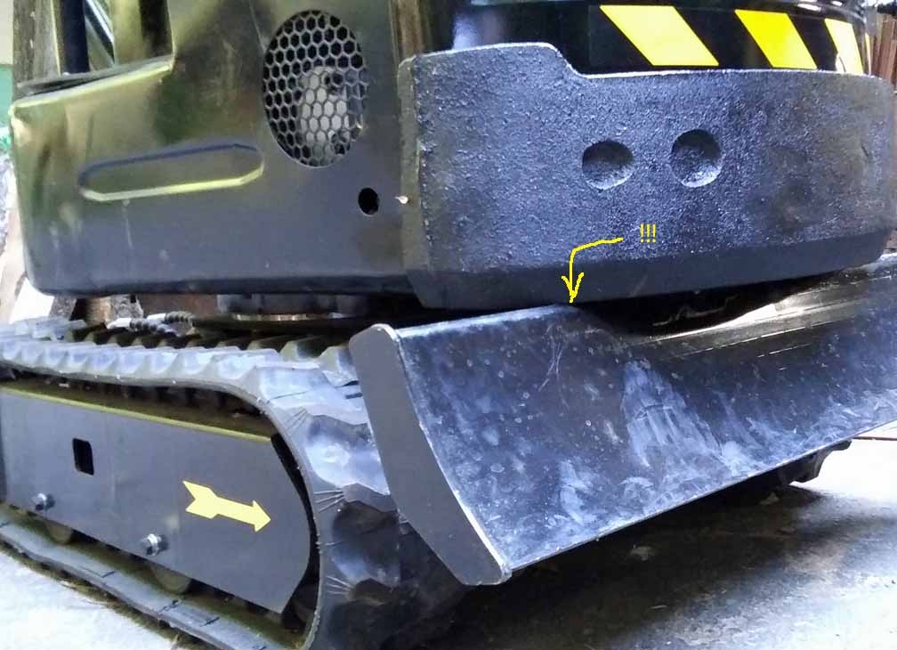

The easiest way is just welding a steel bar to the frame, of course. I have yet to hear about any bent frames that have the newer wrap-around frame reinforcement.

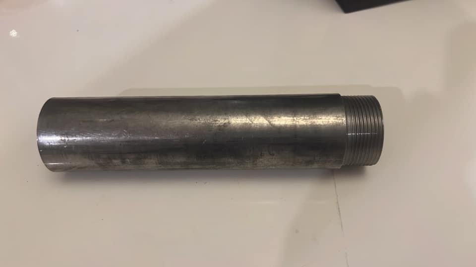

There may be some owners who'd be interested in the measurements of that pickup tube if it is something they could fabricate themselves since it's not currently in stock.
The L12 hyd ext tube is 41 mm x 190 mm, as near as I can tell. I check the AGT website daily, and I will post here when they are available again.

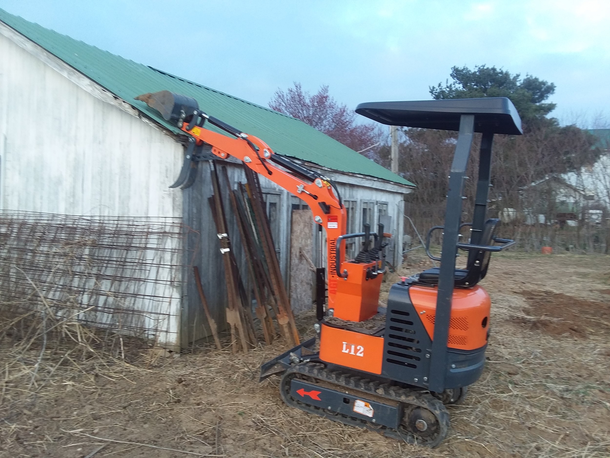

   / What did you do with your Chinese baby digger today? #500
Well,---- damn wind was trying to take the roof off my wood shop, ----- soooo not being able to go up a ladder in this wind, guess whos holding down the fort for a few days???? LOL!
