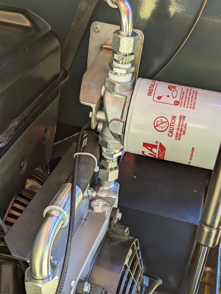

new L12, install filter, change controls to hetero, & new fluid.

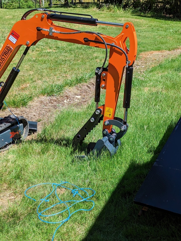

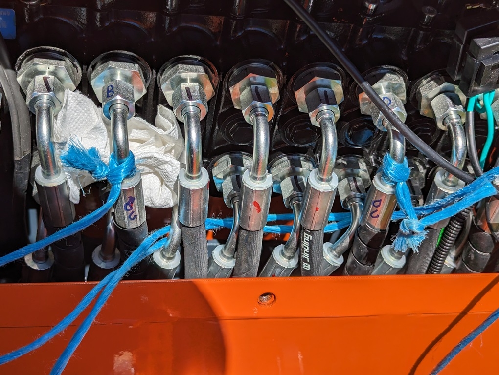

Reconfigured controls. used baling twine to pull them across. also installed hydraulic thumb. getting close to usable now.

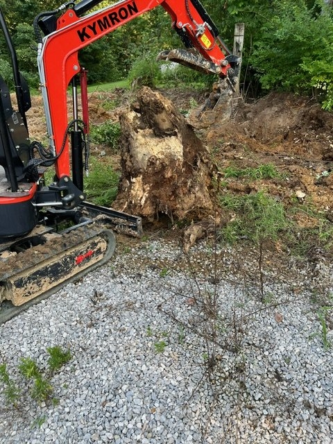

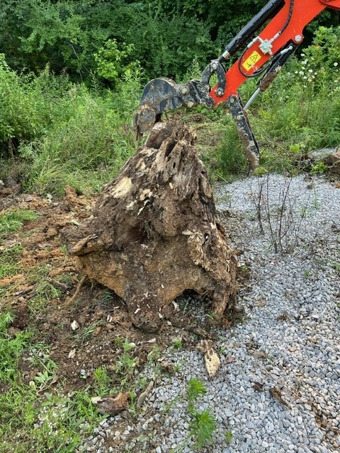

New owner of a mini digger, almost 10hrs. on it so far, sure beats a shovel. First big job getting rid of this rotting stump, took quite a bit of digging.

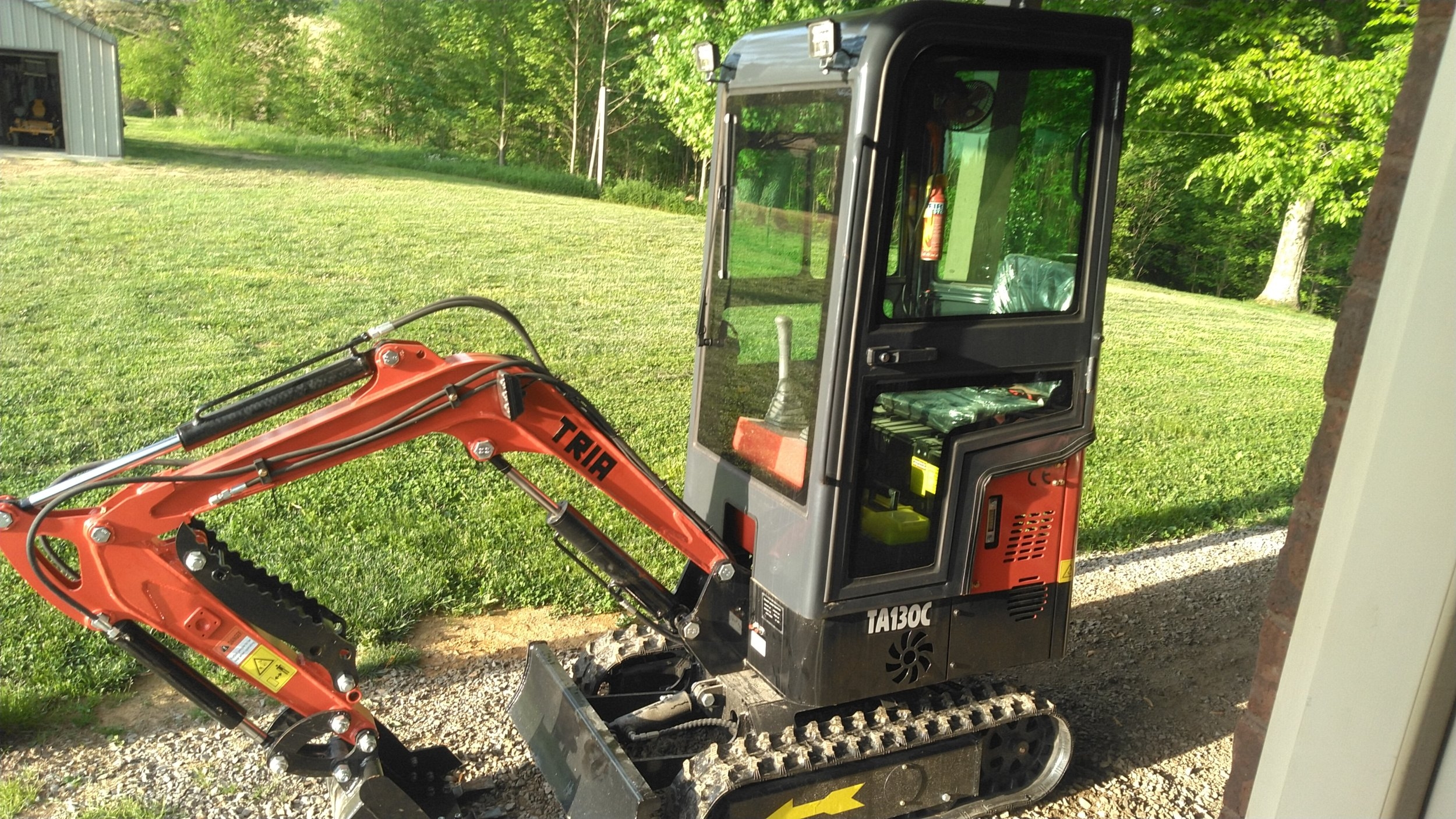

mine came with a fixed thumb, couldn't find a easy to ad on hydraulic cylinder and hose adapters from metric to sae. it took a lot of research and trial and error, but it's doable with a little fabrication and a few hoses.
the hose fitting adapters were so hard to get i bought extras, selling them on ebay!

Did you have to add a diverter valve, too?
   / What did you do with your Chinese baby digger today? #509
Sorry for delay, no this unit had the valve & hoses capped on arm, so i had to find fittings to go from metric to SAE, added quick disconnects for quick removal!

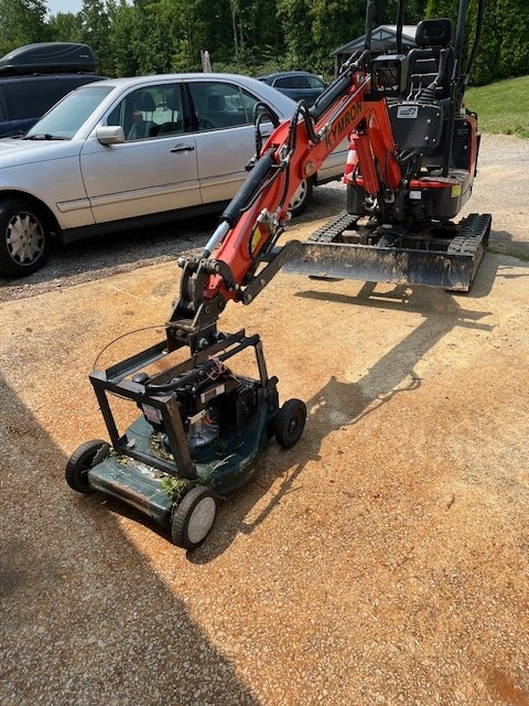

If you strap a lawnmower to your mini ex,…ya might be a redneck…
Needs some changes, wheels need to go and skids added, this was an old bagger only mower I had with a bad motor. I picked up a harbor freight replacement and welded a frame/mount. (I have the quick attach). It probably needs a side discharge too. If it proves to be useful I will weld up a “proper” deck.
