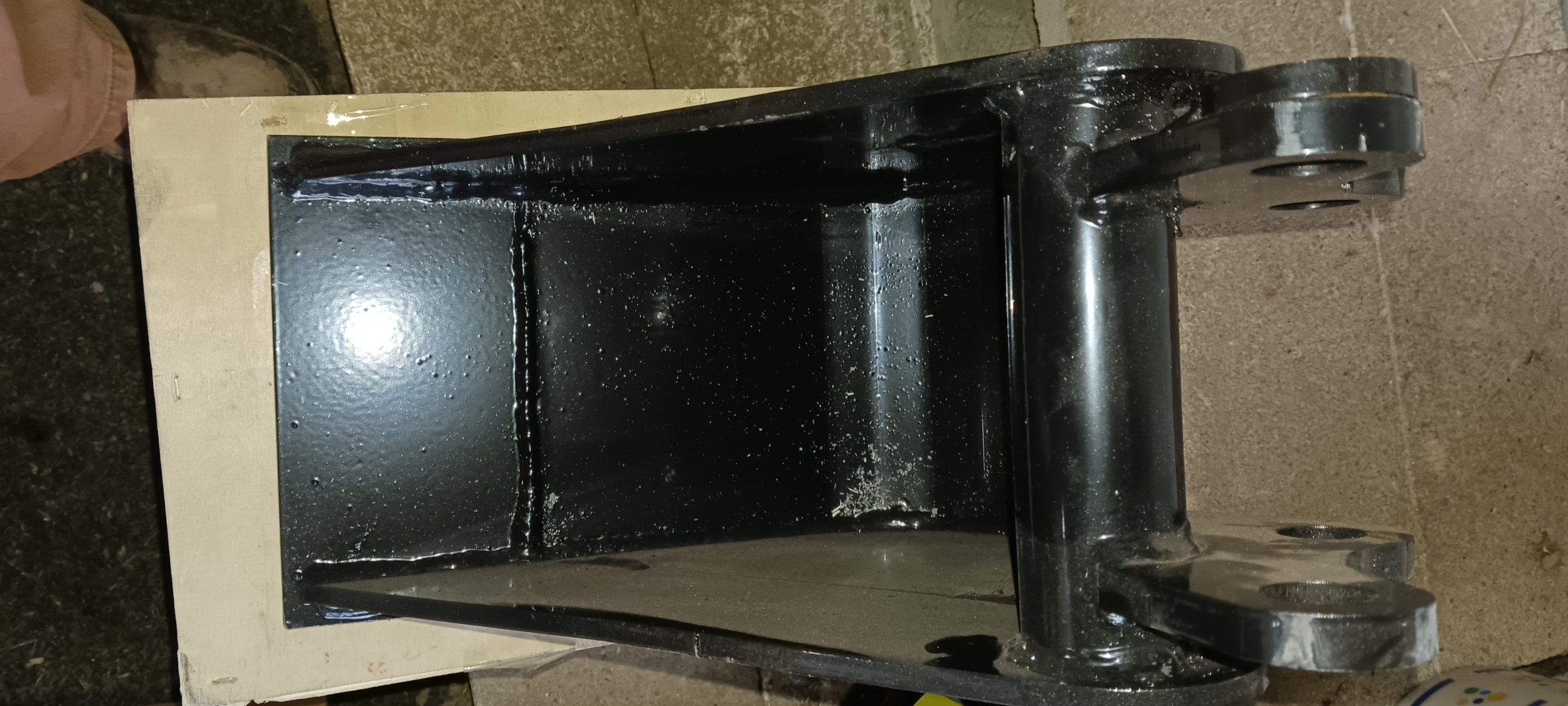

This is what arrived today. Any suggestions on tooth length?
You saw my short teeth, right? They work fine. The much longer single tooth I made for my custom 12" bucket works well, too, but longer must be stronger. Lot more welding so they are reinforced against bending.
I remember seeing the shorter teeth on your bucket, that's what prompted me to ask about length. was hoping you knew the length they extended out past the bucket edge. It looked like about 2" to me.
