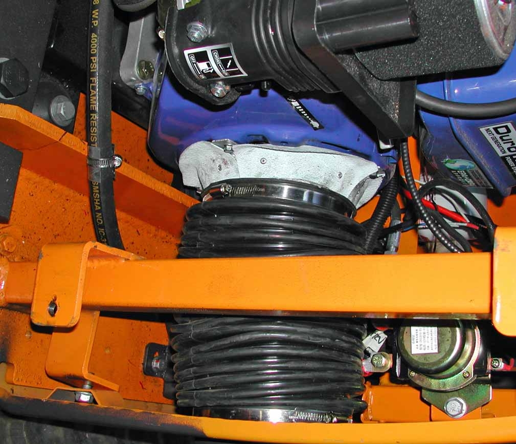

Has anyone found a duct that can be purchased for the 13.5 briggs motors? I've looked a couple times but have not been able to find anything. I have thoughts about making one but that takes more time than I have to spare right now.

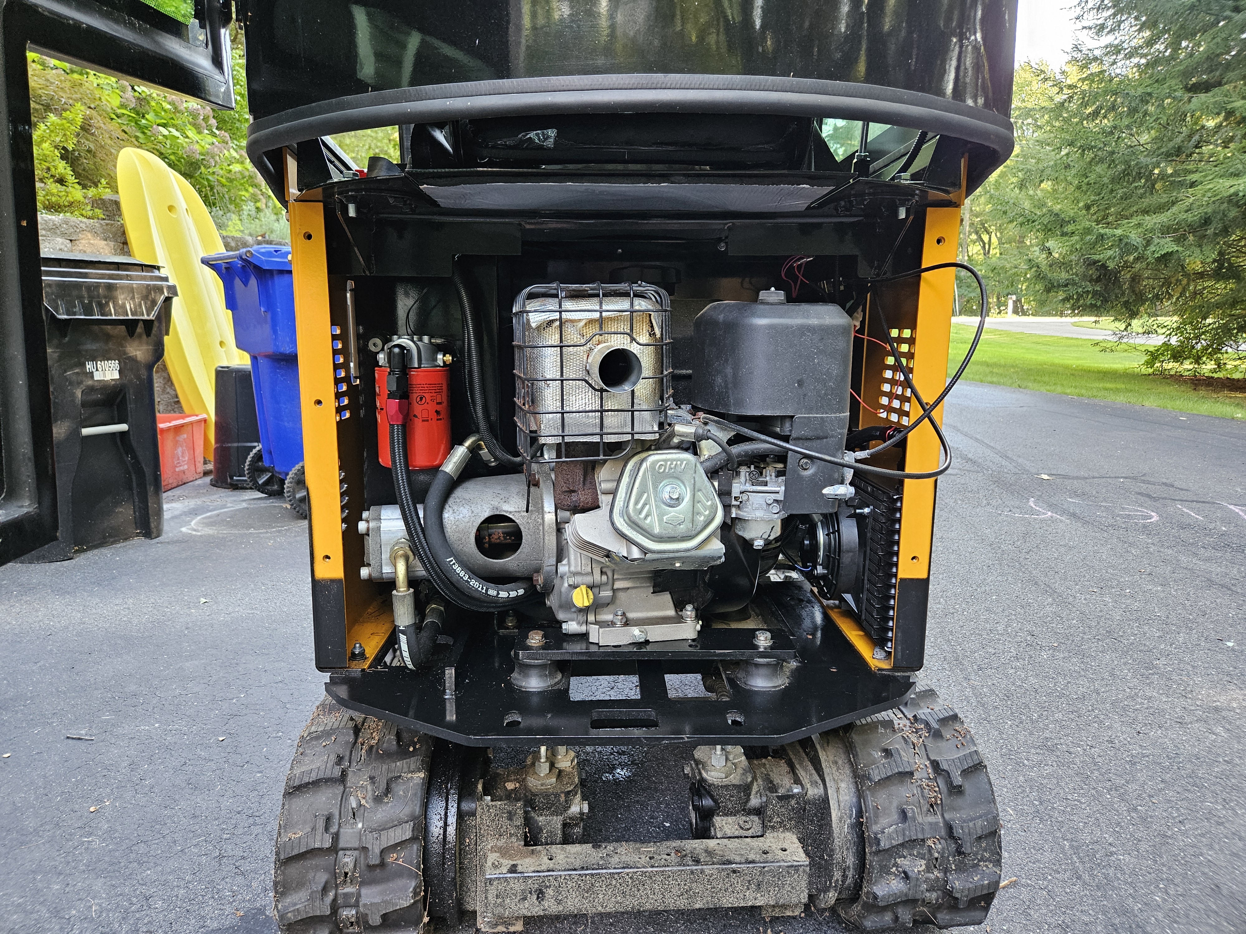

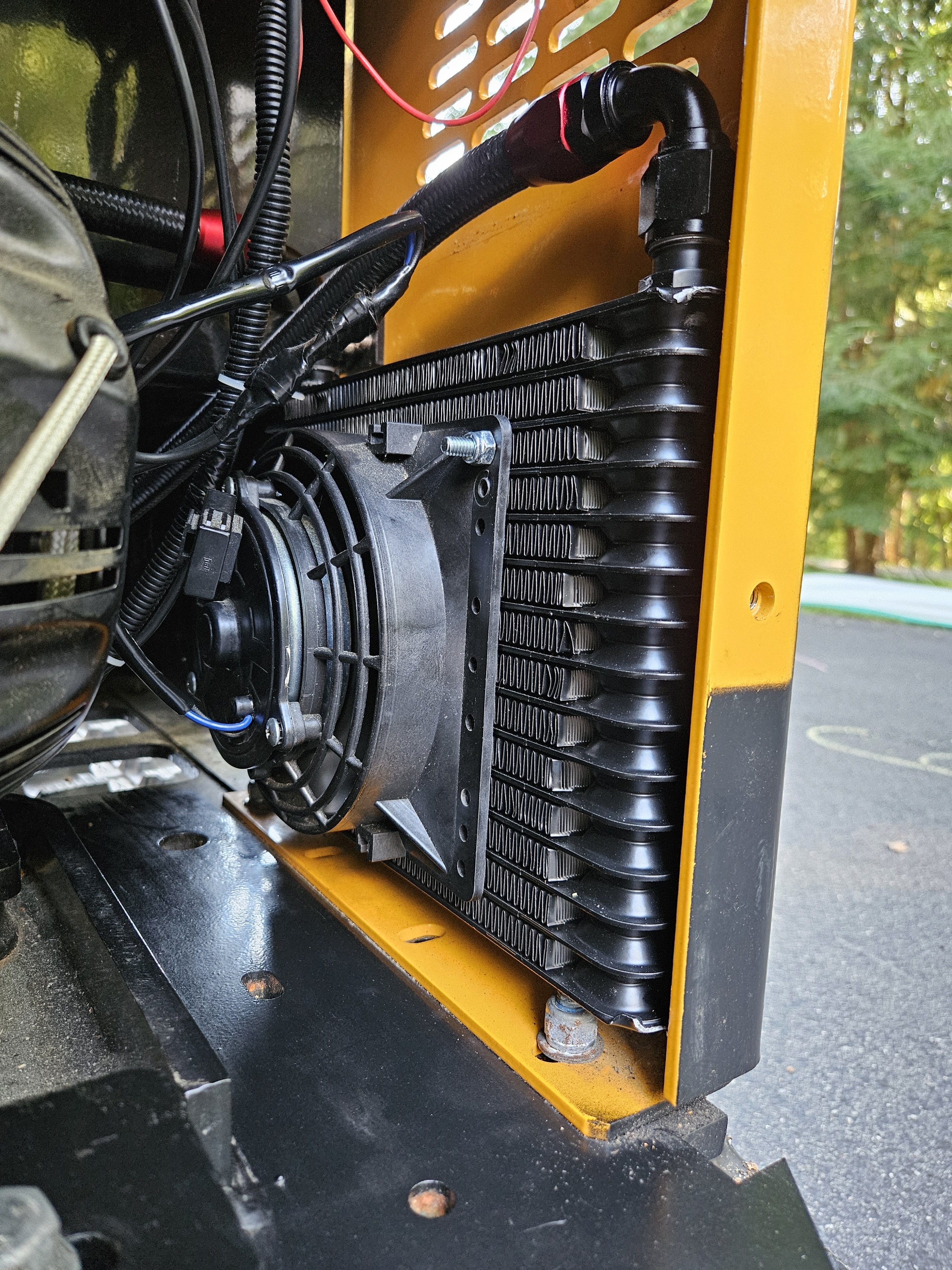

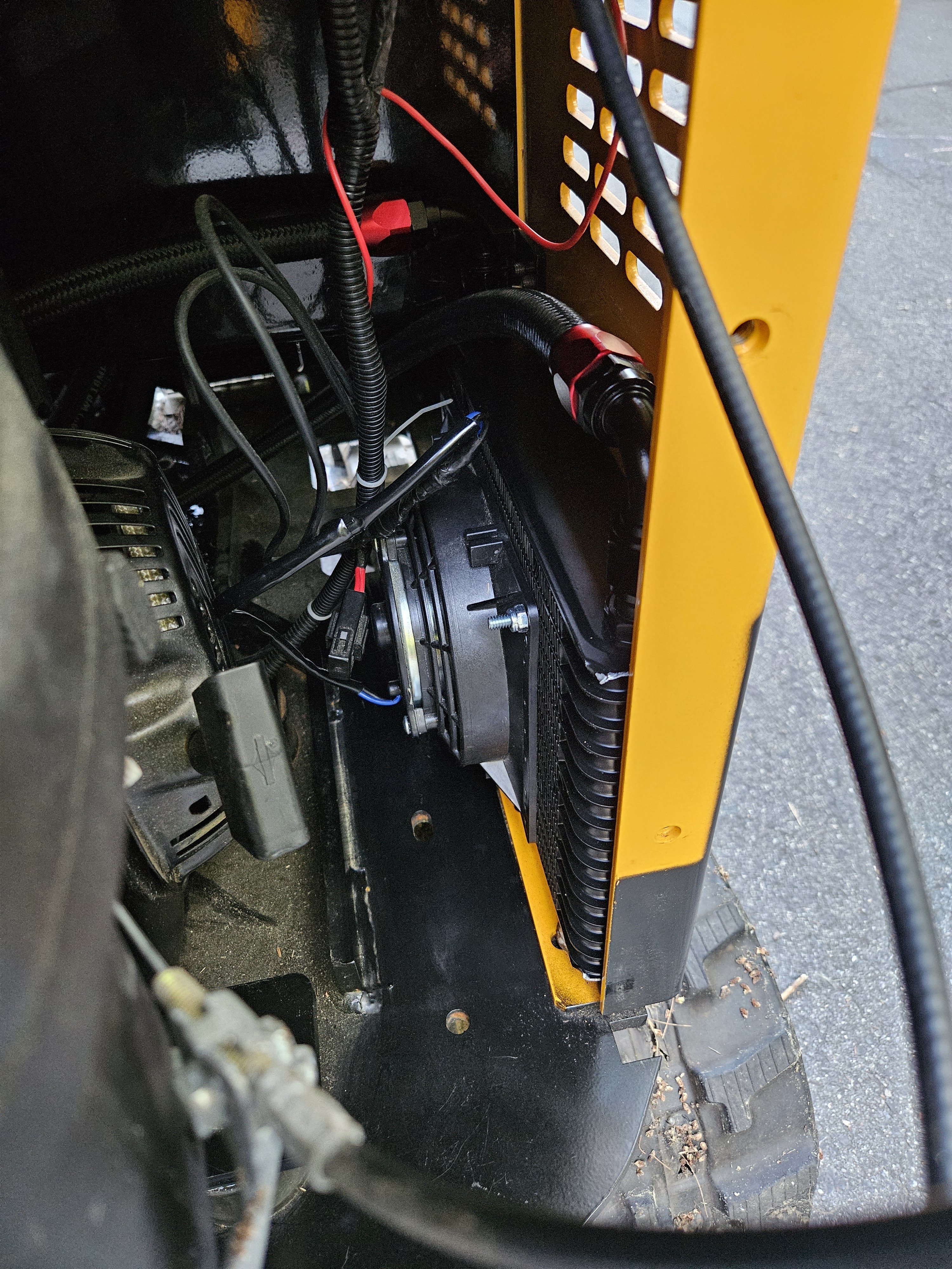

I just added a hydraulic oil cooler today. I had to cut off the mounting ears to make it fit but it turned out pretty good. Pictures attached.
I was fortunate that my machine had its ChangChai diesel removed before shipping, and the air duct left installed. It was not hard to fabricate the steel hoops to support it with my new Duromax 420 engine.
It would not be hard to get some foil dryer vent flex hose and do a similar thing.

Thanks for posting that picture and info
