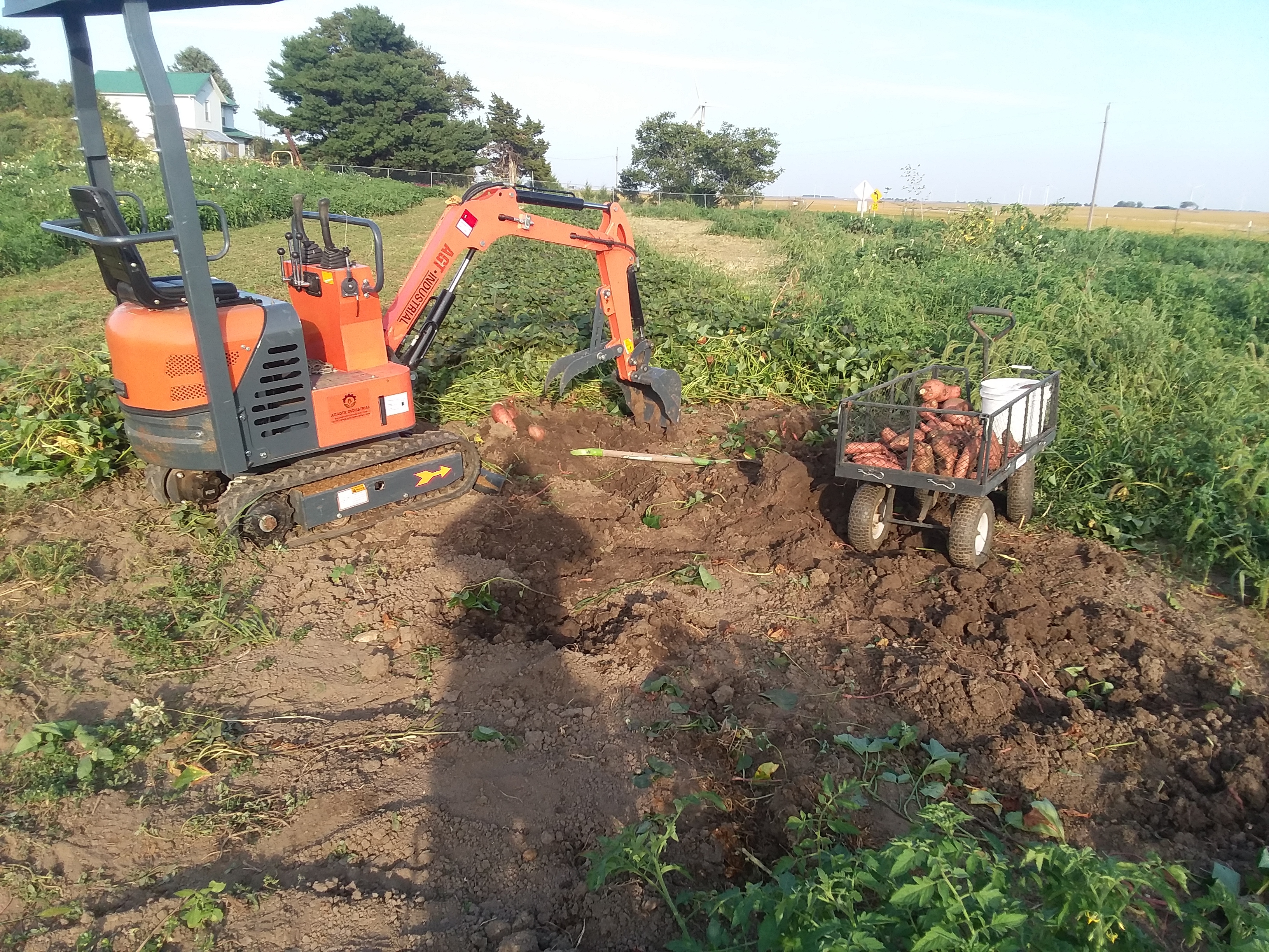

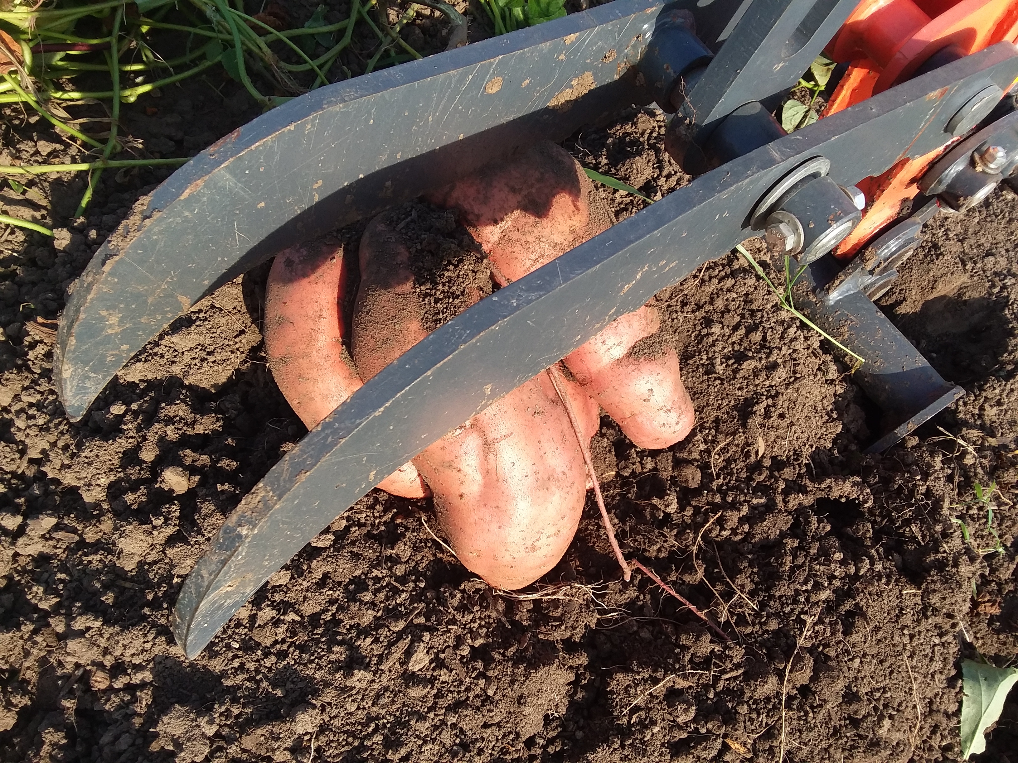

dug sweet taters with mine today. Ground is as hard as concrete and fork was out!

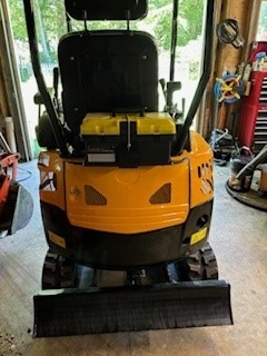

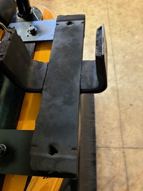

I put my "tools box" behind the seat - has most everything I need to fix in it - added a bracket and adhesive foam so it sits tight.

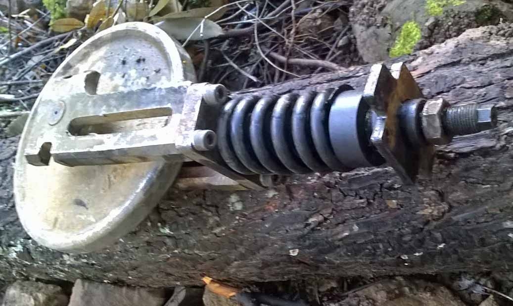

diggin in the tile line still. right track keeps coming off. Been doing that since I got it new last year. front wheel is junk,---wobbles bad.
Might just have to drag the digger around with a tractor til I get this job done. No time right now to screw with it. I bought the thing to use and NOT have to reman it!!!!
   / What did you do with your Chinese baby digger today? #549
When I removed one of my idler wheels, I never took it apart to see what kind of bearing it uses. Since it is not greaseable, I hope it is one or 2 ball bearings, which should be cheap to replace.
If you remove 2 socket head bolts, you should be able to remove the side plate and see. It seems to me that replacing that bearing will be less work than one track remounting effort. If you do this, please post pix.

I figure its just a bolt thru a bare bushing in there, --- have no idea yet but might try to take a quick look ! Track still off since I was mowing waterways yesterday and didnt have time to work on tile line.
New machine with 24 hours should NOT have tracks jumping off! Only the right side comes off left side is fine.
