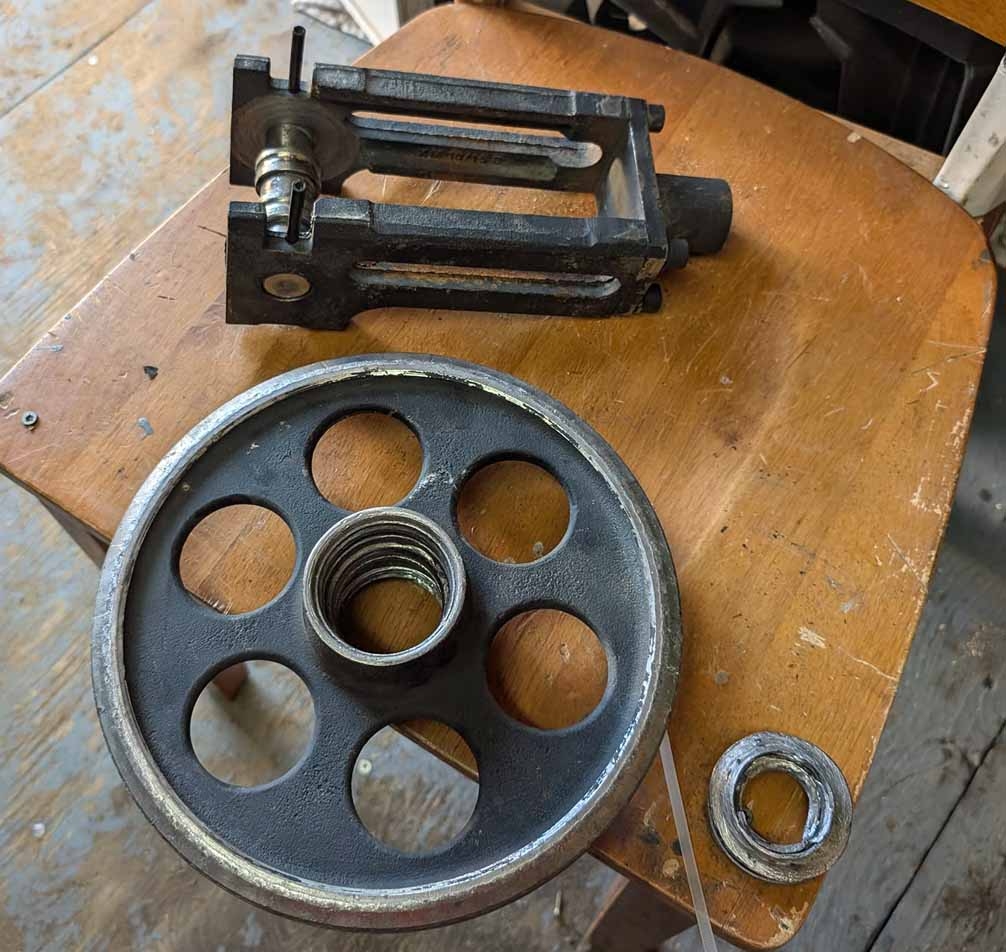

Well, yours will be the first pix of the idler wheel bearing(s) when/if you post it, Sonny.
I just saw a photo of the idler wheel removed from its bracket, on a public FB group. Posting it here to share.
It seems to be 2 ball bearings, and the shaft is secured with roll pins. Looks like easy fix with off-the-shelf parts. Even it you let the bearings fall apart and damage the shaft, replacing the shaft should not be hard.
If your idler wheel wobbles, don't wait too long.

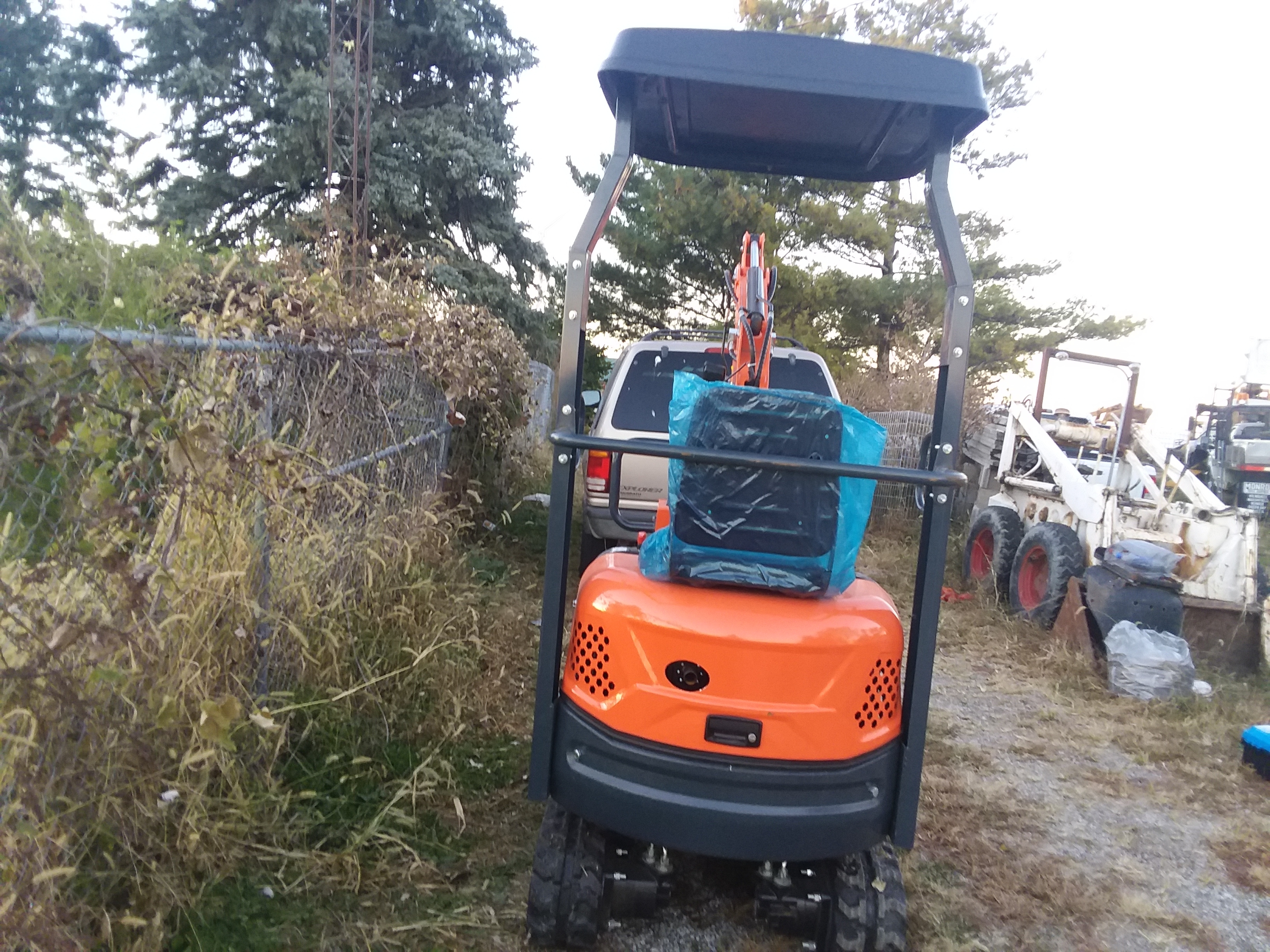

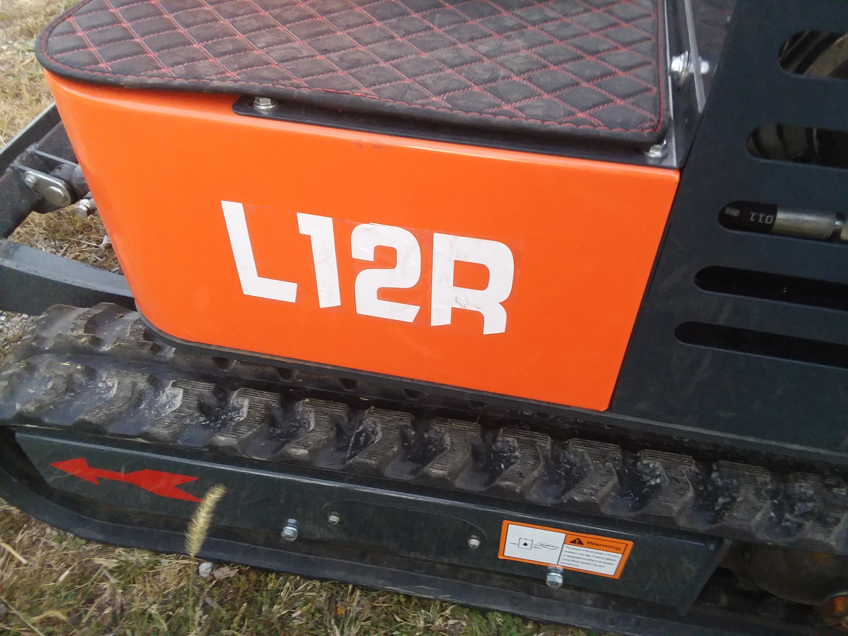

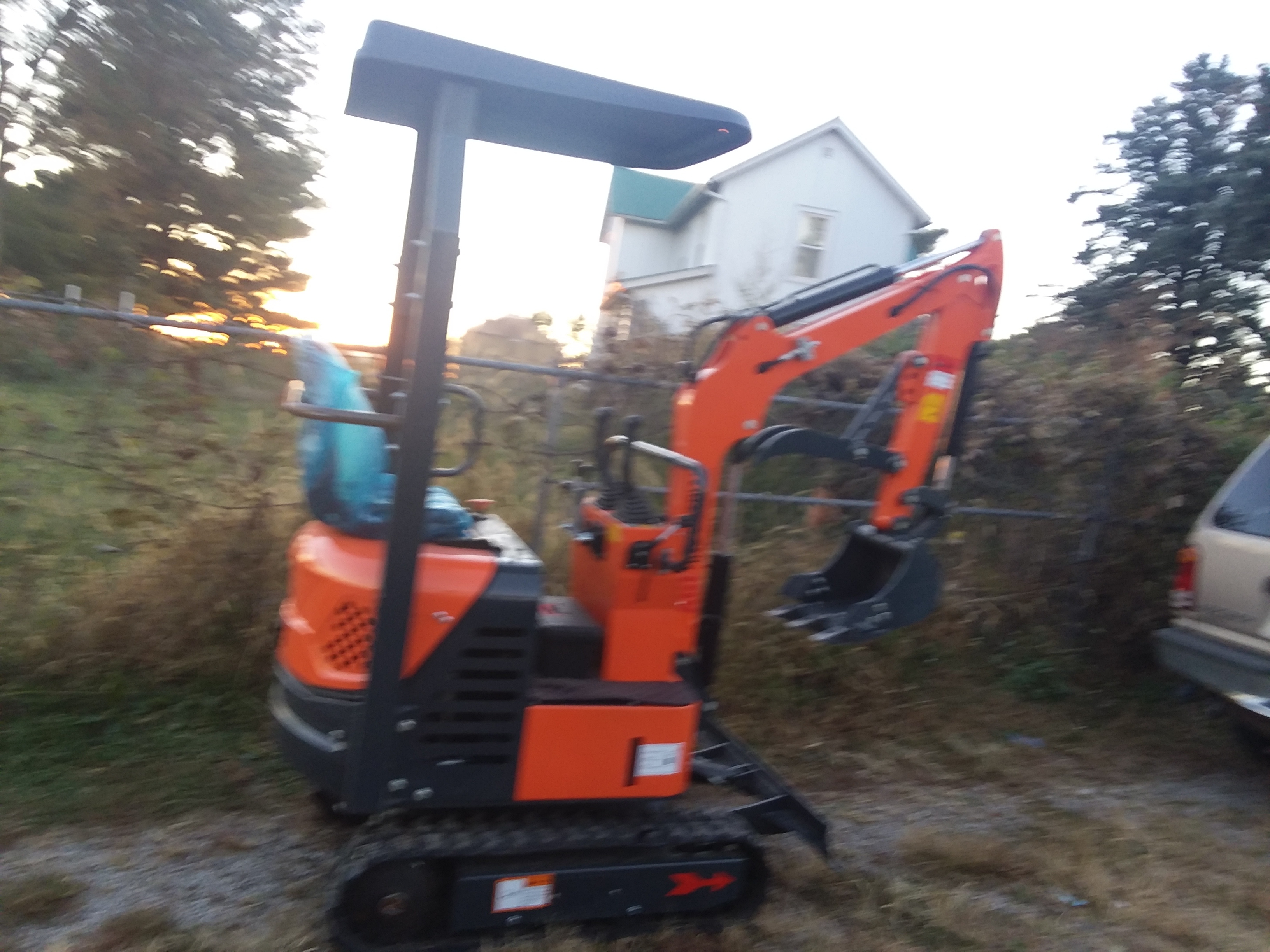

Idler wheel has wobbled since day one out of the shipping container new!
Anyway he now has a brother.

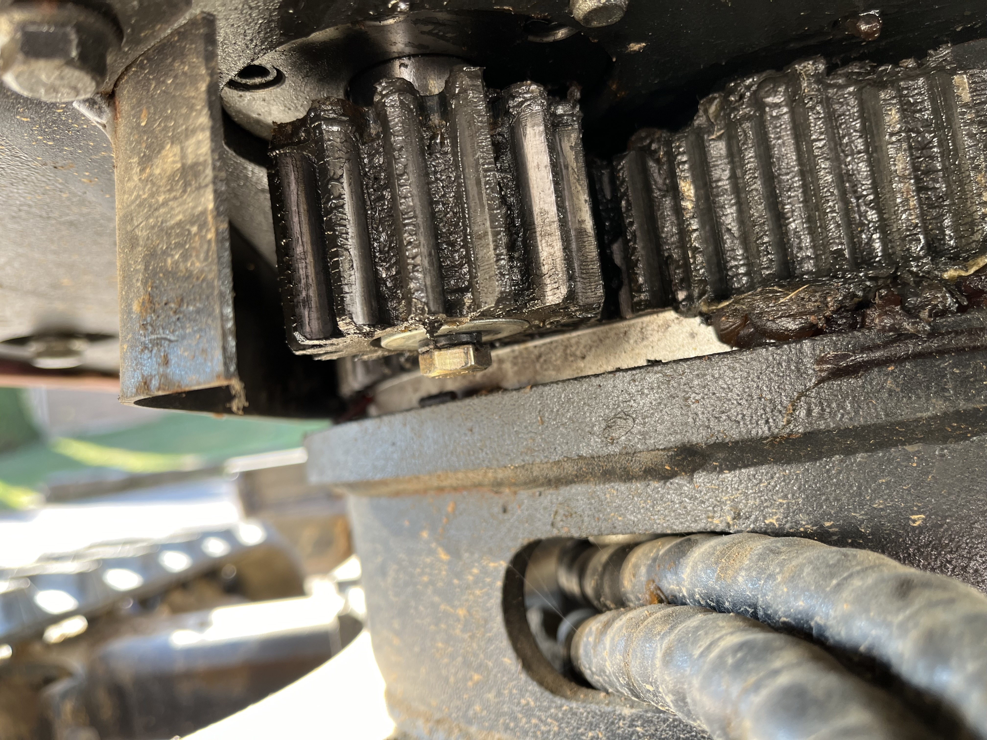

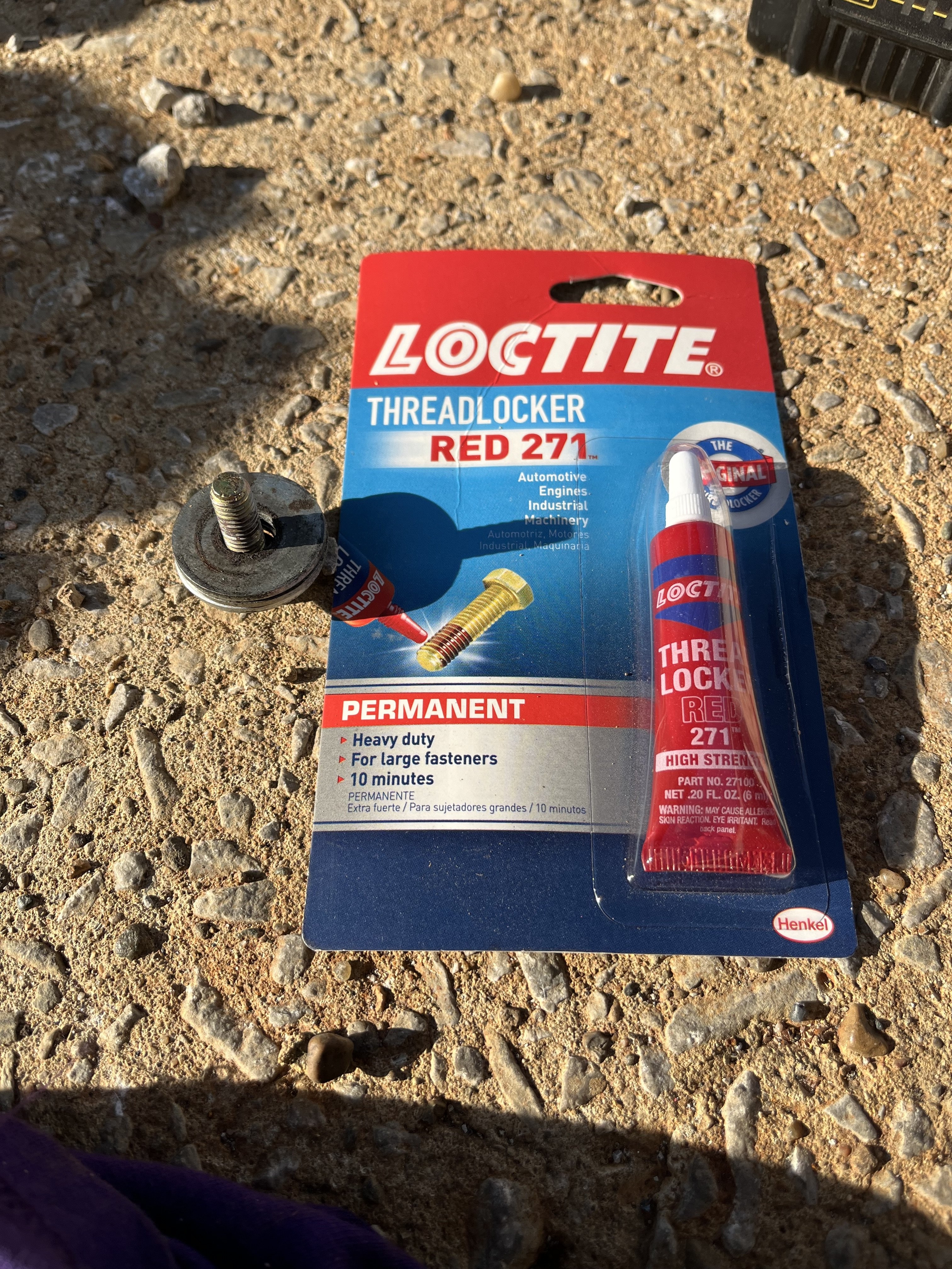

Preventative maintenance, this bolt continues to get loose, I tightened it, it came loose, I blue loctited it, it came loose, today, it got red loctite. This is the drive motor(slew)that rotates the housing.
   / What did you do with your Chinese baby digger today? #557
   / What did you do with your Chinese baby digger today? #559
Do you find out when it falls out? Or are you checking it frequently?
Looks pretty accessible. Is your ring gear guard only partial coverage? Mine is like that.
   / What did you do with your Chinese baby digger today? #560
Can the head be drilled and then safety wire it to something nearby? It can't back out if it can't turn.
