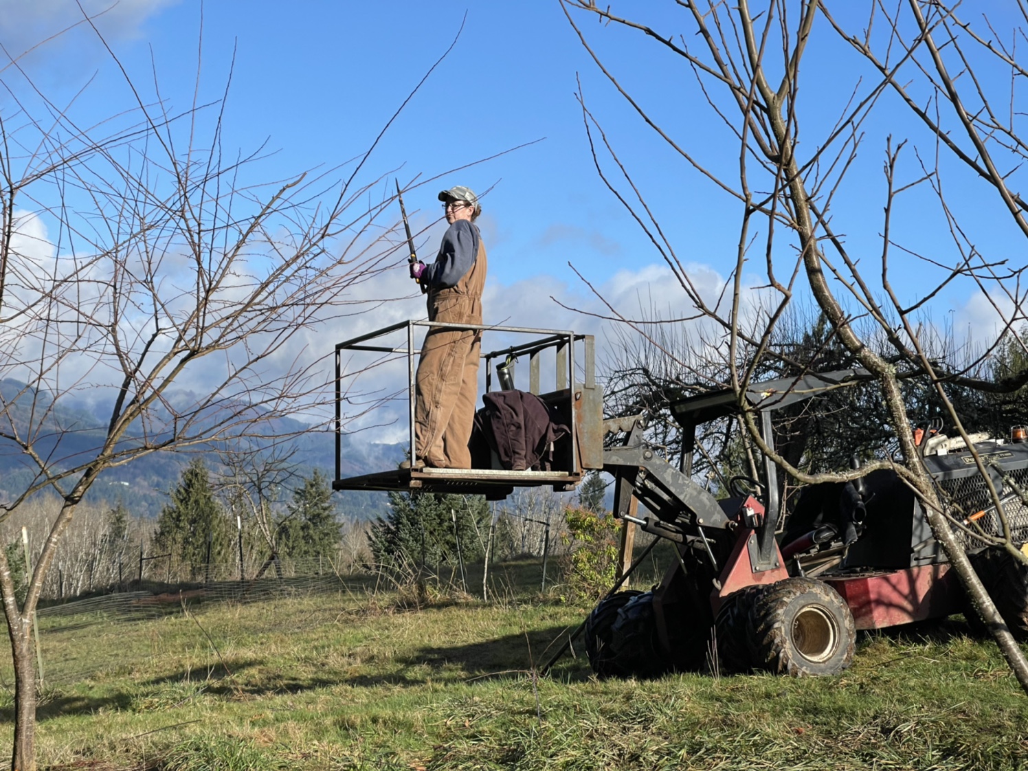

Btw. Trimming the orchard and then planted a dozen trees with the post hole digger.View attachment 684132View attachment 684133
LOVE THAT VIEW!!!!!!!!! How do you get in the basket? Can you control the loader from the basket with that long stick or just a 2nd person? I was pondering that and since I work mostly alone, would need to use controls from basket. (That along with the engineered leakdown... Start at top and work your way down as it creeps)

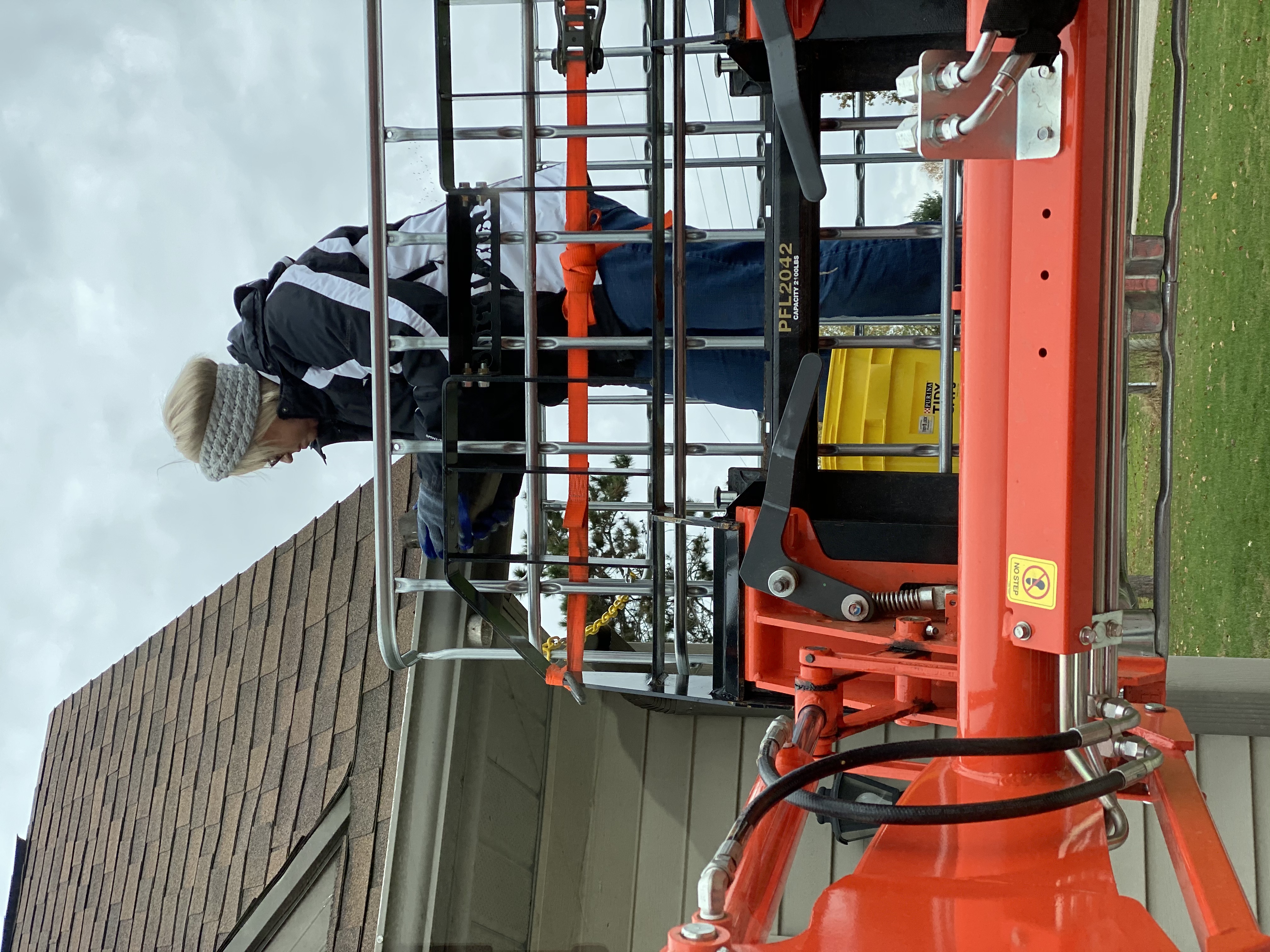

These IBC totes work too.

We work together on this as i am not smart enough to remote the tractor. It leaks down for sure. When i work alone with it i set it then climb up the arm and over the back if the basket. It stays for about 5 minutes or so. Enough to change lightbulbs or cut the odd branch. The toats are great except you need to cut a side door or climb over.

The high pressure hydraulic needle valves can be used to stop leak down (and also to adjust the speed of cylinder response). I use them when I need to lock a lifted load for an extended period of time.

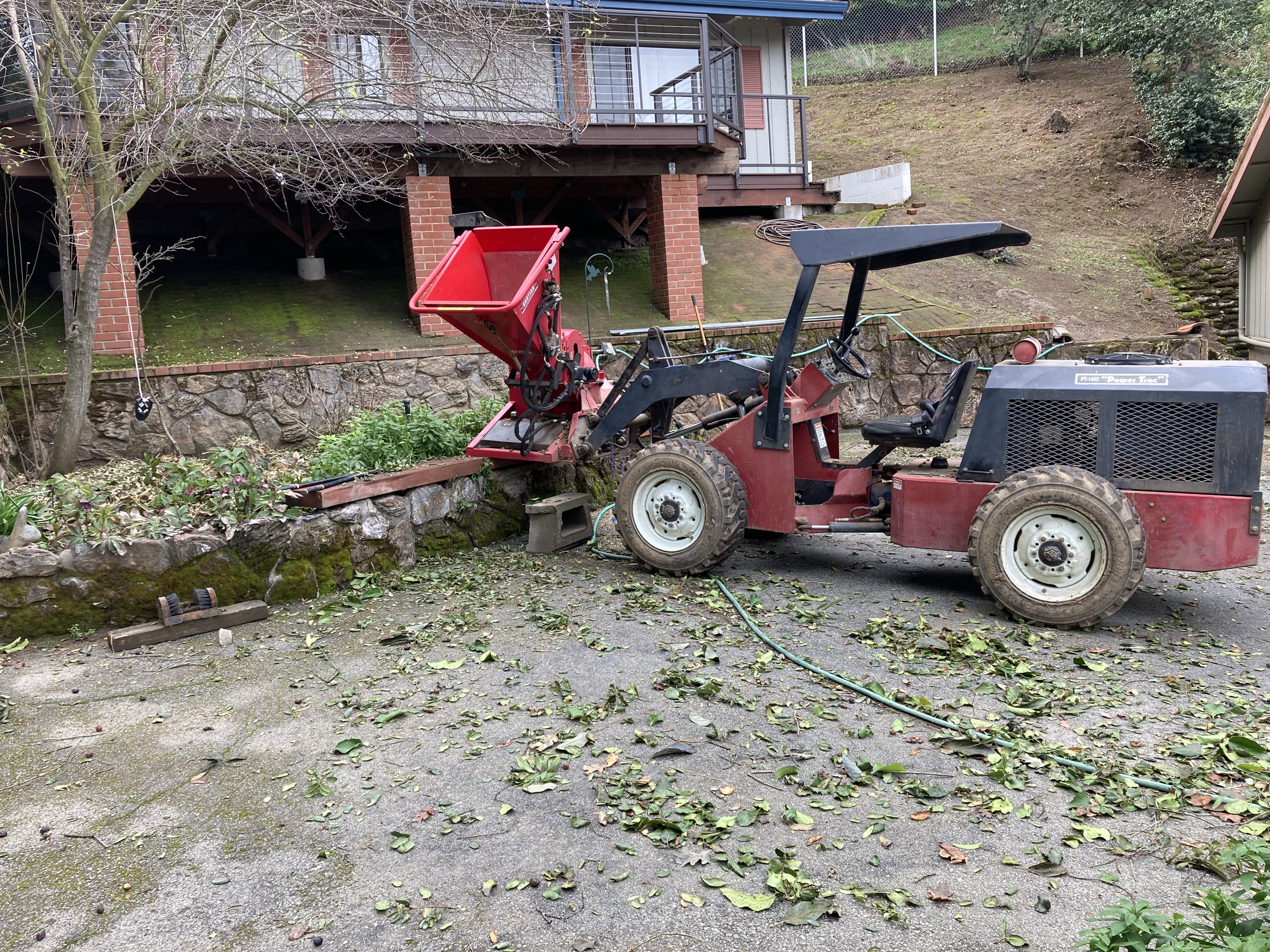

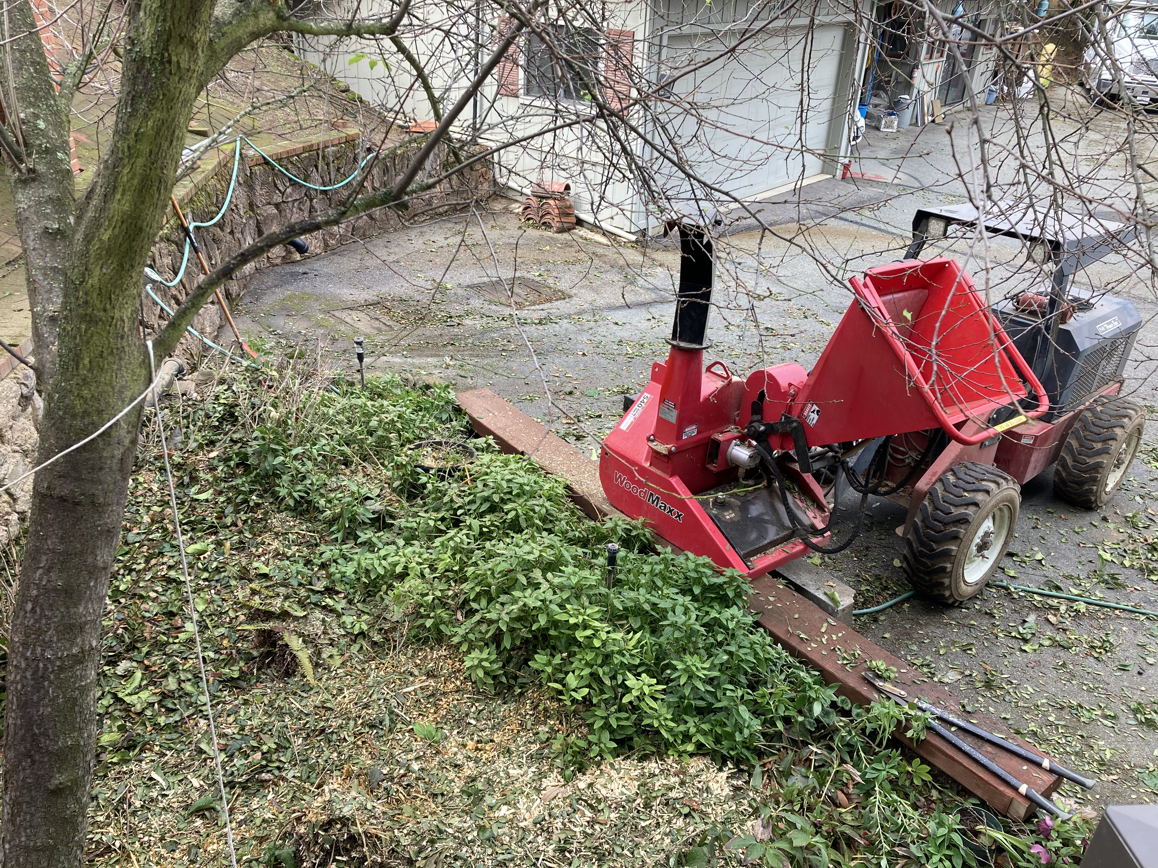

Today was clean up after a major windstorm that blew down more than five cubic yards of leaves around the house and garage in big drifts, like snowdrifts. There was also the task of chipping up some wind blown branches that tore off in the storm. It ended up being more than a cubic yard of chips.
One of the great things about the PT is getting the tool where you need it. I also trimmed a plum tree in front of the house, while chipping everything else; chipping tree trimmings as they come off the tree.

Thanks! It is a Woodmaxx WM8H that I modified to put a PT QA plate on and a hydraulic PTO motor from Surplus Center. The hydraulic circuit for the feed is separate from the PT, and driven off the rotor shaft. I may change that. It does up to 4" dry hardwood no problem, and about 5" or so in softwood, larger if it is green. I intentionally undersized the motor to generate 540rpm at about half throttle, thinking that higher speed might be better for tough jobs. It isn't. In hindsight, perhaps not a great call, but not so bad that I have gone out to buy a replacement motor. I do regret not plumbing in a reverse on the PTO for the inevitable jams, though it only takes a minute or two to do it manually.
I did ask Terry if they would consider making one first, but Power-Trac declined. They said that they had looked at it and thought other people did a good job, and didn't see a niche for them.
