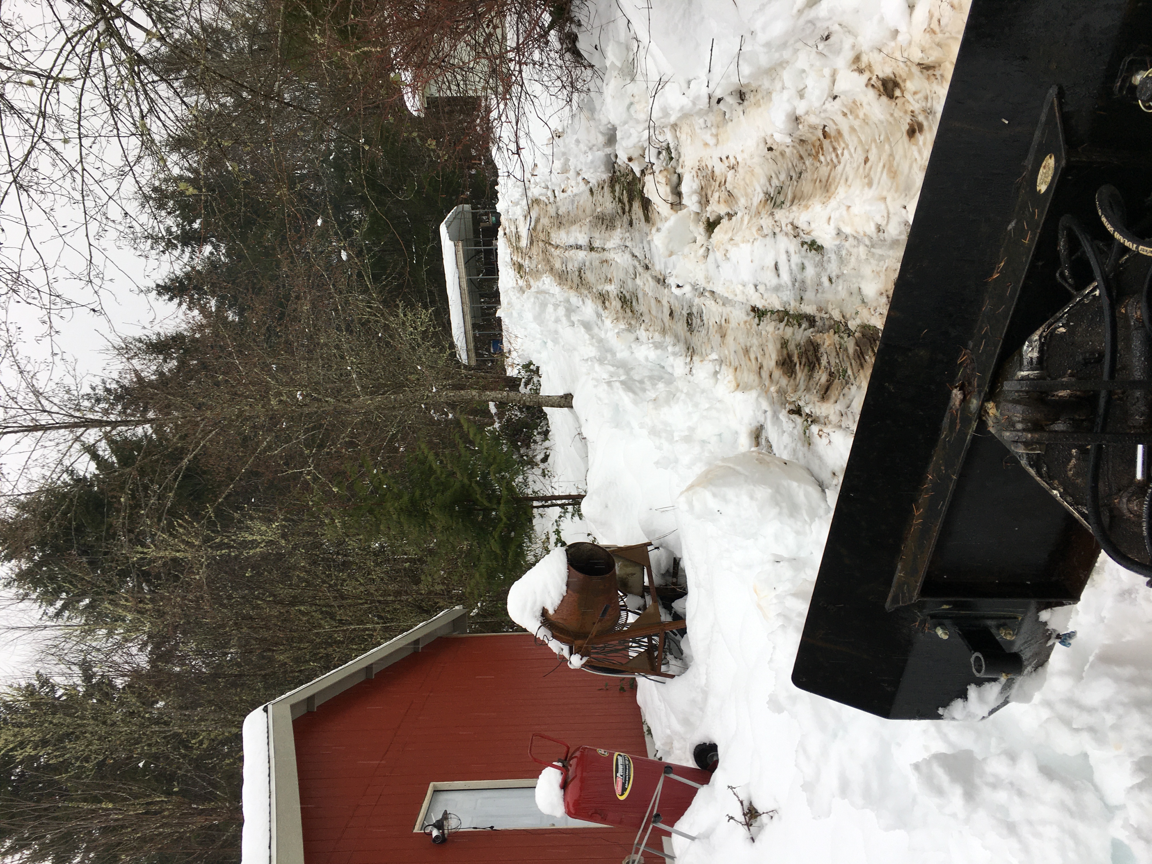

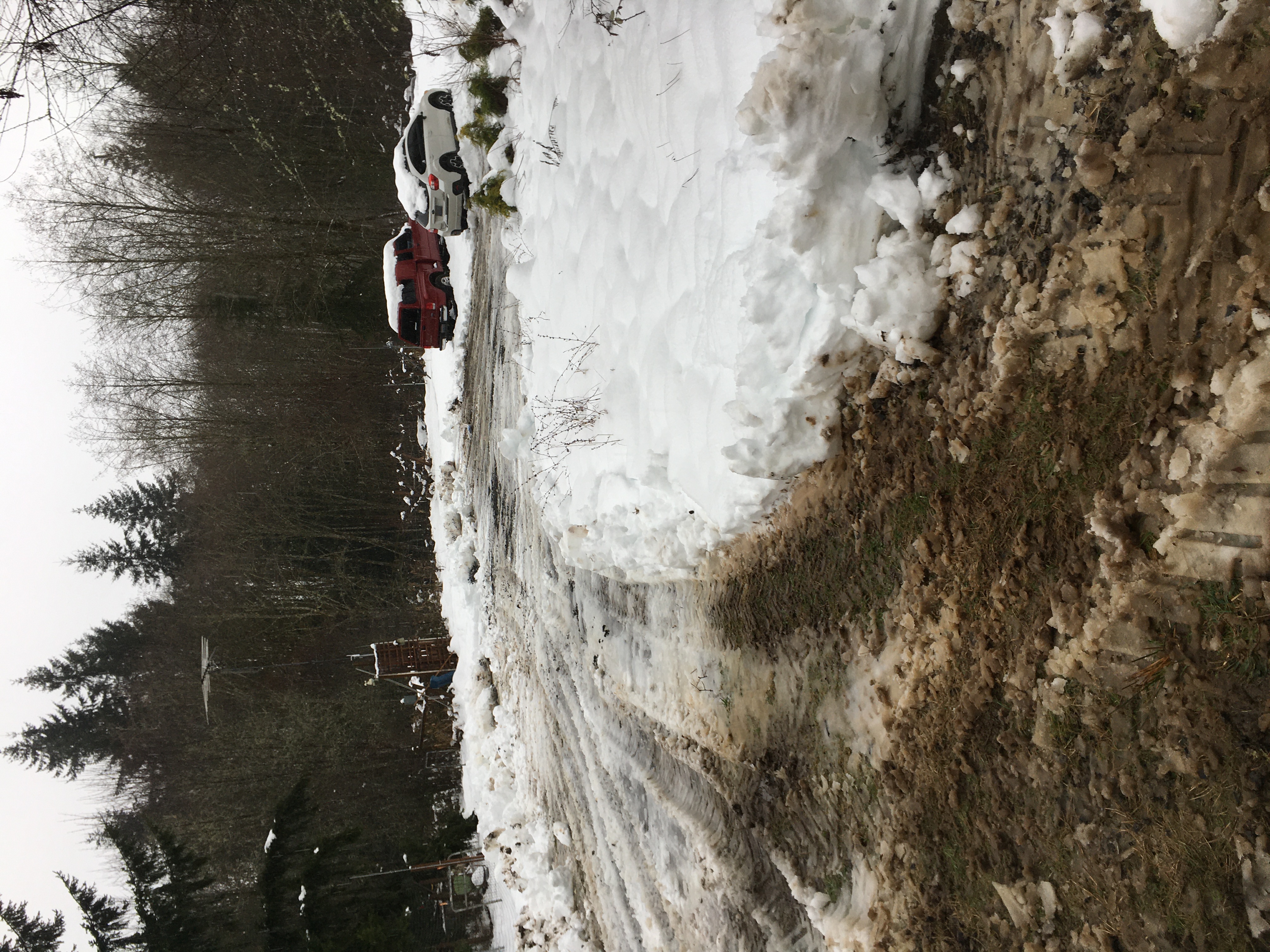

My first time trying a video. Using the PT180 to push back a snow bank so the wife could get to the bird feeder on the left.

I see you have the brackets for the wheels on your plow. Do you not use them and if not why? I have considered getting them but have not yet.
   / What did you do with your Power Trac today? #96
Good eyes, yes i do use the wheels. This is the first time i've used them. That pict that shows just the one was after the clip that holds the wheel in had popped off, and i was driving to the shop to get something to takes it's place. This was the first time using them, and i gotta say, i wished i'd got them a long time ago. I have a gravel as you've probably noticed, and the wheels help immensely. I put the plow in float and it works pretty well.
