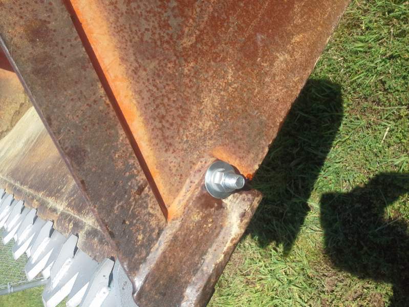

Is it necessary to remove your old cutting edge to install the tooth bar or does the the tooth bar fit over the cutting edge?
Mine fits over the cutting edge. I bought mine through the kubota dealer and it came attached - bolted on - with the new tractor. The only time I take mine off is for the ratchet rake and if I'm doing a lot of road work and need to back drag the bucket a lot. Now that I have a grapple I don't use the ratchet rake but I still use the tooth bar for digging.

DocDryden, If you want the Piranha TB, I'd check with Harry first (BX-Expanded). The thickness of your bucket edge might be an issue. I leave my Piranha bar on the FEL all the time, for snow, dirt, gravel, digging etc. It works fine for back dragging as well.

And if you want the Piranha I'm pretty sure Harry can make it for any thickness. Another thing is to pay attention to how far back any side reinforcement
is on your tooth bar. Harry wrote he can usully move the hole far enough back so you don't have to worry about it.

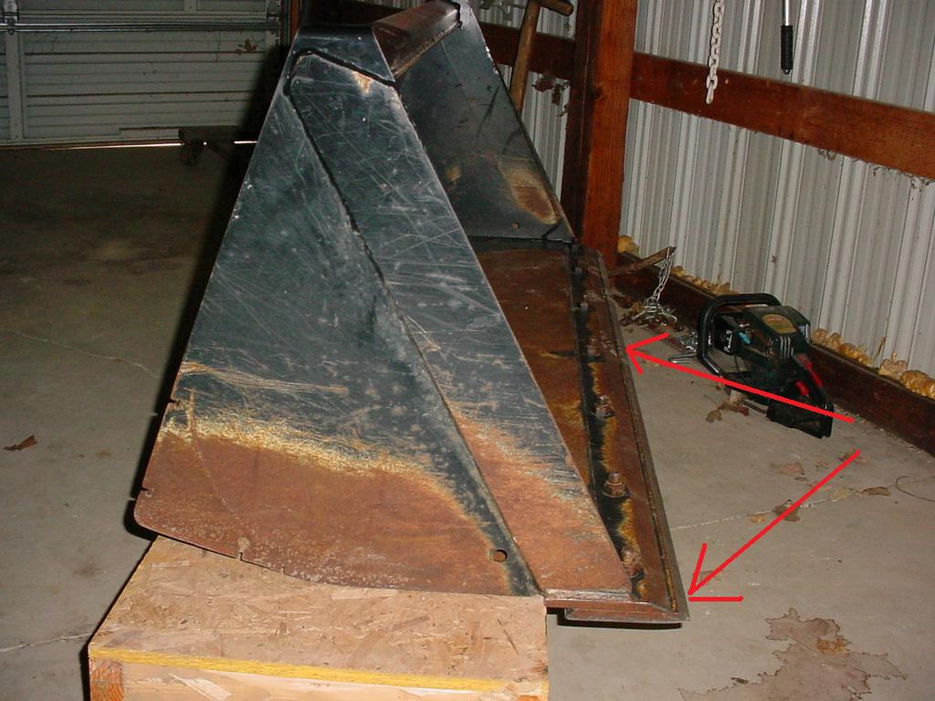

Looking at the holes on the side of your bucket you should be able to find one to fit over the edge. Do you want to keep the bolt on edge you have?
Yes, I would like to keep the bolt on edge..
   / What do you do with your FEL Tooth Bar? #18
We build the Piranha with special components to clear the additional edge. Just make sure we know it's there. If you order online you can add a note in the comments section.
Cheers!
Harry
