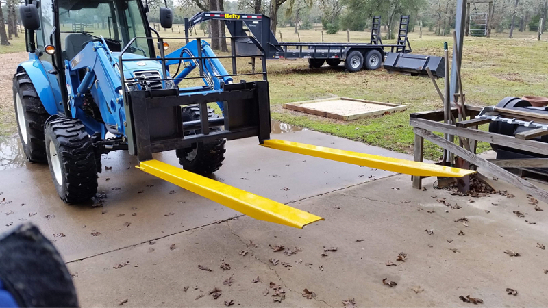

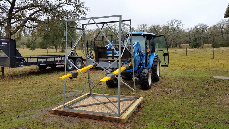

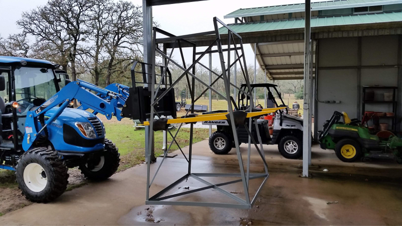

Set newly painted diesel tank stand today with Titan 48" x 4000 lb. forks and Titan 72" extensions. EZ-PZ.

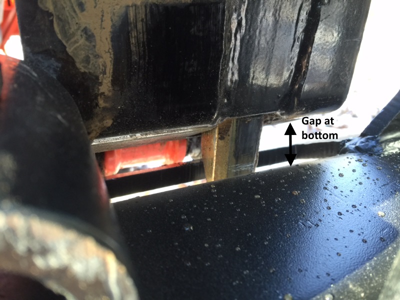

Got to try out my forks today. I'm not sure exactly why this is, but there's a substantial gap between the bottom of my QA and the bottom of the plate on the forks. Tell me this is not normal, because they've already popped off while stacking a couple logs.
This pic was taken from the front of the tractor for reference.
That is way too much gap, it will allow the frame to slide up and come off the top of QA.
If it only comes off of one side it will likely bend the QA, as there have been many threads here on that problem.
Unfortunately Titan seems to have a history of this problem.
Read from this post on down: http://www.tractorbynet.com/forums/...ents-experience-2.html?highlight=#post3686514

Our Titan 48" x 4000lb. forks fit very well on both of our tractors. New Holland TL100A has Bush 5045 FEL and the LS XR4046HC has the LS FEL. If the FEL QA is well seated in the Forks QA pockets the pins engage well thru the slots on the bottom of forks.
My experience with Titan Products has been exceptional! Your mileage may vary?

Xfaxman, correct on all accounts. When it popped off the QA, it was from the bottom, though. That's how much gap there is. They bounce like crazy when going up my driveway. I'll take a look at the thread you supplied. Obviously will be calling Titan tomorrow as well.

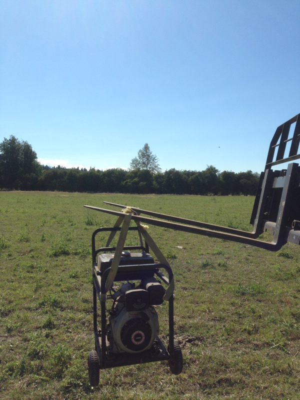

I haul my little diesel generator with them when I have to work on something away from the barn. I am careful to use my osha rated strap with knots in it.
