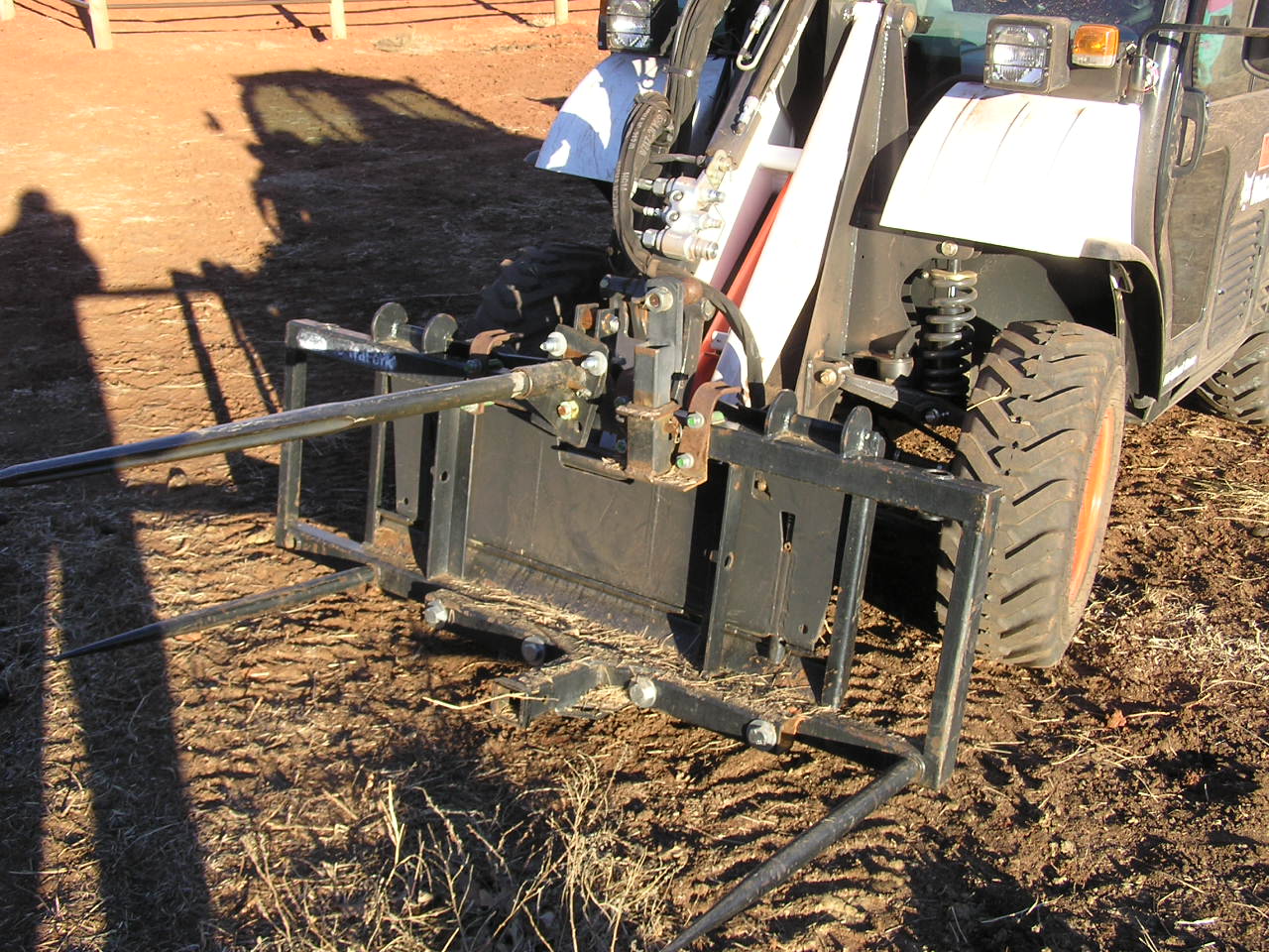

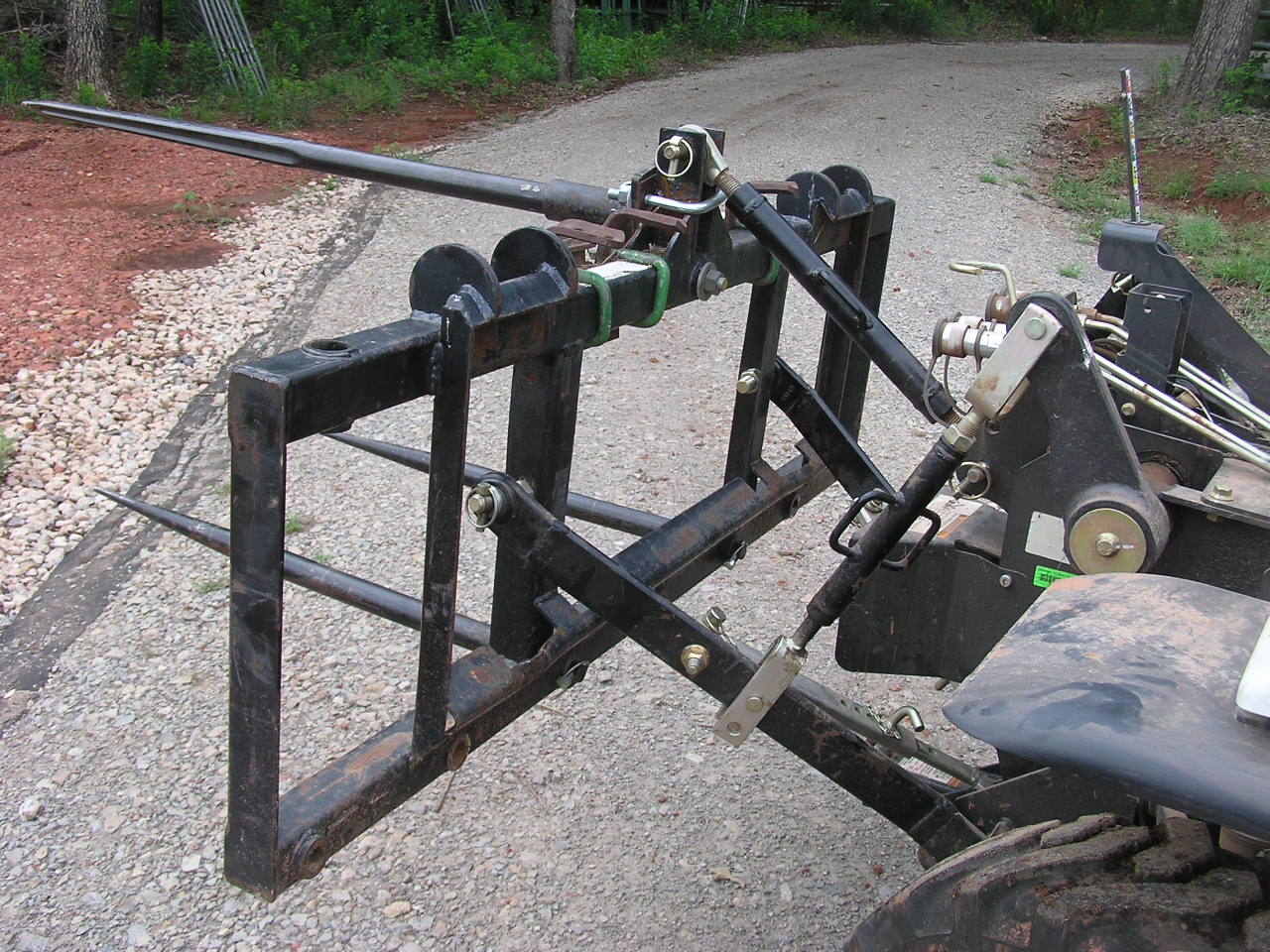

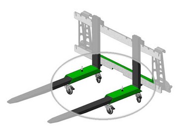

FYI, here is the Speeco UltraFork that attaches to the front or rear. A pallet fork frame can be made the same way.
On the SSQA.
On the three point hitch.

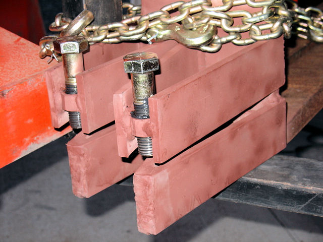

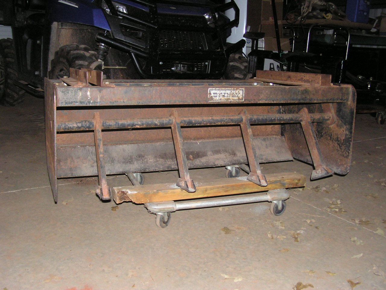

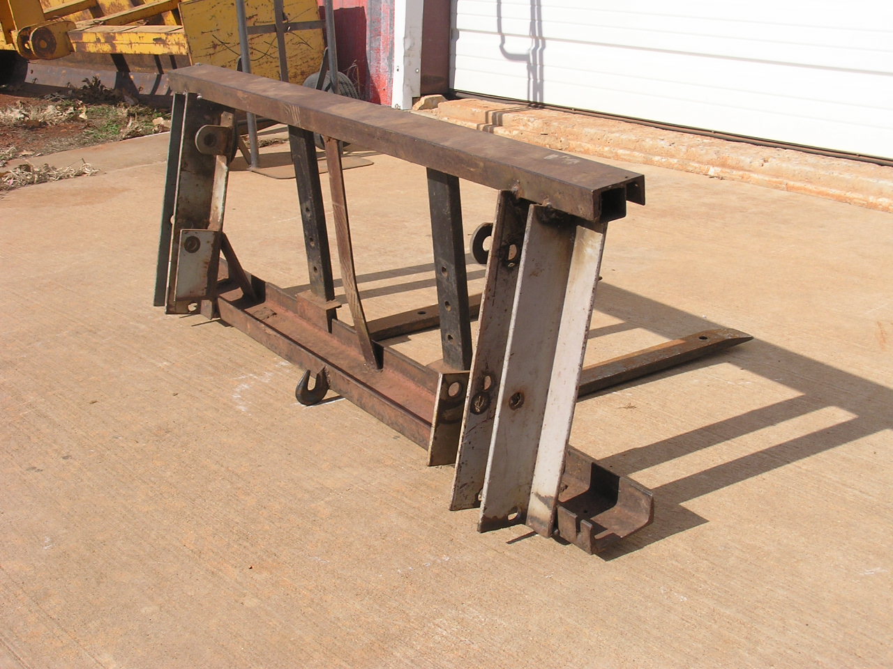

If you have the means to weld then you can make your own heavy-duty clamp on forks. Go to a forklift repair business and see if they have any used Class II forks that they will sell you. Most of the time they just sell them for scrap when they part out a forklift.
Then design a clamp and strike up the welder. The HD ones I made are in the photo below (clamps shown).

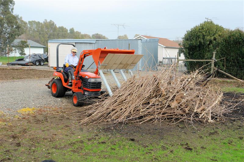

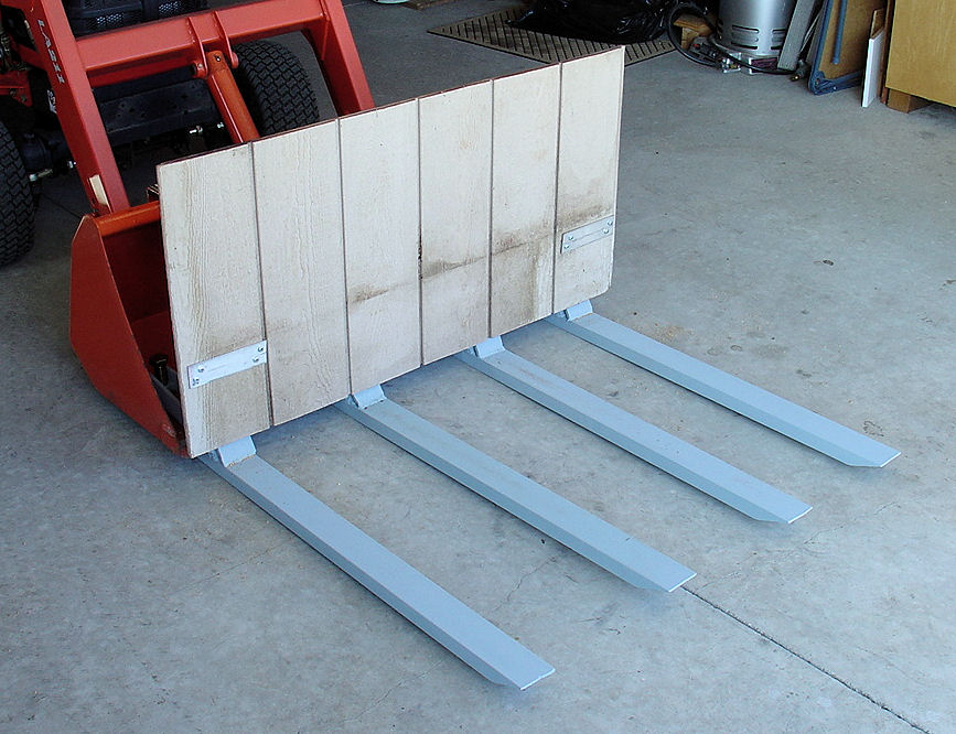

Then there are light duty ones that can be made from channel iron. Three photos are below for the ones I use on the BX2200. Four forks were made so the two extra could be added and then the bucket is used as brush forks. Even my wife can use them.

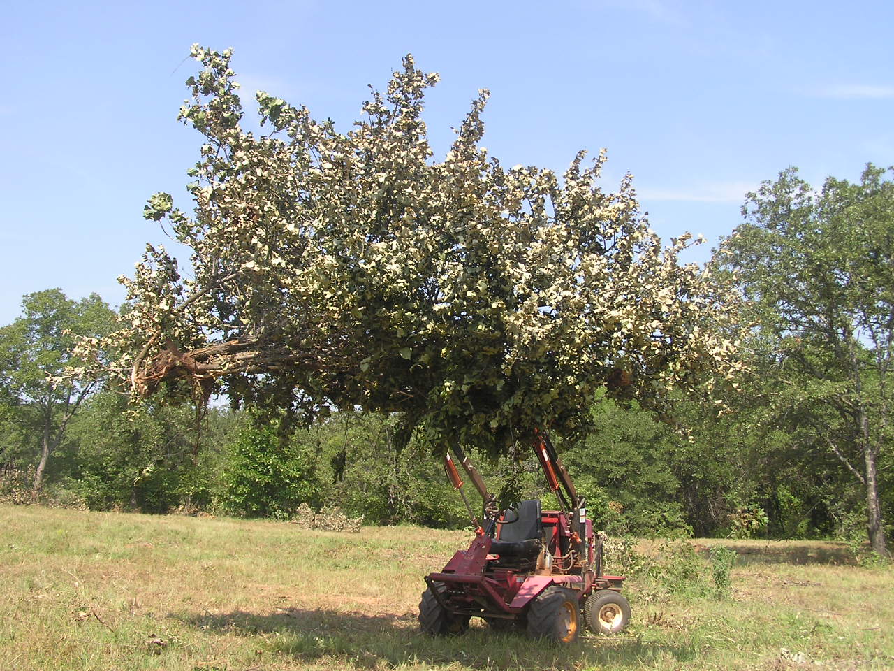

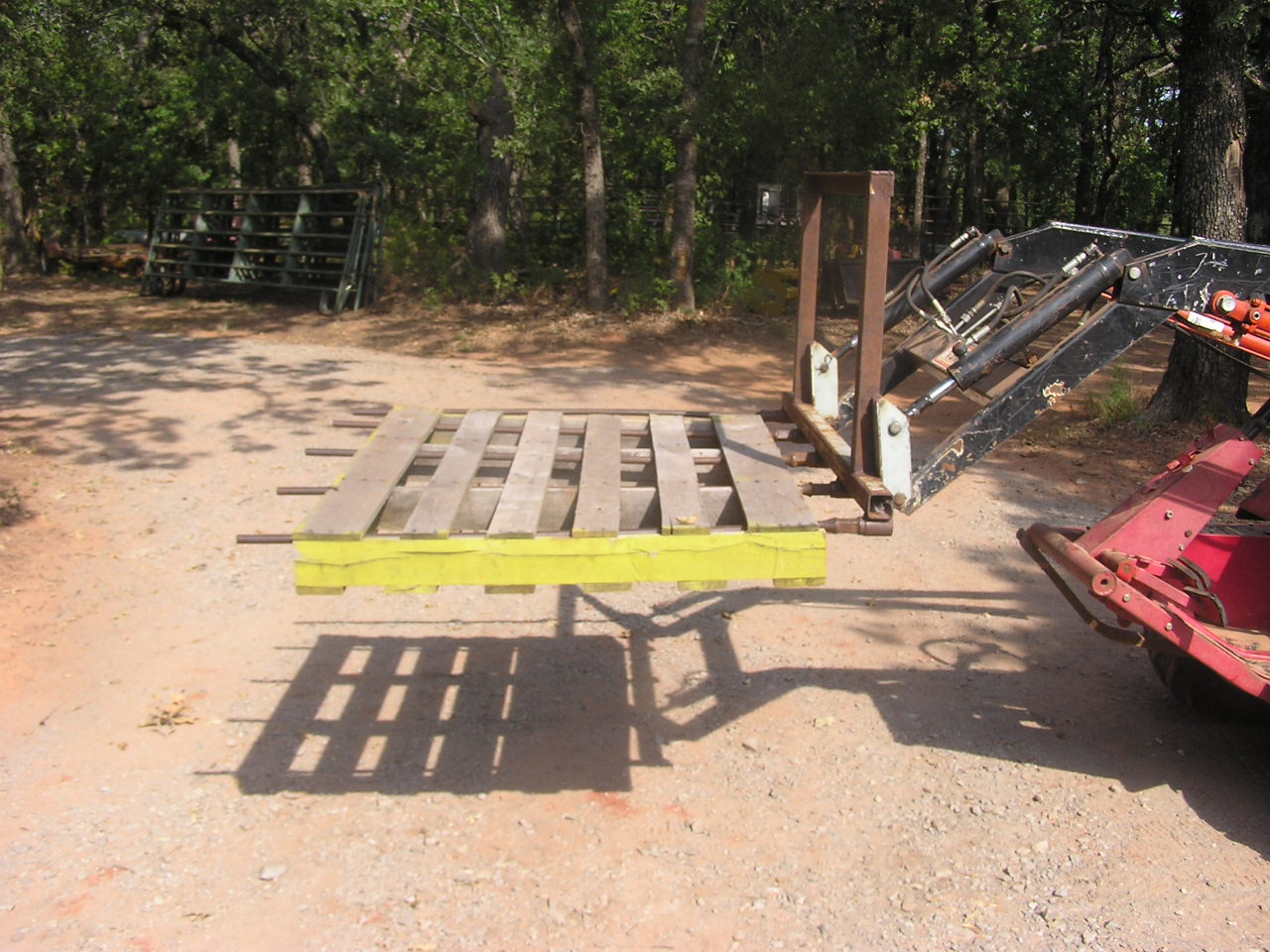

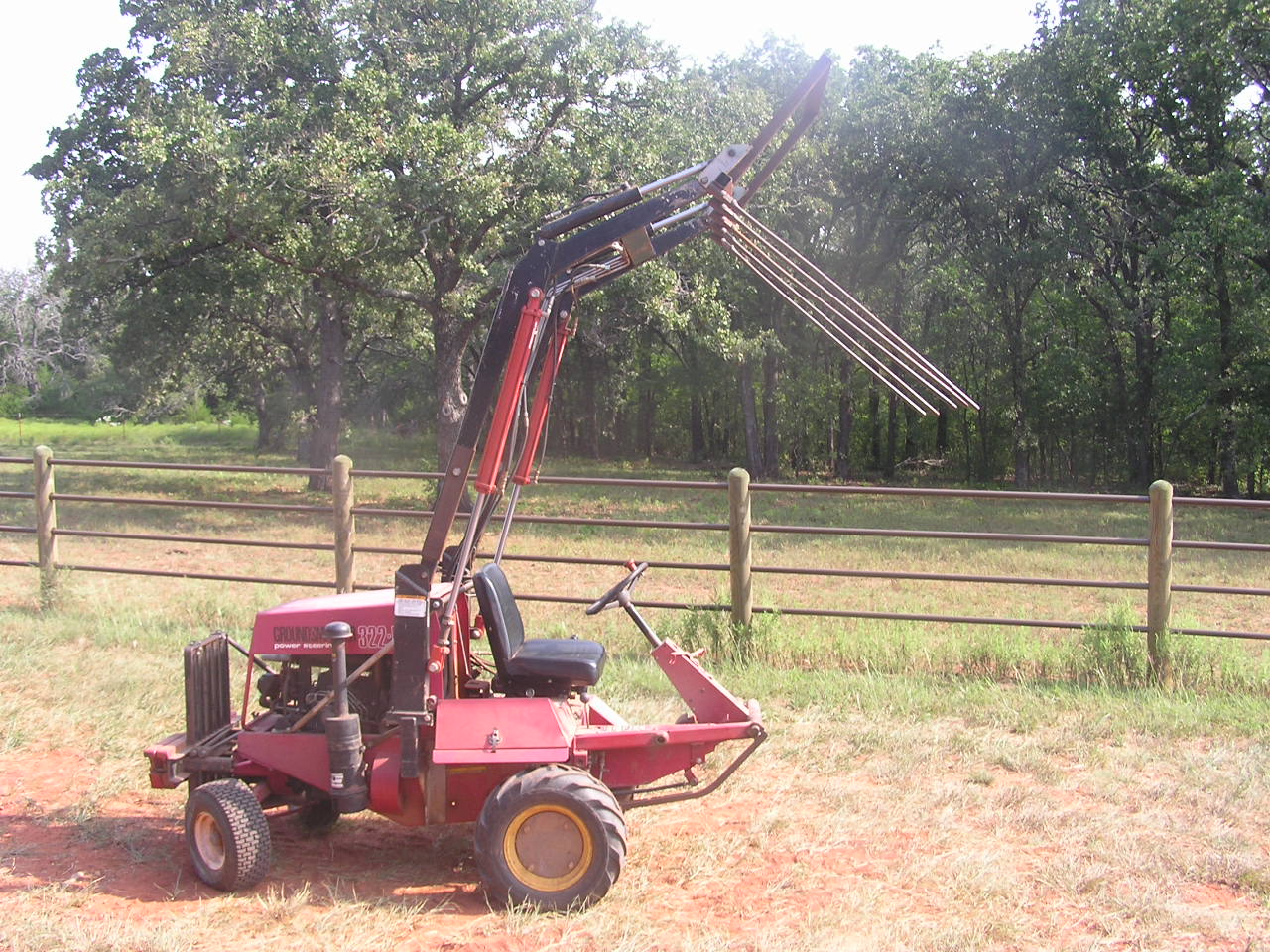

I made some 48" brush forks 5 years ago for the TORO+Loader.
They work on pallets also.

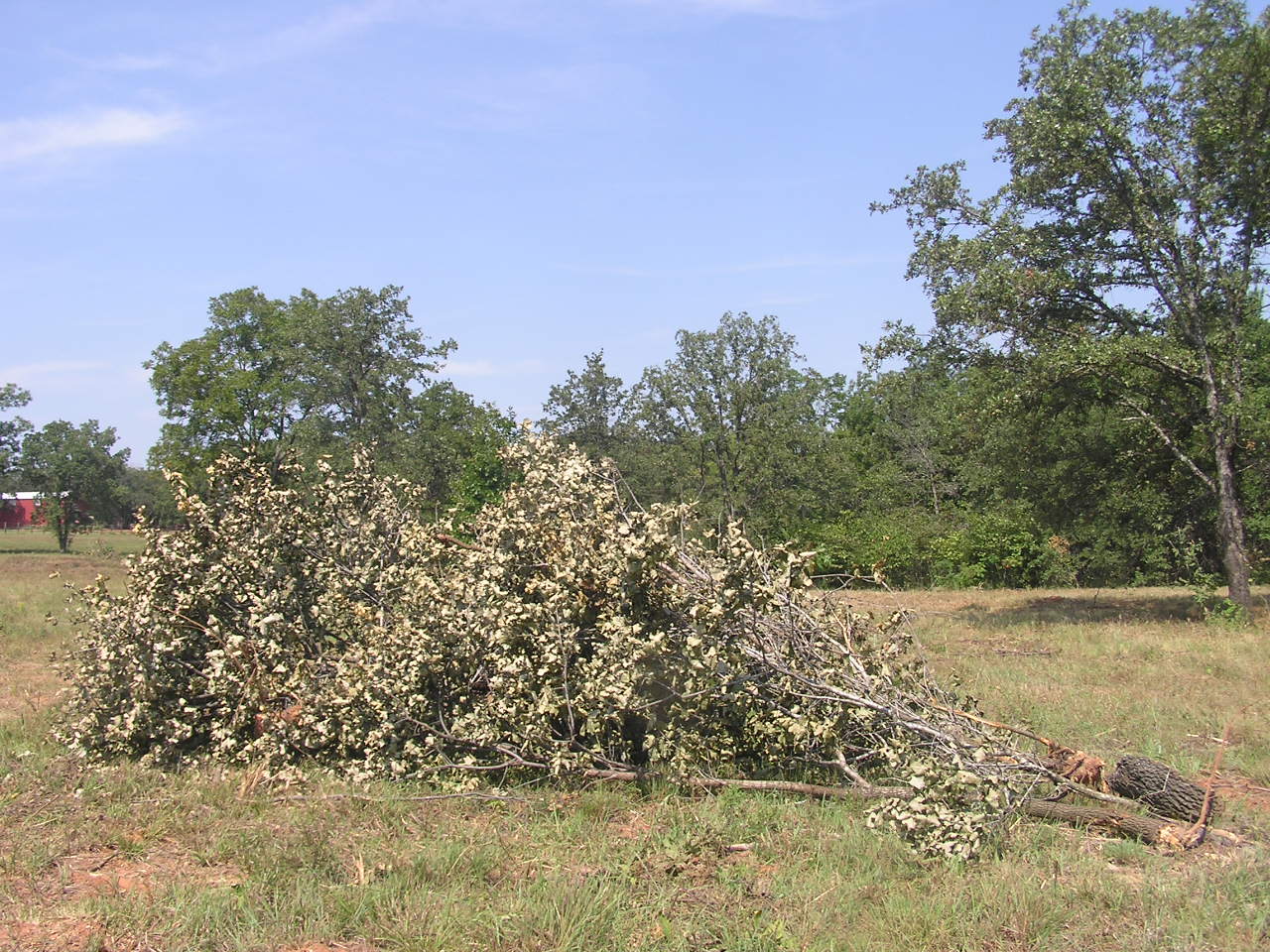

Here is a pile of trees pulled with the Versahandler.
Slid the forks under it and took it to the burn pile.
