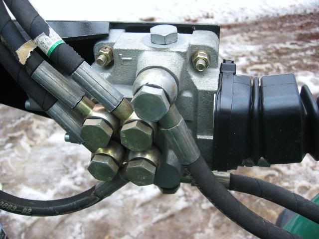

Thanks for the response Kennyd. The hydraulic shop I was at was basically interchanging the top plugged port and the out 'T' port as doing the same function. The pic is my FEL valve. The top plug is the PB port. The top front 'T' port is the out feeding the remotes 3pt .....to tank. It is after this port where I want to install the valve in line with the out from this new valve continuing to supply downstream. The valve I mentioned is open center supplying this function. Sound right?
Thanks Dave
T usually means Tank, so that top port would not feed the 3PH. There are only 6 hoses connected right now correct?
Why do you think that top port is for PB? There is usually a plug that need to be inserted for the PB to work.

The shop I was at seemed to interchange the PB port and and my current 'T' (out) port as dong the same function and you could use either. This may be right as I mentioned right now my setup has Pump to FEL to remotes to 3pt to tank all in line. When not diverting flow when using my FEL I have full power supply to the remotes and 3pt as if pressure is continued on after each function (valve). Sound possible?
Dave
   / What does power-beyond really mean? #40
Dave
OK, You setup does NOT use "power beyond". Each of your valves only has two hoses (not counting work ports), so the so the OUT (or T in your case) feed the IN of the next valve.
Will it work?-Yes. Is it the best way to do it?-No. But I do not think you have an option because your FEL valve does not have a PB port.
Plumbing that way can put very high pressure in the OUT port of the previous valve in the series, and it also cut's the flow to downstream valves when one of the spools are operated. It is really a less than ideal setup.
