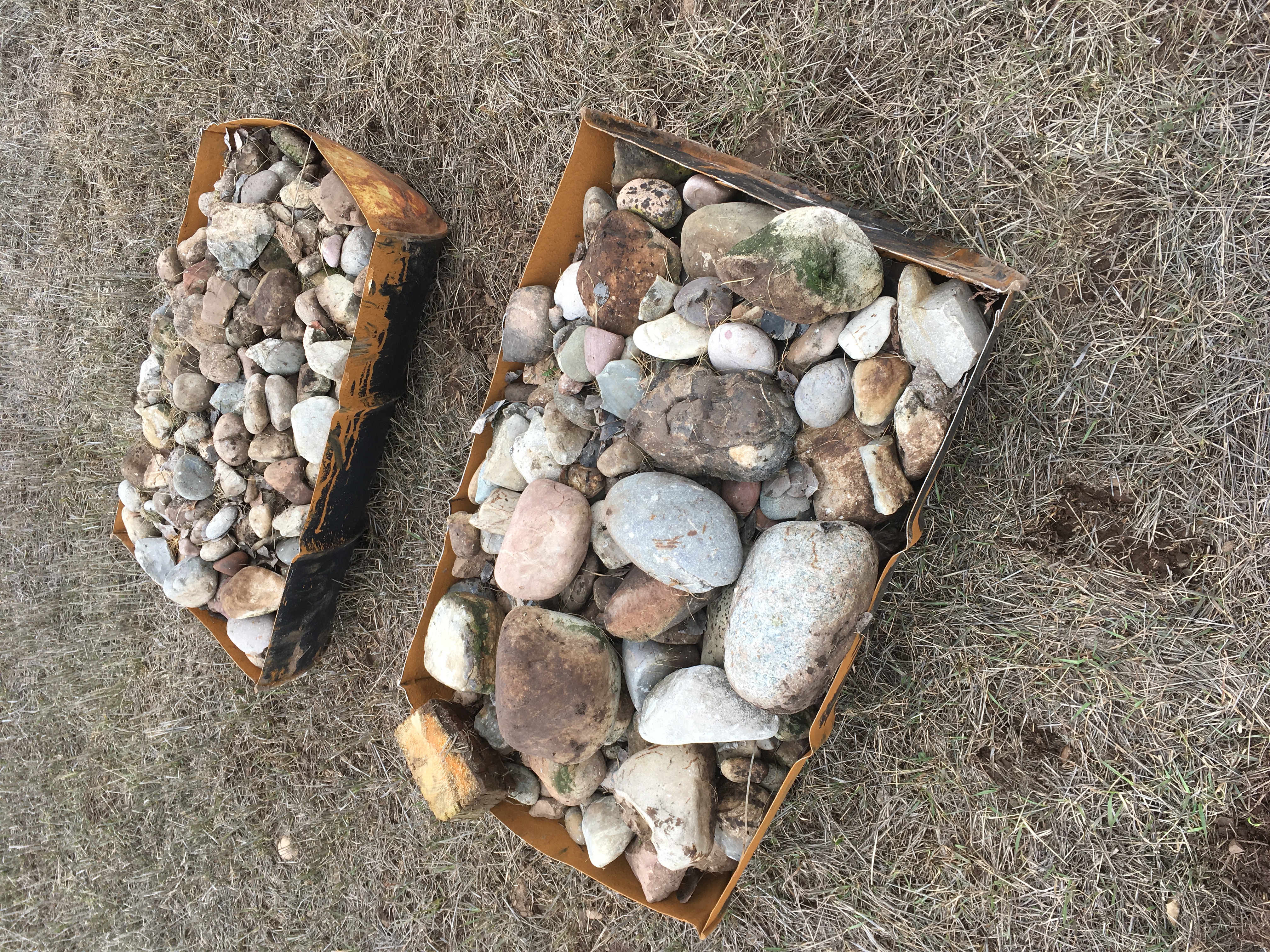

One of the uses for my forks is to move rocks, small rocks. We have a lot of rocks on the property. I got tired of handling them several times until they were hauled off so I cut some barrels long ways so we can put the rocks in the barrels. It works out good due to we only handle them by hand once.

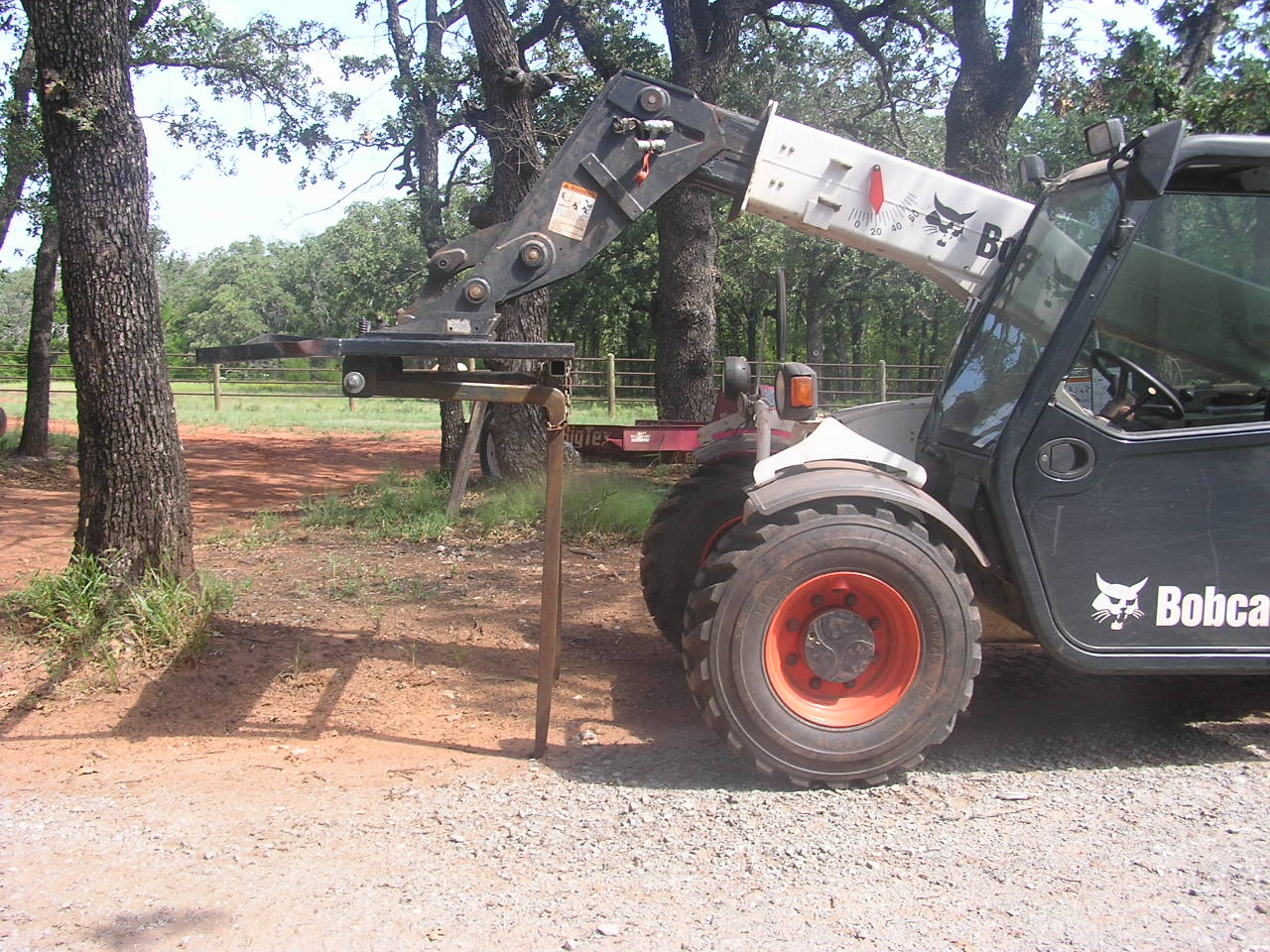

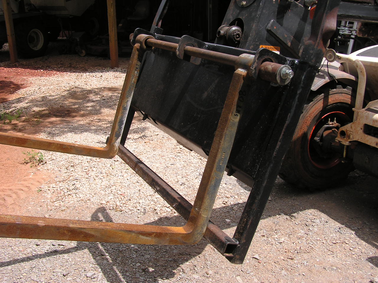

Here are a couple closer pics of my DIY forks,,
the forks hang on a 1 1/2" solid steel bar, that bar is un-bendable,,I have even bent a fork, but, not that bar. :eek:
(Yes, I found a way to bend the fork back, without heat!!)

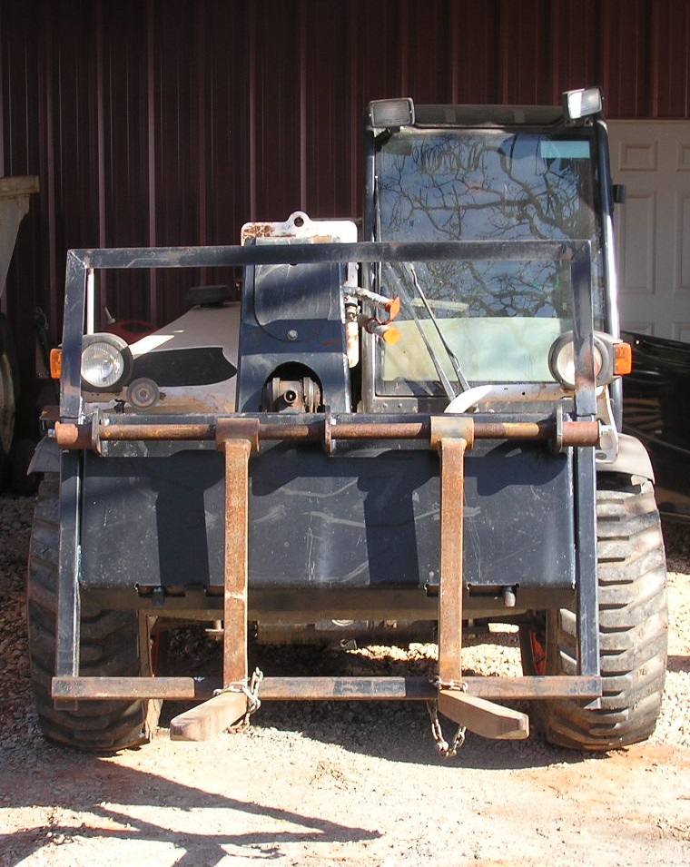

I converted the tractor to SSQA,, then I made a DIY adapter to hold the forks,
the forks pivot at the top on a 1 1/2" steel bar,
I bought the forks close to 20 years ago, from a farmer that had them laying in a field. They are 48" long forks,,
That type are sometimes called pin top forks: tractor pin top forks - Google Search
Here are my 48" pin top block forks:

How did you un-bend the fork?
   / What else do you do with forks besides lift pallets? #306
Not too much detail, because someone might get hurt and call it my idea, but, it involved a VERY heavy chain, and two 20 ton hydraulic jacks,,,
A 20 ton jack pressing on the the center of a hypotenuse of a triangle will create CRAZY high forces,,

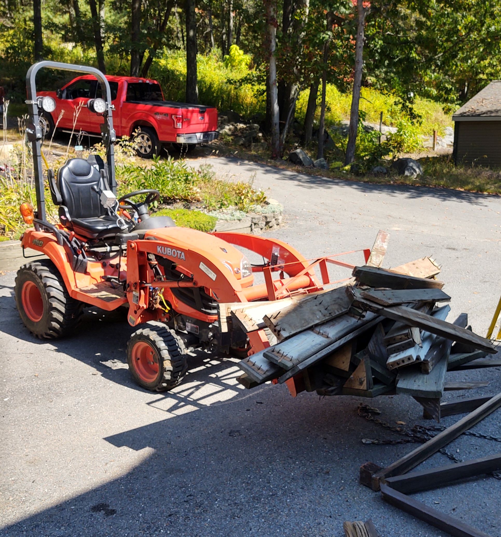

Removed and hauled away the old stairs on my shop.

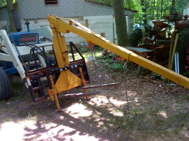

Normal stuff, sometimes stupid stuff like lifting room in truss rafters on garage. F4000, loaded tires and blade for extra ballast.
