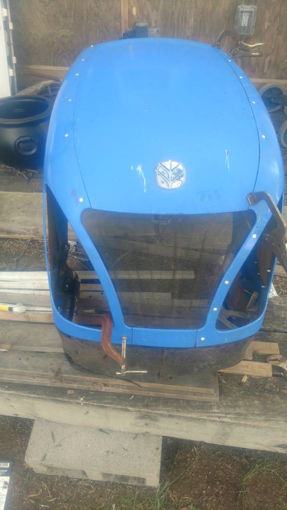

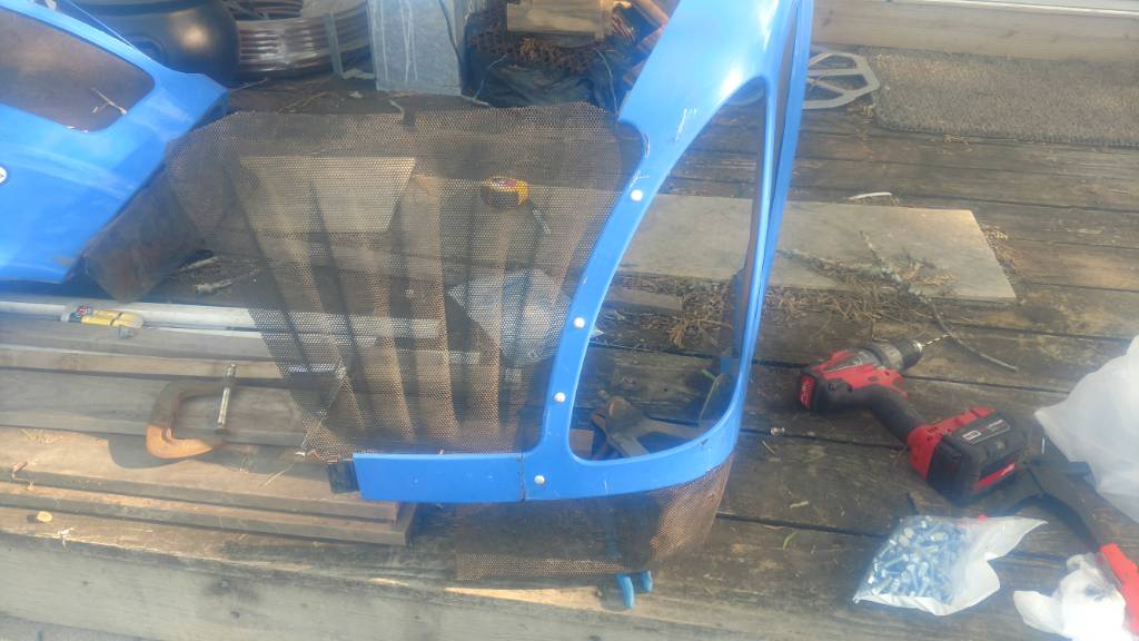

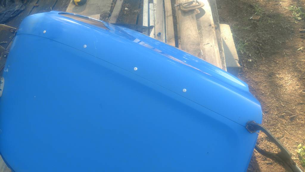

Today's progress. The JB Weld seems to bond well, it's an epoxy. We'll see how it holds up, the rivets will help, I think. Belt and suspenders.View attachment 507166View attachment 507167View attachment 507168

It didn't hold up for long and I'm not sure what kind of plastic it is. Mine came apart again and now I've only got one side and the top on the tractor. It rarely gets used anymore and mostly by employees so I haven't messed with it again, I use the skid steer most of the time now.
Good luck, I hope.ypir solution works out better than mine did.
