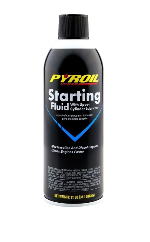

If ya know ya know

Make sure you video this method if you use it and then post it here!
Yeah I think we need to steer clear of using explosives to seat a bead if you are a beginner.
