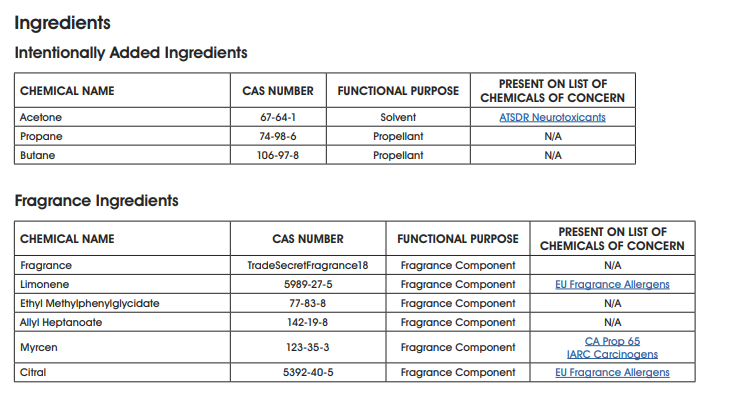

bugs spray, hair spray, ether, and some air freshener works very well
   / What happened here to my tire? #47
   / What happened here to my tire? #48
Some may be, many are not
this one is inanely flammable
   / What happened here to my tire? #50
Yikes! Now, that's a hazard I'd never considered when lighting a match in a restroom!
yes... you don't want want to light up a match while spraying this stuff... I mean unless you do intend to light the place up... check the ingredient lol
