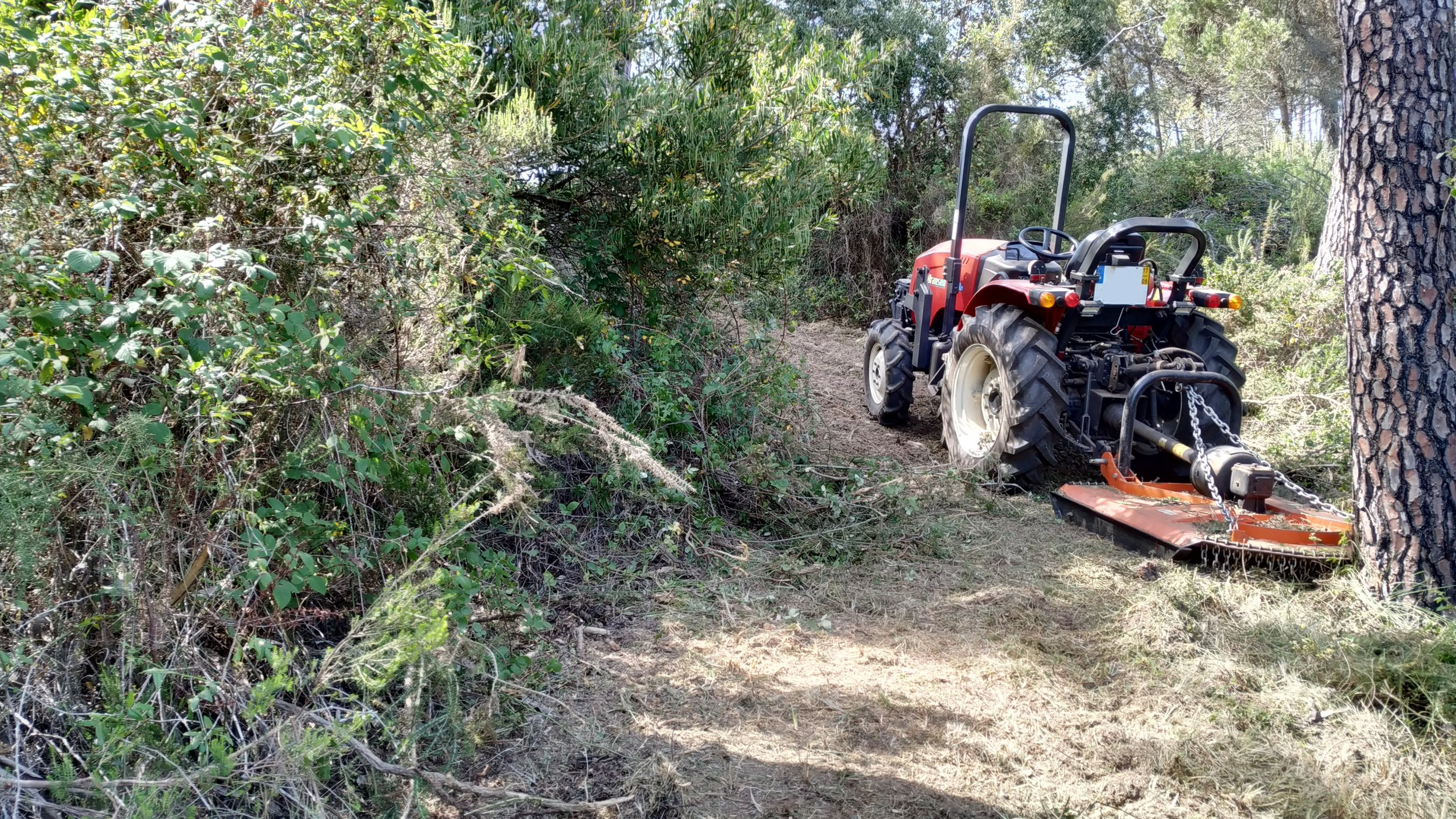

Today I was mowing another place we inherited recently that is severally overgrown since, well, since the almost the entire mountain burned on a massive fire in 2005. This place is a 20 to 25 degree slope, so very tricky to work on, specially when there hidden holes from the stumps that burned on that fire, along with fallen rotten trees from previous storms. Extreme care and attention is required to mow it.

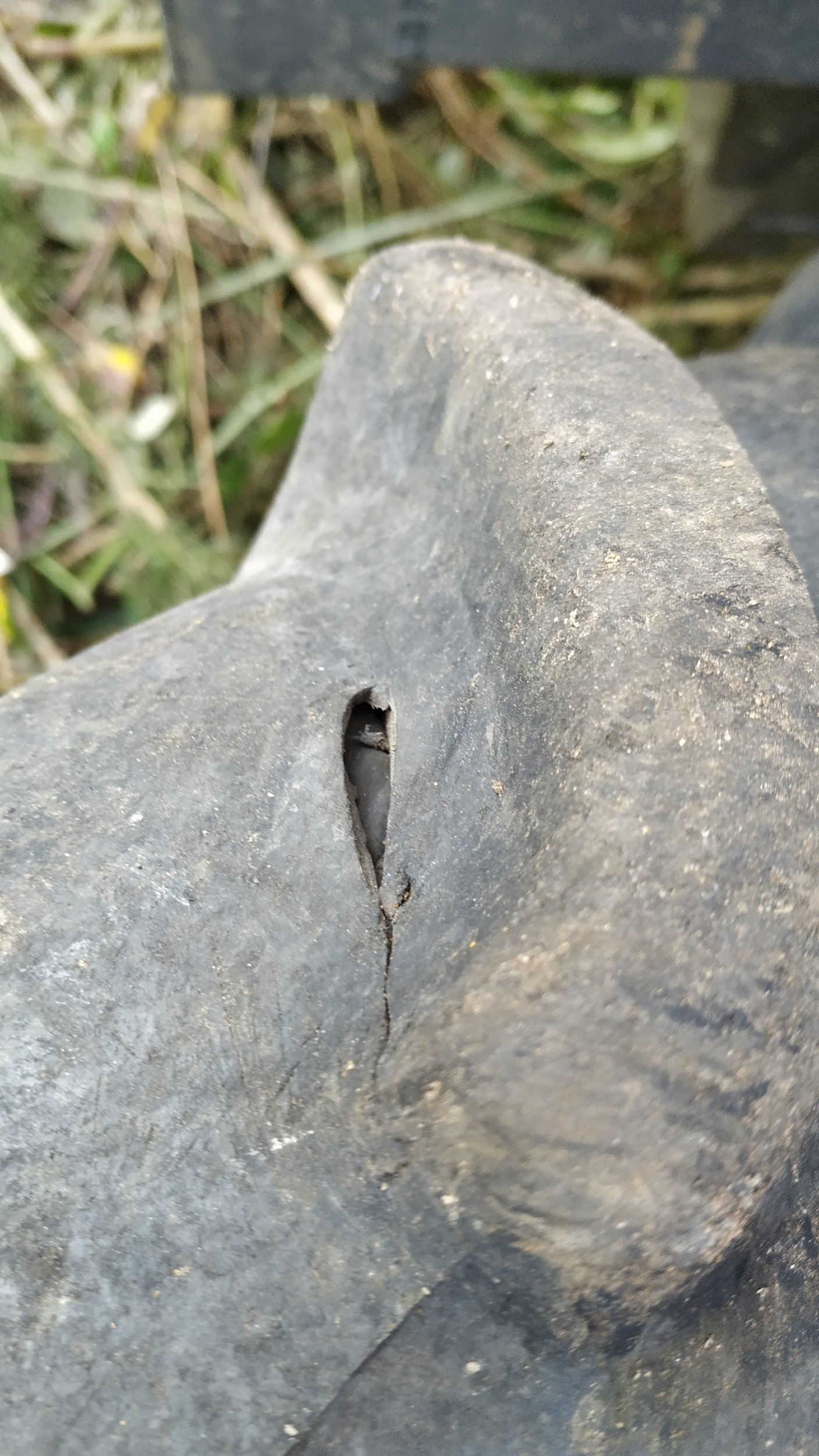

Anyway, the place is somewhat dislocated from the village but has a paved road to it which only means one thing. That people will go there to dump all kinds of trash. Turns out I found a piece of broken glass that cut right through the front tire but somehow didn't reach the tube.
Now, do you guys know if this can be fixed somehow, or should I start looking for either a new tire or an used one? The cut it about 1 1/2" long.

McMaster-Carr Not sure if you can get this over there but we have repaired some rubber conveyor belts with a very similar product . The worst part is the cure time for total strength. Just clean the hole very well with MEK , Methyl ethyl Ketone, most paint stores should have some . Frame the cut with duct tape to the mixture can't run out and when dry shape with grinder and flapper disk .
Thanks for the tip and suggestion on that urethane stuff. We could definitely use something like McMaster Carr, not because we don't have the products but mostly for the convenience of ordering online and most likely better prices.
For now, the tire has been fixed and has been holding good but I'll save this idea for the next time. I'm sure it's just a matter of time till it happens again.
Looks like 3M as a similar product to that, that I should be able to get. Otherwise, I'm sure Wurth has something like that too. https://www.3m.com/3M/en_US/p/dc/v000088310/
The 3M product should work just fine .

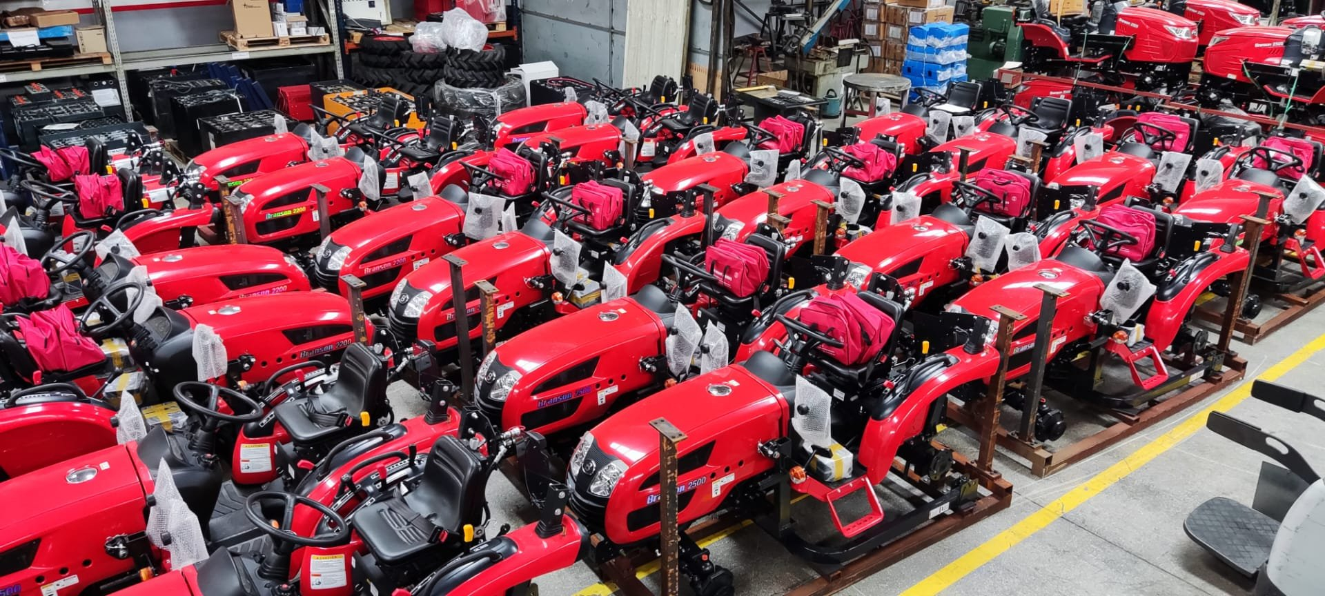

Speaking on tractor availability, looks like te Portuguese importer just stocked up on some 2505, 2200, 2500 and 2500L models.
