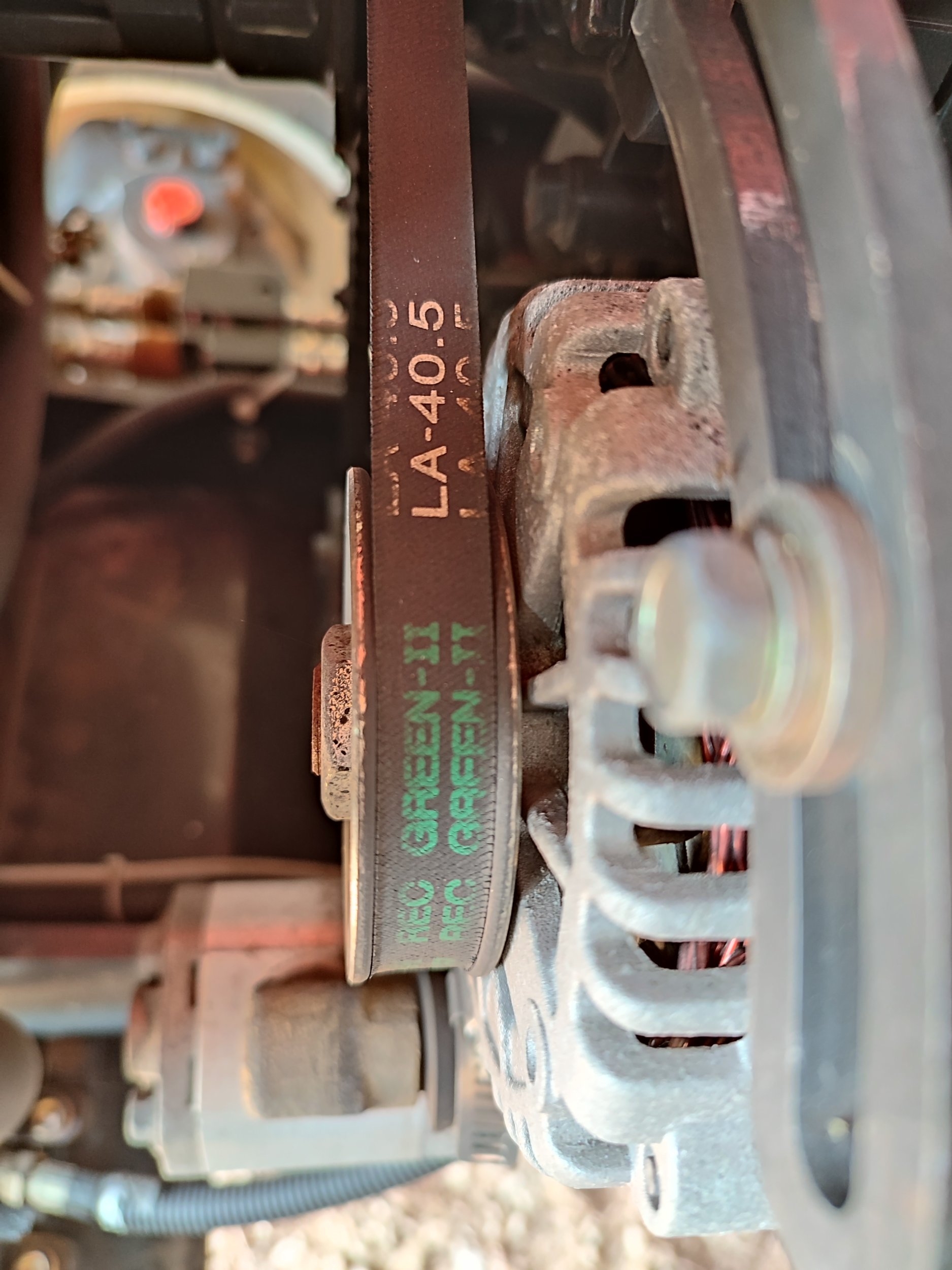

Pulled my engine belts (2) off today after work (both alternator and a/c belts are shot).
Hopefully the Napa in town can size up a replacement pair tomorrow (nearest dealer is 4 hrs away).
I'm thinking they can, these are just V-belts after all.

Let us know how it goes. I had to settle for a little wider belt than original but it has been working fine. Around here they don’t have belt gauges to measure anymore. The just use a tape measure so it took a couple of trips to get one that would work.

My 3520h took a Napa XL 25 9415 for the alternator (I had to cut the original off when a hen decided to nest up there and got stuck... hen survived, minus a couple toes). Still on the napa for the last four years, ~600 hours.

The original one is an A40.5 belt. The one for the AC, I can't help. Those are for the plebs with cabs. 🤣

I remember not being able to get an exact match locally when I needed it so I'm not surprised it's a different size. I recall some difficulty getting the napa belt on the pulleys (and getting the alternator to move was a pain if I recall), but it works ;)

The saga continues...
The first set of belts I came home with were much too short. This was after questioning why the girl at the counter was using a metal tape measure instead of the belt measuring tool. Their reply was that the metal tape measure was "much better than the tool".
Ok.
Got home with the set and nope. Not even close to fitting.
Returned that set and all the while the girl was returning the set, she was explaining to me how they were the "right" size. I said it must be a defective tape measure. I told her all I could say was I had both tensioners for both belts slackened up as far as they would go and the belt would not go on the pulley. So despite her protestations, she brought me a larger pair of belts. When I asked how much larger, she said one was "7/8's larger" and the other one was "3/4 larger".
Brought home set #2...
The belt for the fan + alternator fits and tightens up. Looks like it will be fine. The one for the a/c, nope. Still too short.
Will have to return it tomorrow after work, as it was too late to go back again this evening.
   / What have you done to your Branson today? #1,689
Trip #3 was a success.
New a/c belt is on and tight.
Tractor back in service.
Ning,
My alternator + fan belt is the exact same one you used. Napa XL 25 9415.
The a/c compressor belt is a Napa XL 25 9570.
In case anyone else needs to match one up and doesn't want the chickee poo at the counter to use a tape measure.
