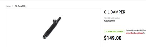

finally got around to replacing the pedal shock absorber on GC2400
with spring set at same tension my pedals NOW return when pressure removed. didn't mess with in mud today but suspect I can reduce spring tension a bit to save my bad knees and it will still work. old unit was hard to move.
they don't make it easy to access stuff like cotter pins on these. oh well took 45 minutes in the mud to replace.
LOT better. lot safer too.
I did replace a worn bearing last summer that supports the directional shaft into transaxle, bearing is on frame side under cruise control linkage. that was PITA to do but had to, bearing was only half there.
next week (weather permitting) the mower lift shaft gets replaced as after 12+ years rt side sits 1/2" lower than left
