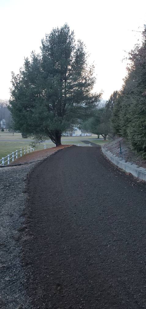

I started out with a pine straw rake. I just recently got it from EA. the area under the pine tree was loaded with needles, and while raking them up, I notice it catching some stone and bringing it up. so then I started making passes back and forth the length if the driveway, basically leaving it how you seen it in after picture. I did make a couple if passes at the end with a blade, reversed, just to smooth everything out a bit. in all, probably 30-45 min.

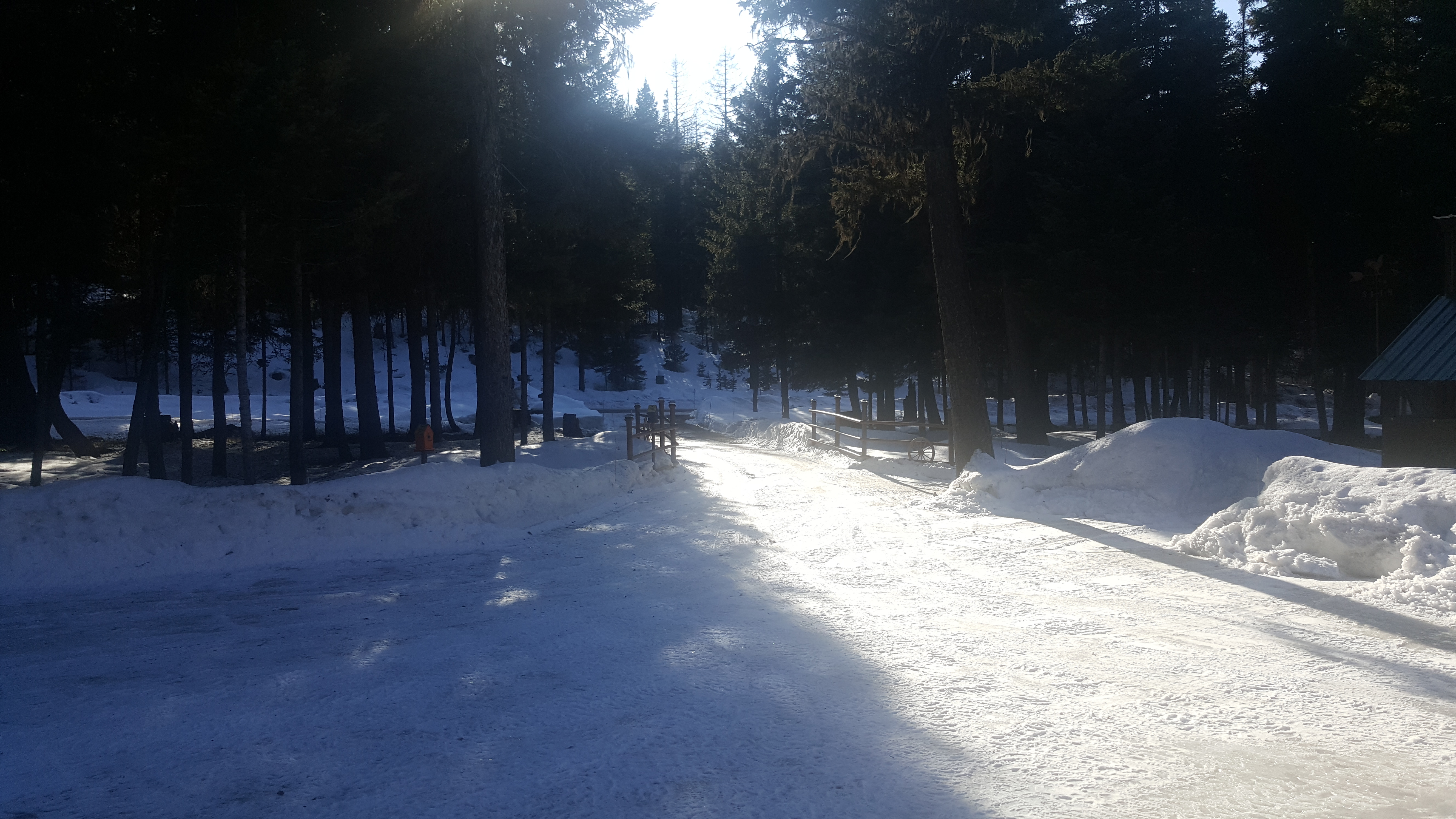

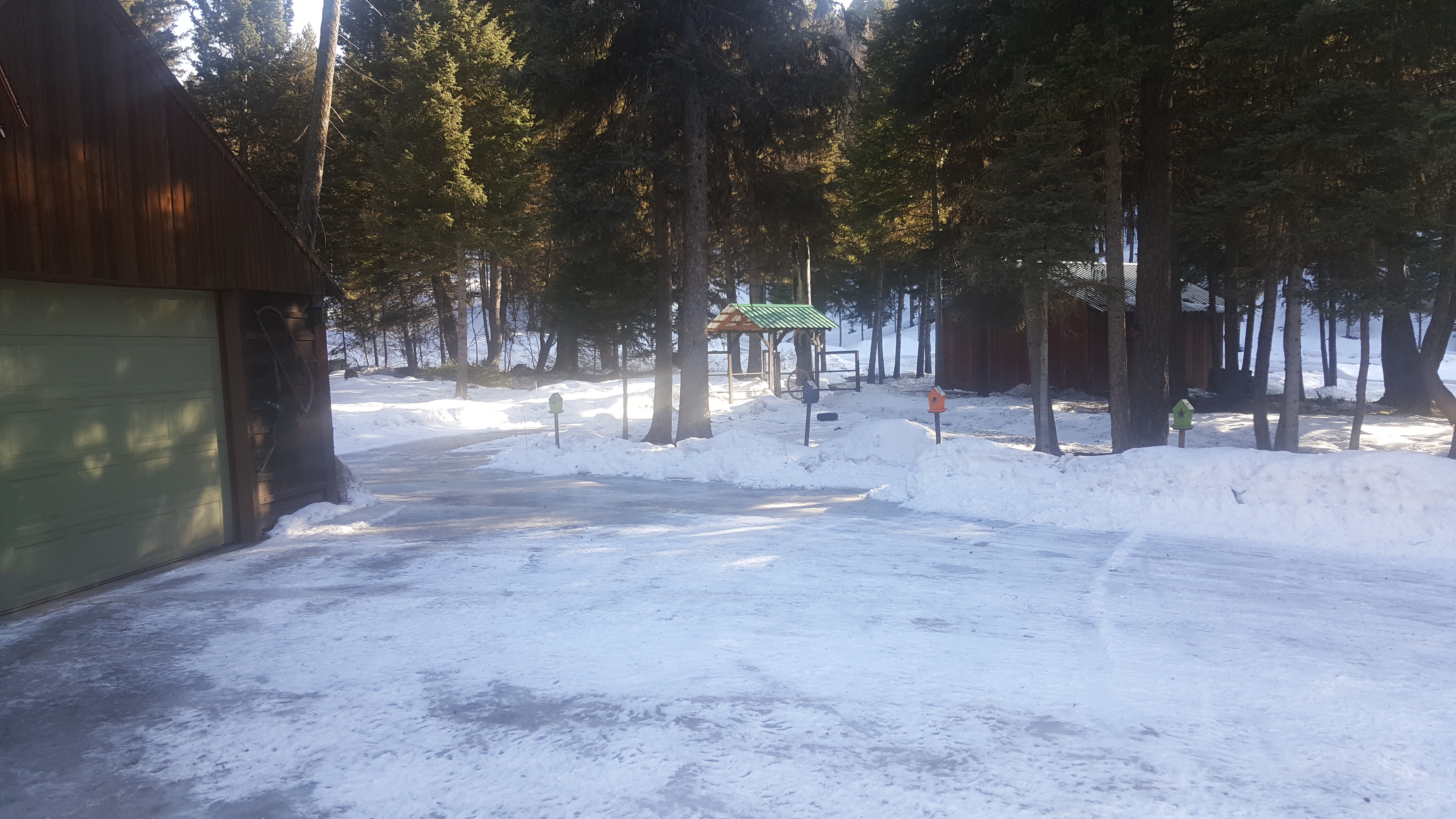

On a sunny note, I took a couple of pictures late yesterday afternoon, just about 4 hours from the "start of Spring 2020", and still waiting for the ice off from our driveway.
I might use the tractor tomorrow with the rear studded tire chains to scarf up the ice again...

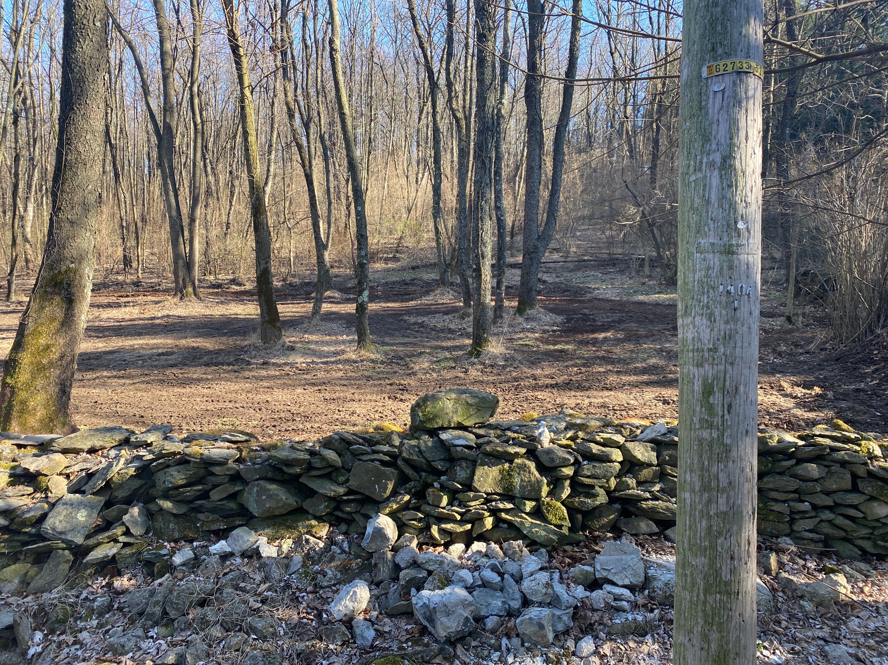

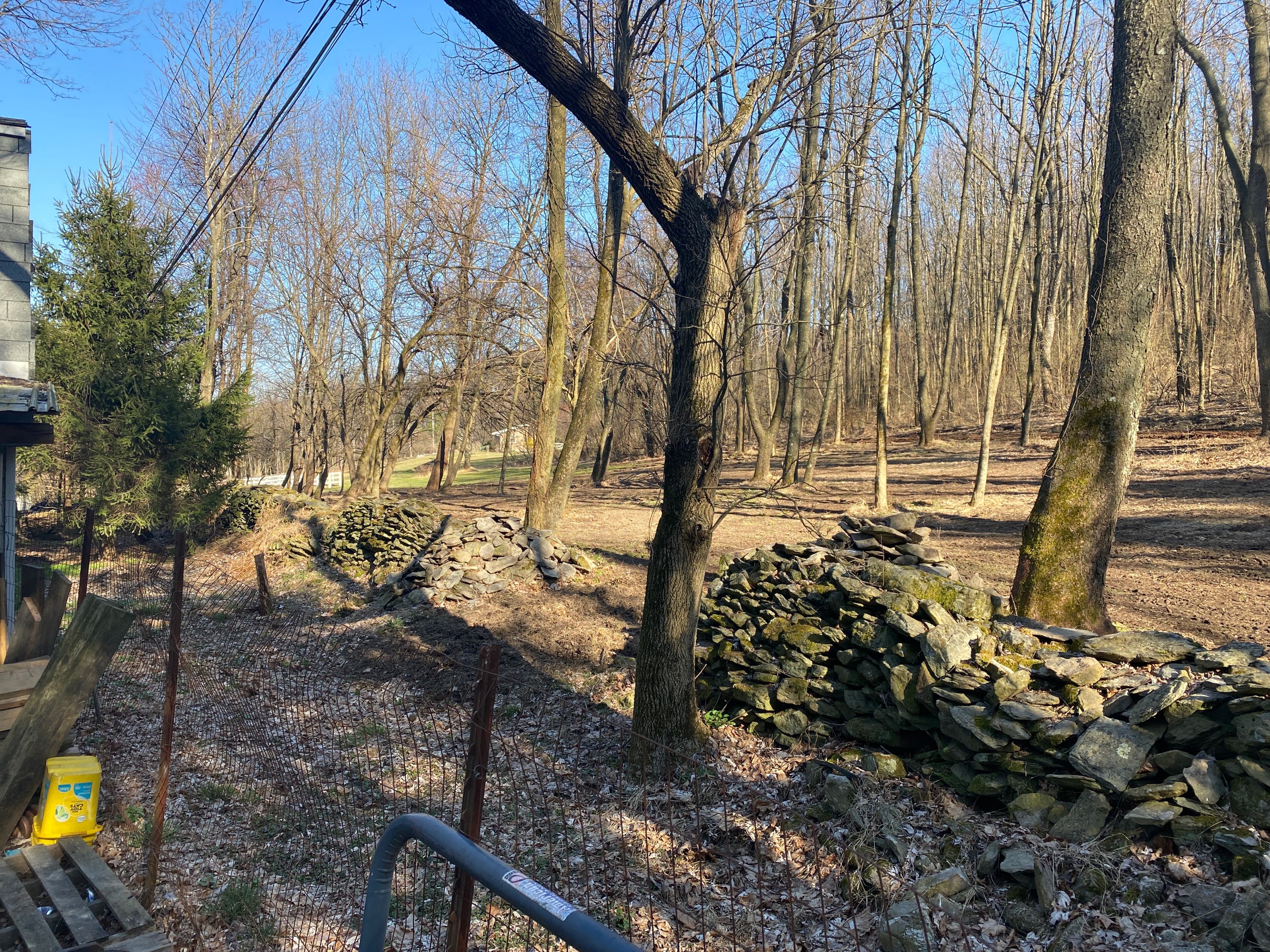

At home, finished up clearing some woodland that will be more room for the lawn ornaments, errr, uhm horses.

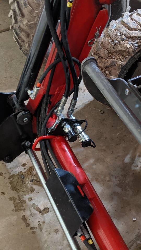

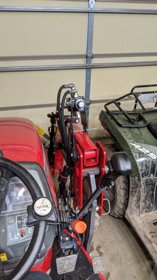

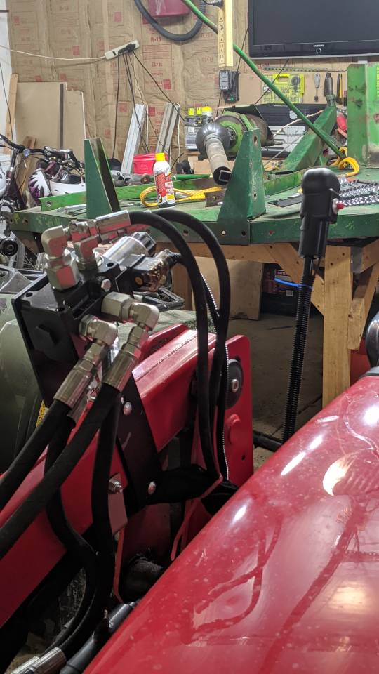

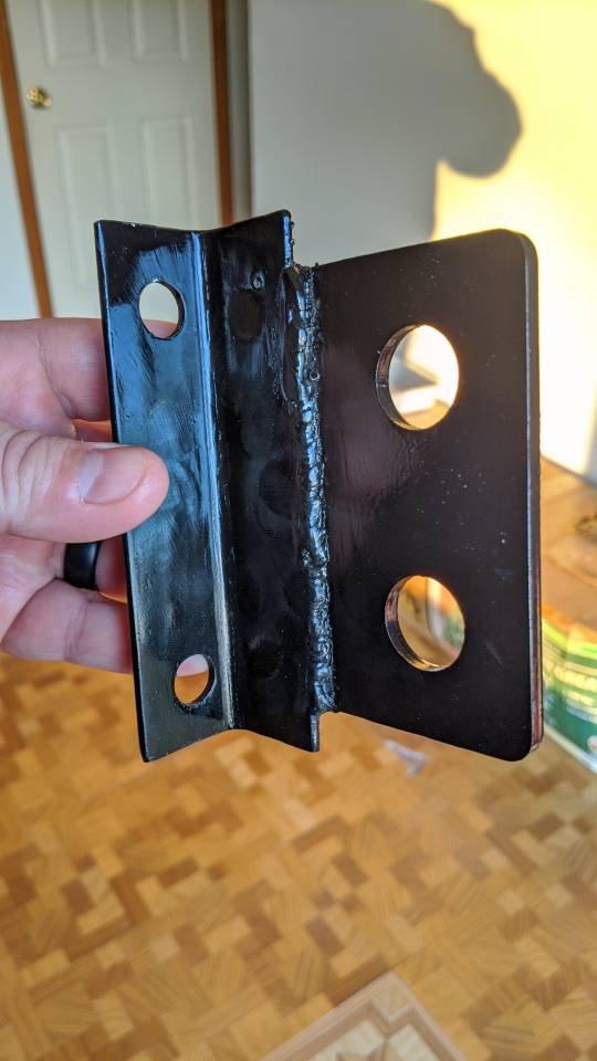

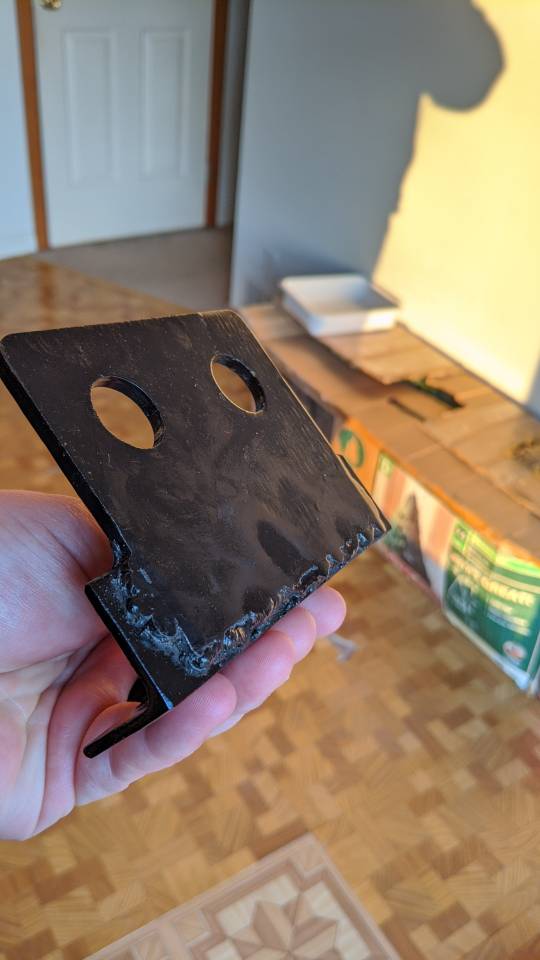

I installed a WR Long Diverter Valve on my GC1710TLB. They shipped it with a flat black plate so I had cut it down a bit, weld on a piece of L channel steel and, repaint it black. I bought a U bolt and installed it on the cross member of the loader. The handle on the joystick feels comfortable and ergonomic in my hand. I don't love all the 'noise' over the loader arm but it'll do for now.IMG_20200325_191203.jpgIMG_20200325_191211.jpgIMG_20200325_193722.jpgIMG_20200325_193728.jpgIMG_20200325_193742.jpgIMG_20200325_193803.jpg

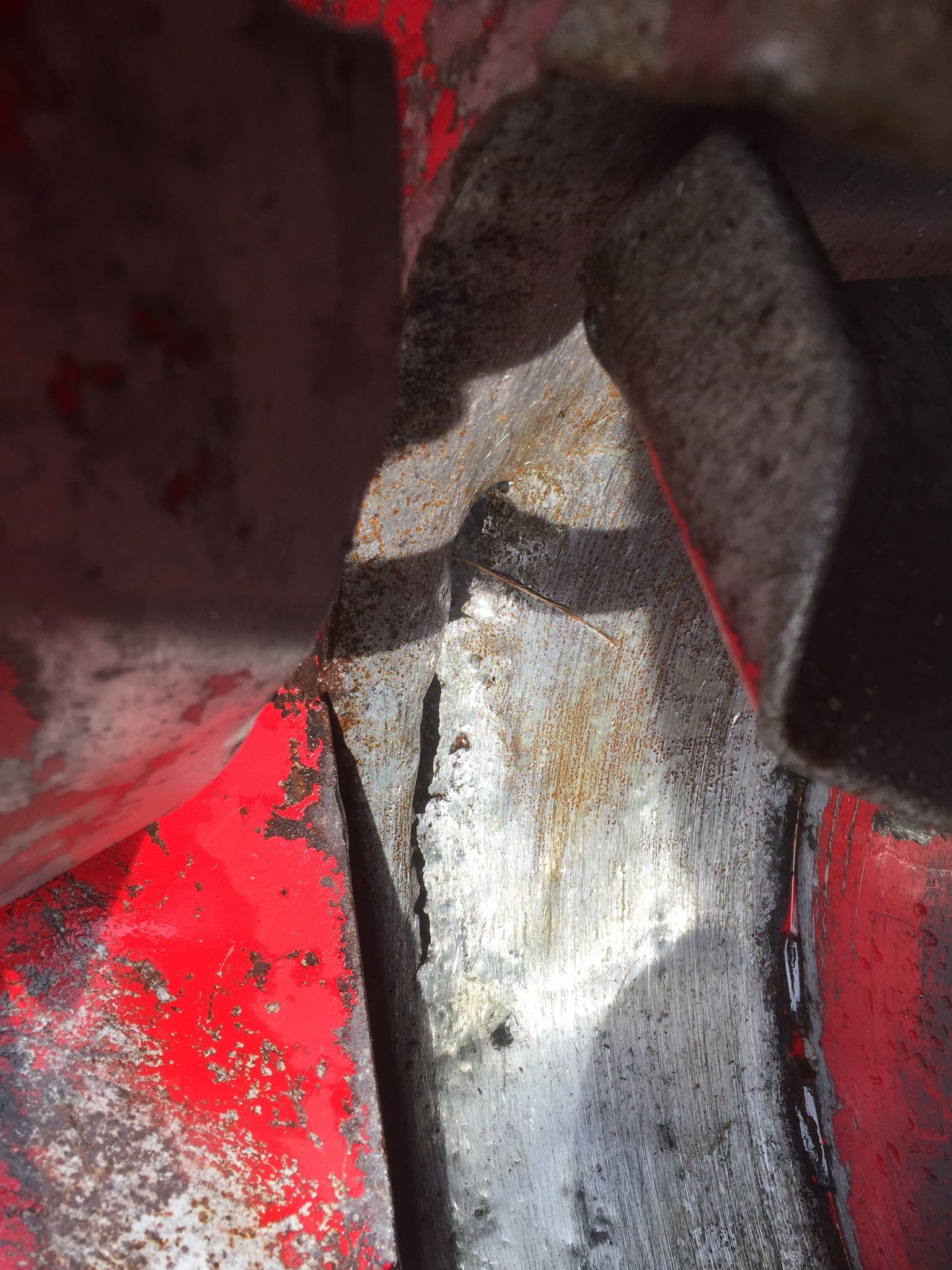

When pressure washing my winter gear for hopefully the last storm and I find a gash in the blower drum. Maybe I'll need to start a new thread but I'm glad I find this at the end of the season and not at the beginning. Yes, I work my scut hard.
