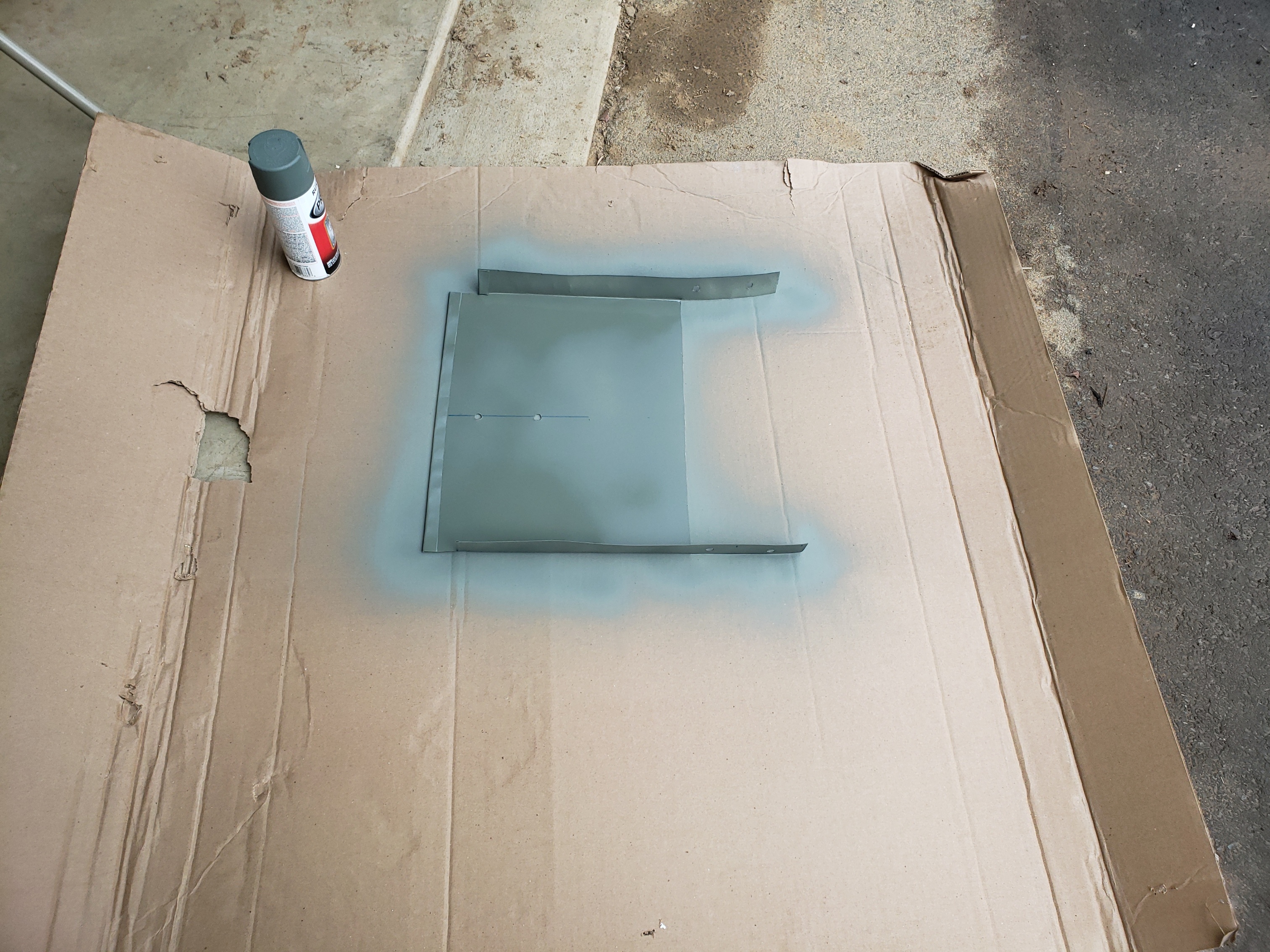

Built a skid plate and primed it from this person (really like his videos).#89 Do You Need A Skid Plate On Your Massey GC 1700 Sub Compact Tractor - YouTube
Tomorrow it's paint time and then on to the SCUT.

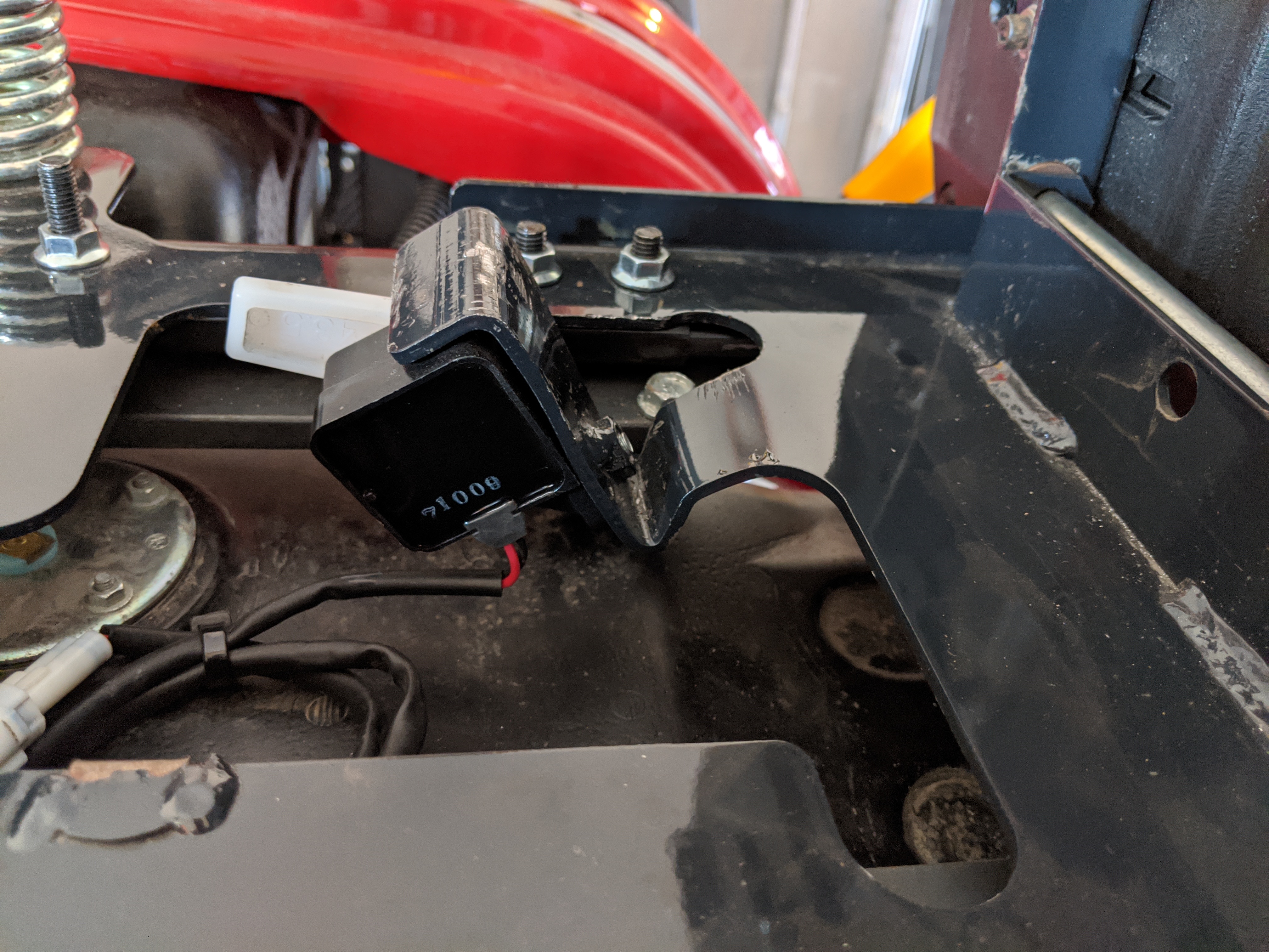

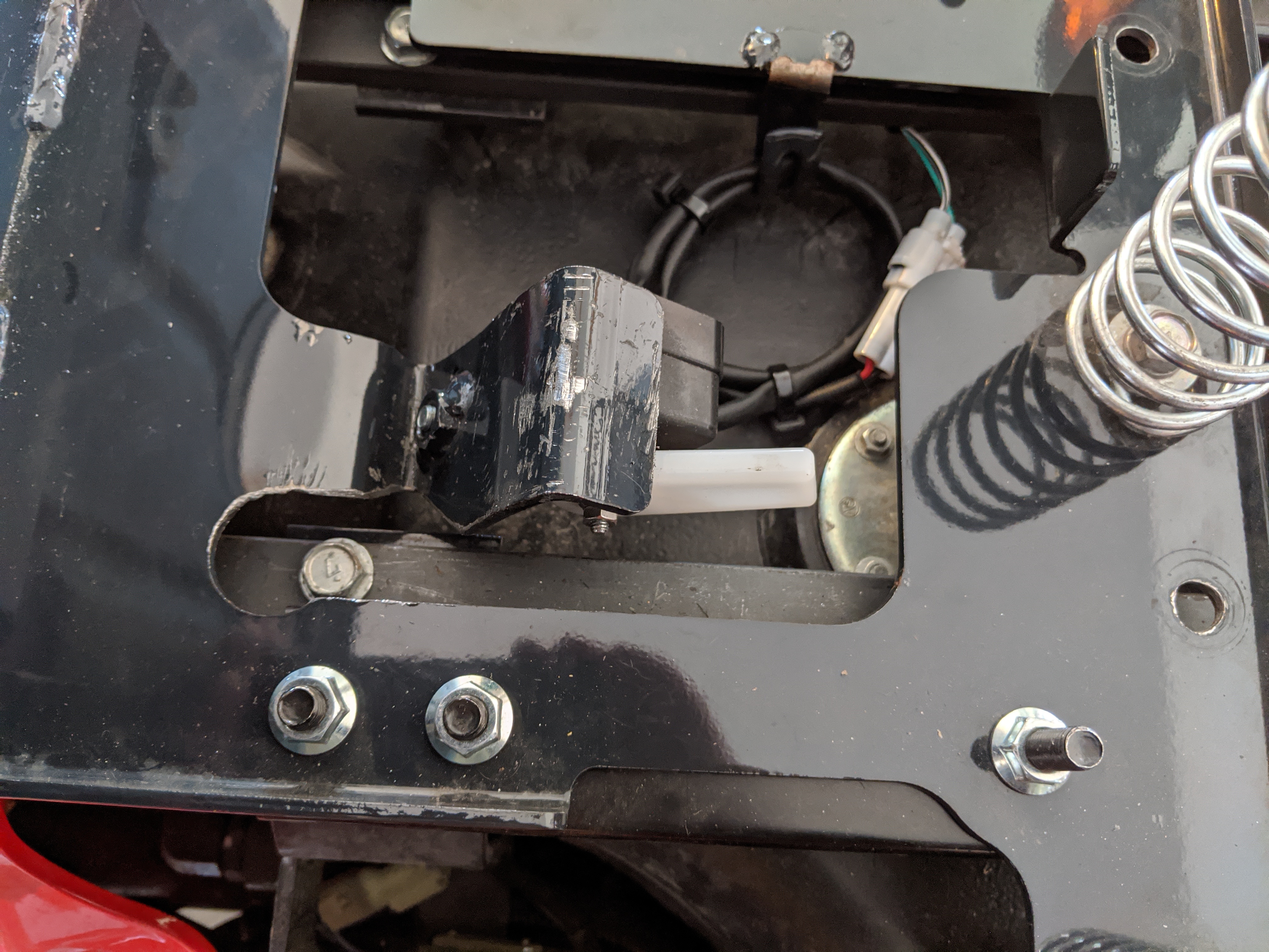

I'm thinking I'm gonna mow with the massey this year, so I reinstalled the seat safety switch. It took some doing with the new seat. I had to bend the switch bracket this and that way to get the angle right, which also required me to bust out the angle grinder to cut off the corner edge off the bracket so that it would clear the what it needed to clear. After that, fine tuning...I want that switch working only when my butt is fully off the seat as opposed to when bouncing around with bumps.

Gene, what prompted you to reinstall the seat safety switch, which is a good thing.
   / What have you done with/to your GC Series 2300, 2400, 1700 Tractor TODAY #216
KC, I'm thinking to use it's mmm this year, want that pto to shut off just in case I take a spill.

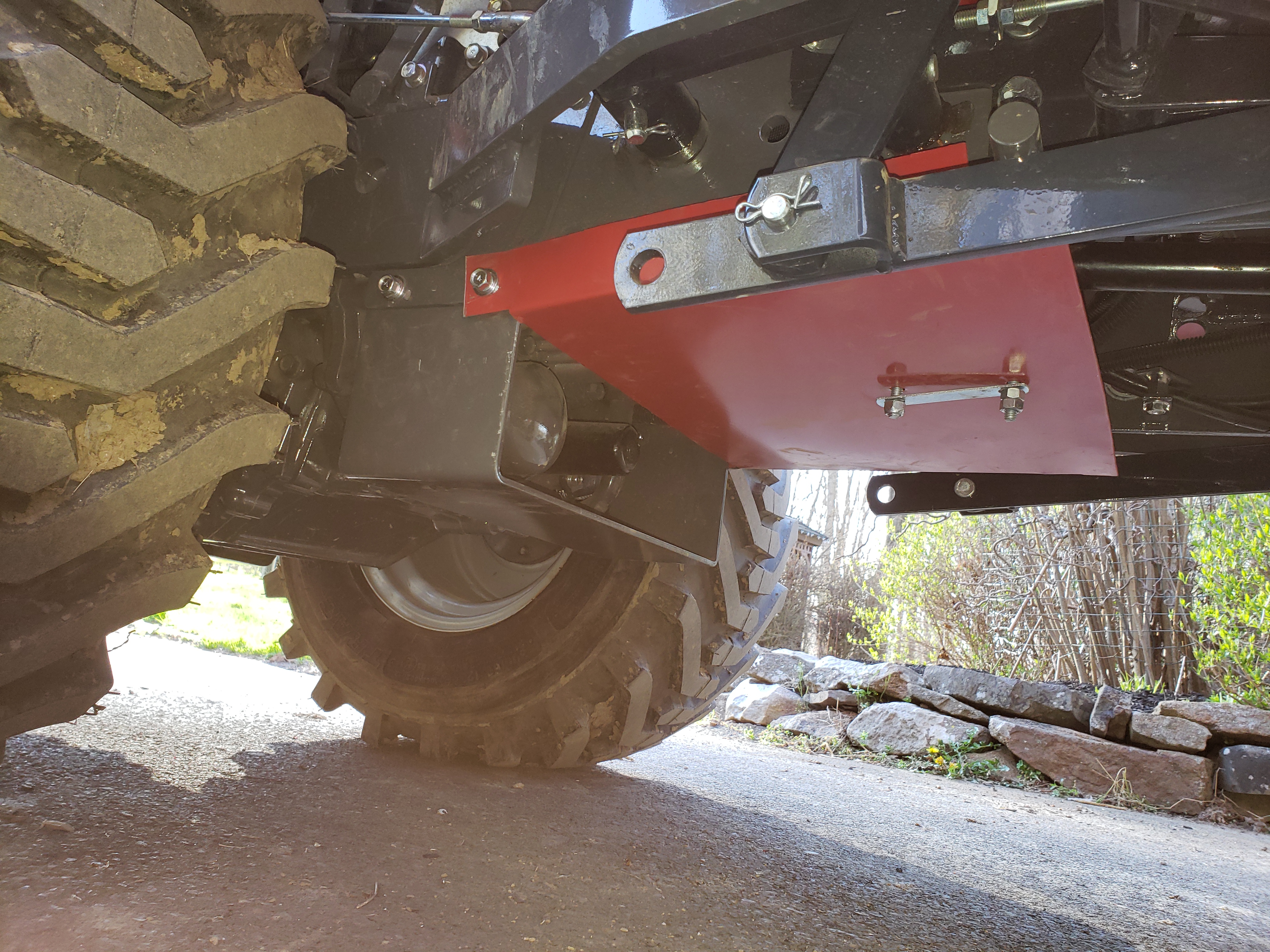

gcskid20200402_172039.jpgFinally got the skid plate on-shout out to Louisiana Tractor works for the idea.
Of course it's raining now.....Will need to wait to do the clearing.

Don't forget to protect that hydraulic filter, that will kill your tractor faster than a broken hydraulic fan...
